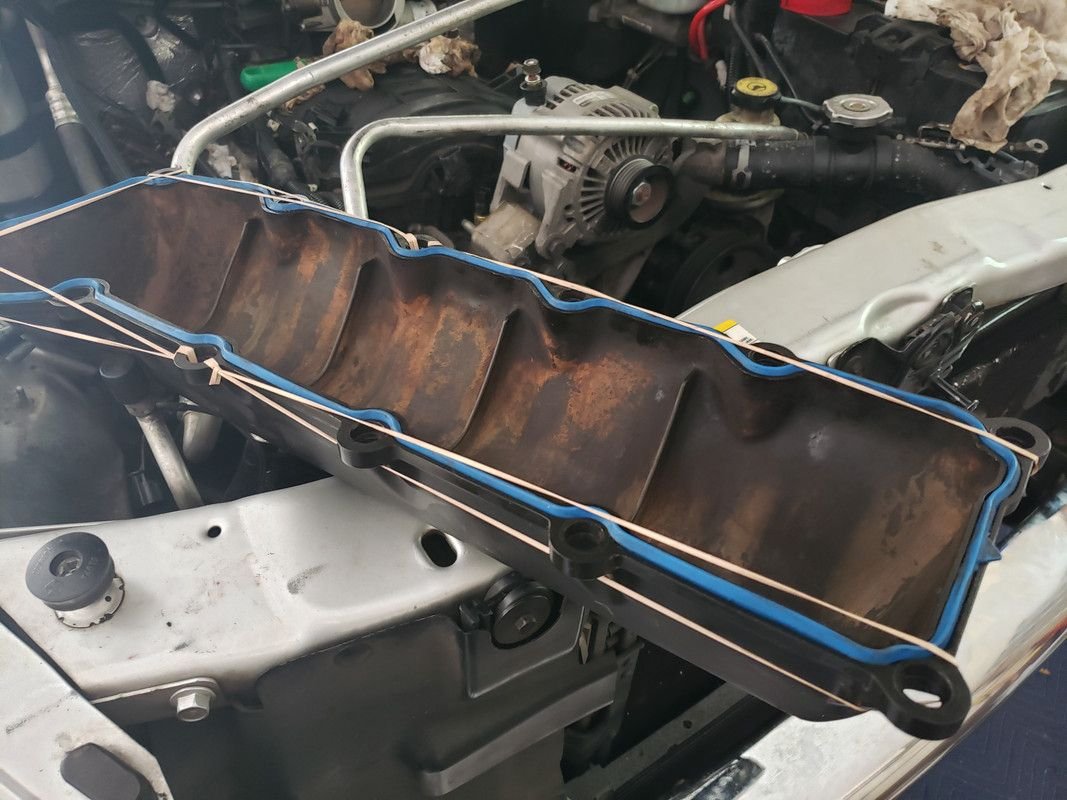

Now at 335K mi and not adding any oil in between my 7,500 mi oil changes. Truck is driven daily in heavy ATL traffic. Still using the original timing chains. Haven't touched the tranny aside from fluid and filter changes.
I replaced lifters, springs, valve stem seals and valve cover gaskets a few years ago. The latter two cured my oil losses, which were not bad to begin with. Also cured the occasional puff of white smoke I was getting when accelerating from a stop or starting while engine was hot.
Rubber bands kept the gaskets in place without having to add anything tacky when installing.
