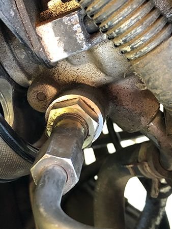

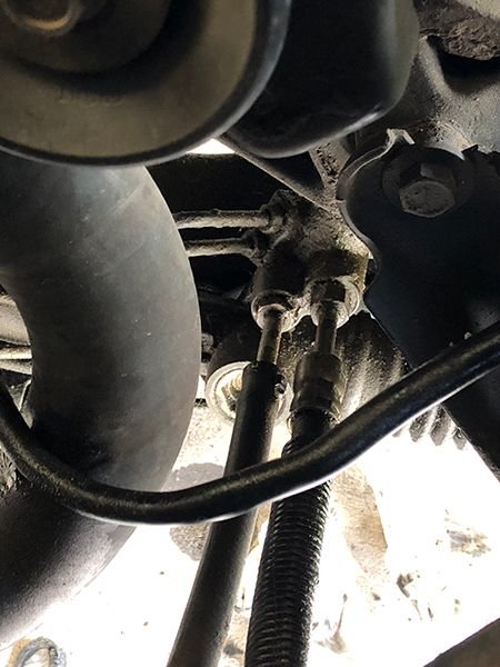

Time to put on the new power steering hoses and I'm totally lost.
1). The high pressure hose has a sensor at the top. There is a hole on the upper end of the hose that I guess the sensor screws into
2). The return hose at the lower end - how the heck do I get the wrench in there to take that hose off?
I ordered the hoses through RockAuto and the part numbers matched.
I feel defeated before I even get one hose loose.

Old Jul 6, 2019 | 04:24 PM
Posts: 87,479
Yep, sensor just screws in. Shouldn't be too difficult.
Crow foot line wrench, probably a universal joint, and an extension or three. They do make those fun to get to.
Old Jul 6, 2019 | 04:37 PM
rickself's Avatar
rickself
Posts: 265
From: El Reno, Oklahoma
I can get the wrench on the lower pressure hose fitting but won't budge. It scares me to smack the wrench with a rubber mallet.
Also, top of the pressure hose where it goes into the pump - do I have to loosen the copper nut also?
Old Jul 6, 2019 | 04:40 PM
Posts: 87,479
Hit the reluctant one with some chems, and then smack the wrench with hammer. Worst case, since you are replacing it anyway, cut the line, and put a six point socket on the nut. Works great. (for removing.....)
It *looks* like the line should unthread at the outer nut there???
Old Jul 6, 2019 | 04:46 PM
rickself's Avatar
rickself
Posts: 265
I thought about just cutting the hose! Probably both. I have both replacements.
I put the pump in last year and brain cells have already forgot if the copper/brass nut was part of the pump body - it must be because it's not on the new hose.
As far as the other tools, I'm going to have to do without - I'm just a old guy who likes to think he knows what he's doing!
Thanks for the direction!
