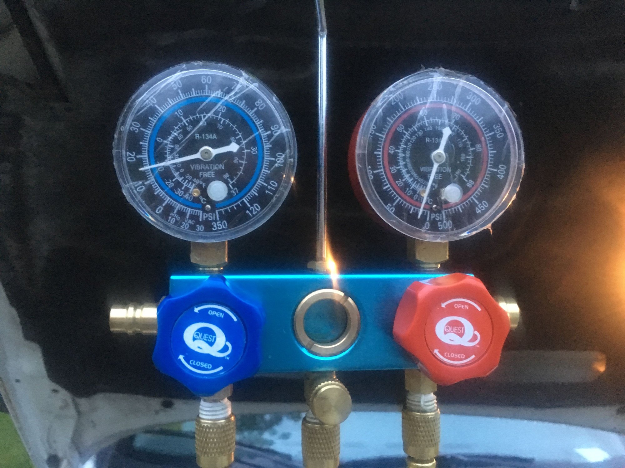

I have a Quest 429 Gauge Set (Now called AC Pro) which to my knowledge is r134a only, and I looked at it 3 times before removing my gauge set. Remember both high and low side read 0psi after my vacuum down. The clutch isn't engaging to draw in refrigerant so if my limited research is correct the high side is supposed to pressurize as the system is charged via lowside. Am I at least on the right track?
I think thats just the pressure from the r-134 you pumped in showing on the low side that should equal out in the system after a bit.
