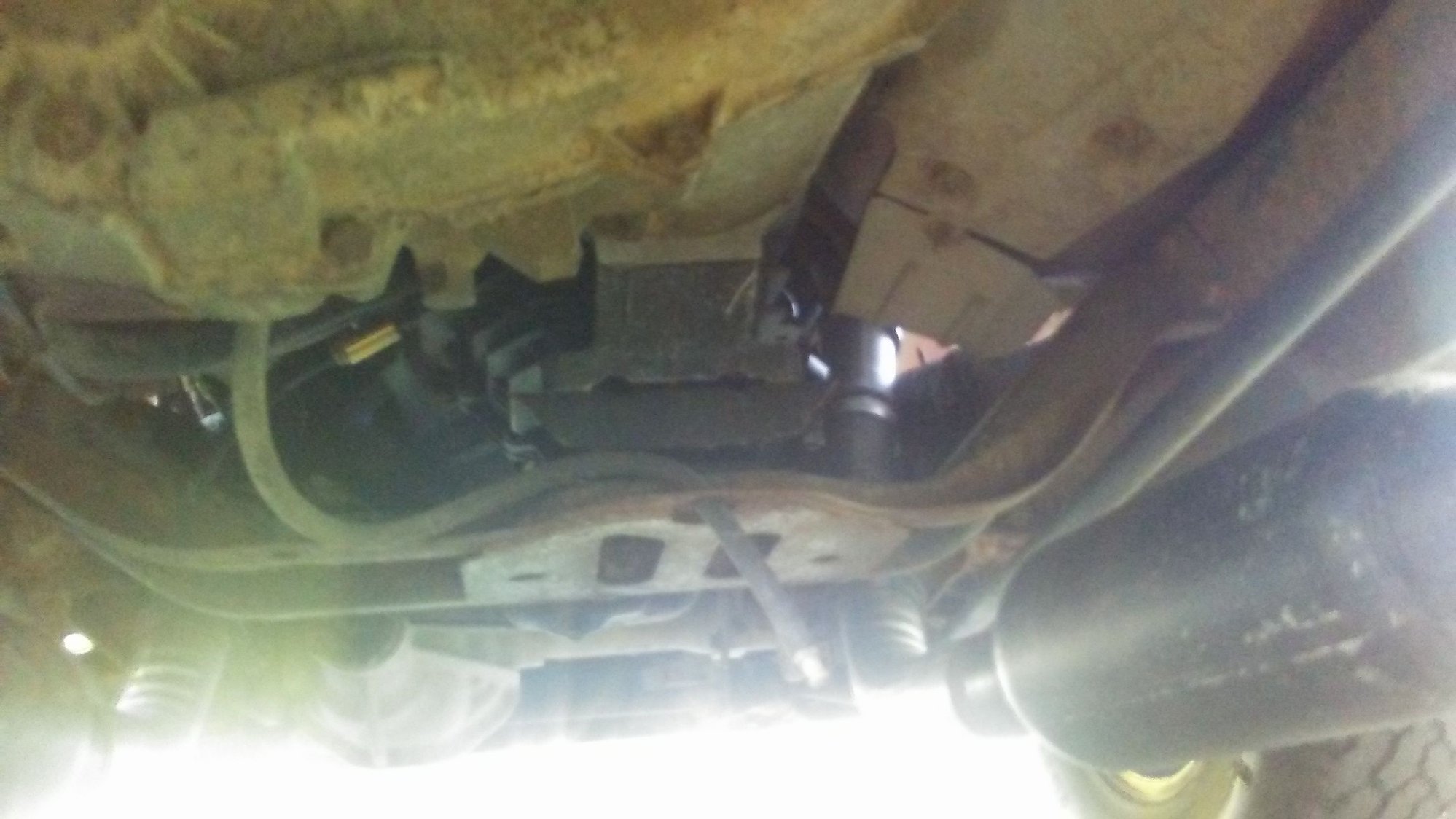

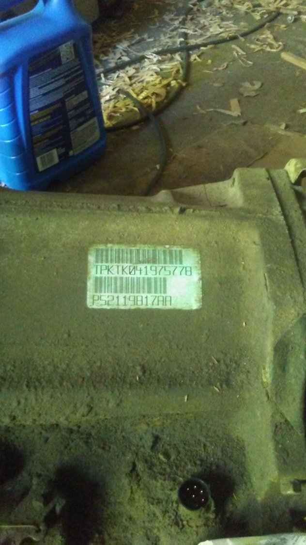

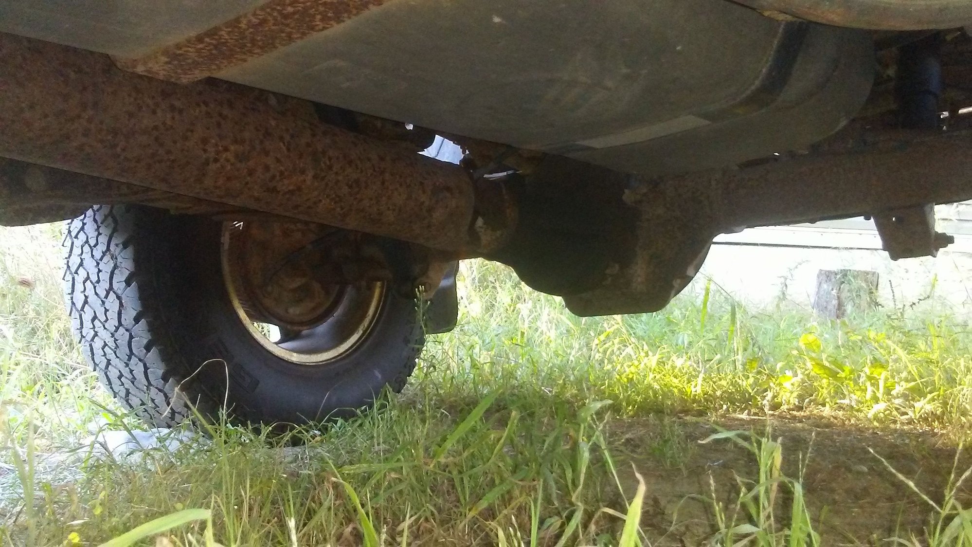

Give me a few min and I will go take pix and get info off old trans
Old Sep 6, 2018 | 05:29 PM
frankensteinbuilds's Avatar
frankensteinbuilds
Joined: Mar 2016
Posts: 28
Old Sep 6, 2018 | 06:32 PM
Posts: 87,483
Was it originally a 4x4, and you changed to a 2wd trans? wonder if the driveshaft is simply too long.
Also, lots of crud around the pinion seal on that rear diff..... or is that just the lighting?
