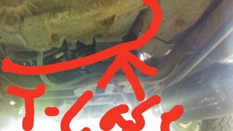

Was it originally a 4x4, and you changed to a 2wd trans? wonder if the driveshaft is simply too long.
Also, lots of crud around the pinion seal on that rear diff..... or is that just the lighting?
should be a 4x4 trans I ordered it as a 4x4 trans and bought a "manual trans drive shaft aswell " the pinion ya both battery was low and flash wasn't working and I'm sure their is a slow leak its got 280K on it

I'm not seein' the t-case?
Well, not like it doesn't have an excuse then.

Oh. Yeah. It was too close.....
Is that the correct rear mount there? Almost looks like there is two?

So in the pic from bottum to top is frame trans cross member mount and trans bottom (the mount is the mount orilys computer said was the right one ) ......also happens to be same as the auto mount.....minus the second mount
