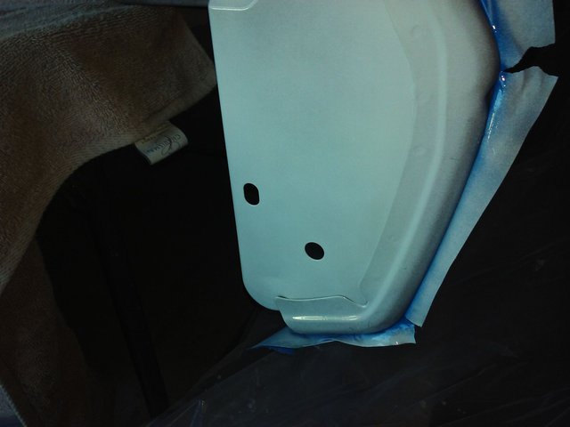

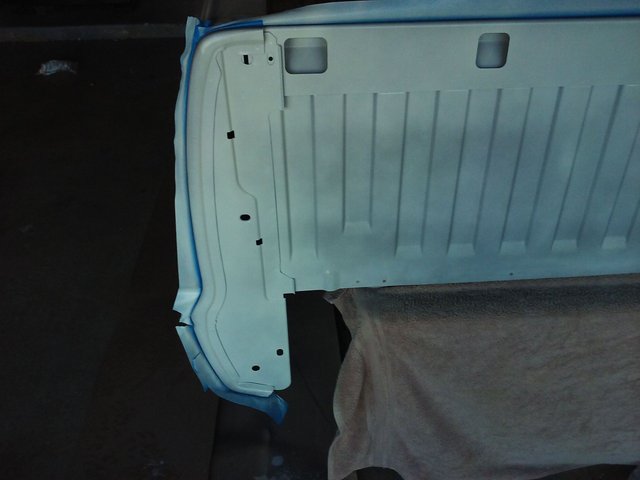

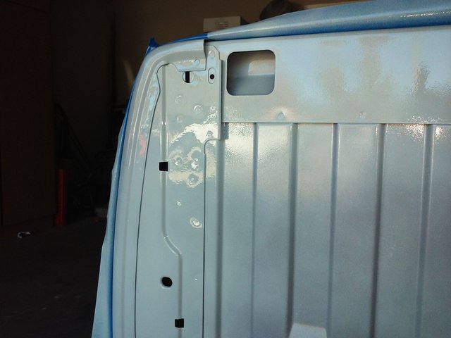

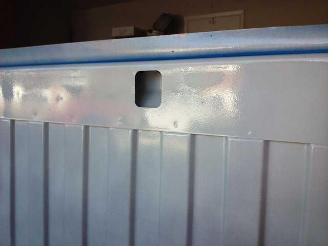

Last week I started prepping the new bed for paint, I picked up some Duplicolor perfect match rattle can paint and some Spraymax 2K clear to paint the front of the bed before installing it. I sanded it down with 600 grit, then went over it with a gray Scotch Brite pad. After that I did several wipe downs with a homemade mixture of 50-50 rubbing alcohol and acetone as a wax and grease remover. Then I taped around the edge with painter's tape. I rolled the edge up so that I wouldn't get any hard lines of paint that I would need to sand down later.
I shot 3 coats of the Duplicolor, focusing on the outside edges where you can actually see it. I didn't worry too much about getting full coverage in the middle area.
Then I waited for about 45 minutes and shot 3 coats of the clear over the top. It looked really orange peely at first but flowed out a bit as it cured.
I was entertaining the idea of just shooting the bed sides with these cans, it would cost me about $150 to do it this way, but I think I am going to invest in a larger compressor and spray the whole truck in a blue hued pearl white. For now, though, my focus was on getting the bed mounted...

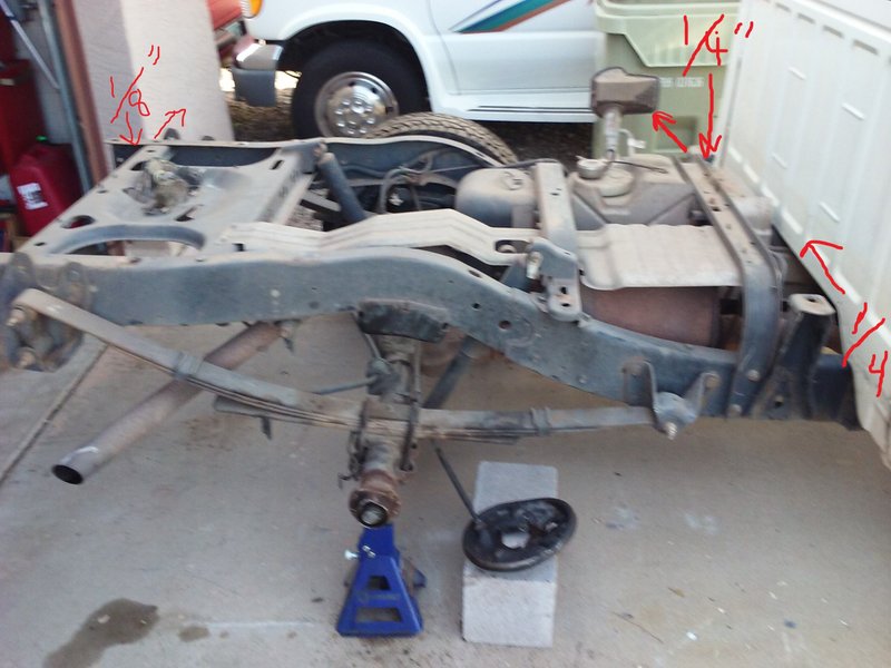

So after the paint dried, I was excited to get the bed bolted on and reassembled. We lifted it into place and I lined it up square with the cab and started installing bolts.
I could only get 6 bolts to thread in with the bed sitting squared up to the cab. The frame is bent. I had to pull the bed off and try to measure and see if it was out of square or just the mounts were bent.
So I got the bed back off, and started measuring. I measured from the cab to the end of the frame, corner to corner, width, and hole to hole. I marked a centerline up the middle and measured from those to the holes.. Every measurement came out square except from the center line to these holes:
The hole behind the passenger side cab is oversized, so even though it lines up and a bolt will fit, it is out of alignment.
