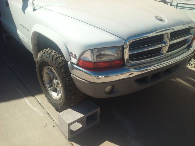

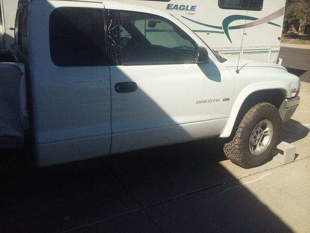

I originally thought that the bed had kissed the cab but it didn't

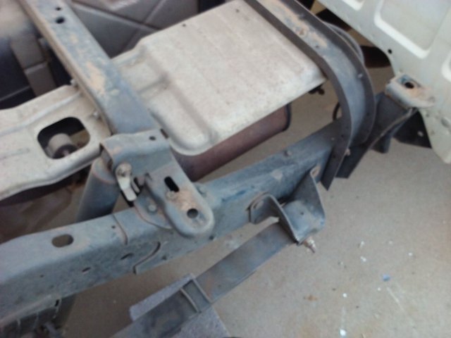

Looks worse than it is.. no frame damage

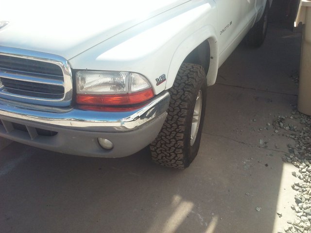

Slight dent in the fender.. can be fixed later with paintless dent removal.

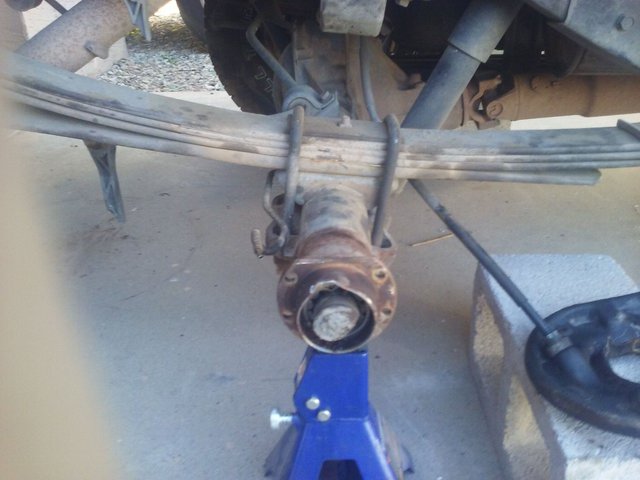

Axle housing it bent where the seal goes.. gotta get a new assembly.

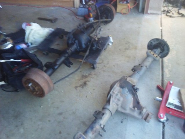

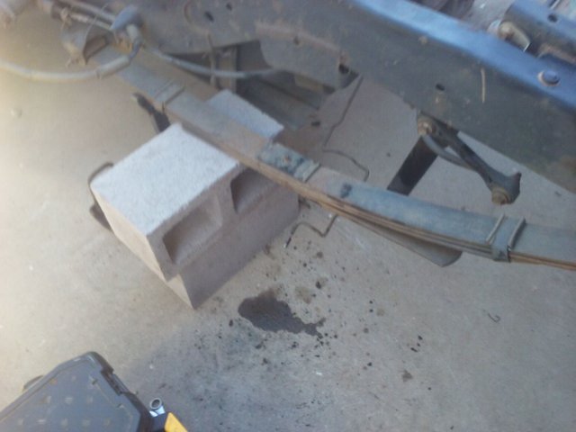

Here's a better look at the axle housing without the brake backing plate in the way. I snapped off the brake line but I was going to replace it anyways.. Do the u-bolts look bent? It almost looks like the spring pack has shifted slightly.

Be careful when you remove the U-bolts. If the axle shifted at all, it may have sheered the bolt holding the spring pack together, and that could get real exciting. (but, it really doesn't look like it moved.....)

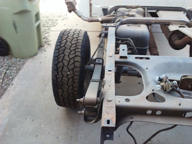

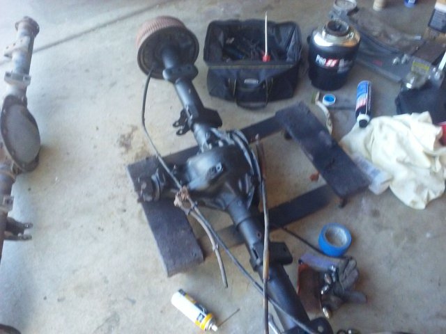

I pulled the bed off and sent it to the scrapper. Also found an open diff 3.55 geared axle for a decent price and was wondering Can I swap in the LSD carrier from the broken axle to the new axle? Are the housings the same? I would also throw new clutches in before installing and make sure to keep the ring and pinion set matched.
I watched a guy on Youtube do the same thing on his axle but it was a 9.25 where mine is an 8.25.

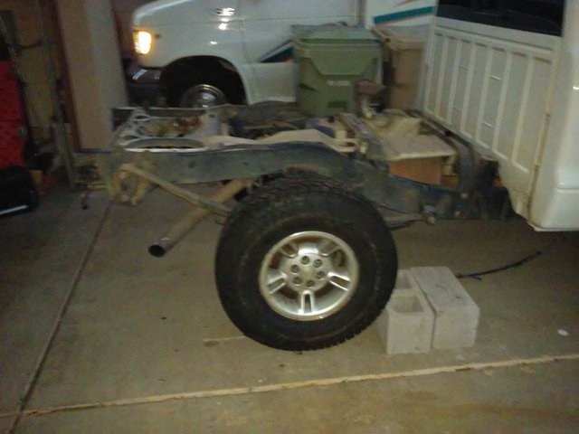

Here it is without the bed:

Out with the old, in with the new old.. I picked up the new old axle and attacked it with a wire wheel to knock off the rust and caked grease. After that I opened it up to check the condition of the ring gear and spiders and they all had slight wear, but the wear pattern looked ok. Checked the backlash which came in .005" which is within spec still. No play at the axle ends, so wheel bearings are OK, but I will change them anyway when I swap out the carrier for the LSD carrier.
Once it was all cleaned up, I shot it with a rust converter/primer then a satin black topcoat. All things considered, I think it turned out alright, forgot to get before pics of the axle.
I pulled the old axle (The leaf pack didn't explode!) and slid the new one into place. I still need to torque everything down, but the truck is on all fours again.
