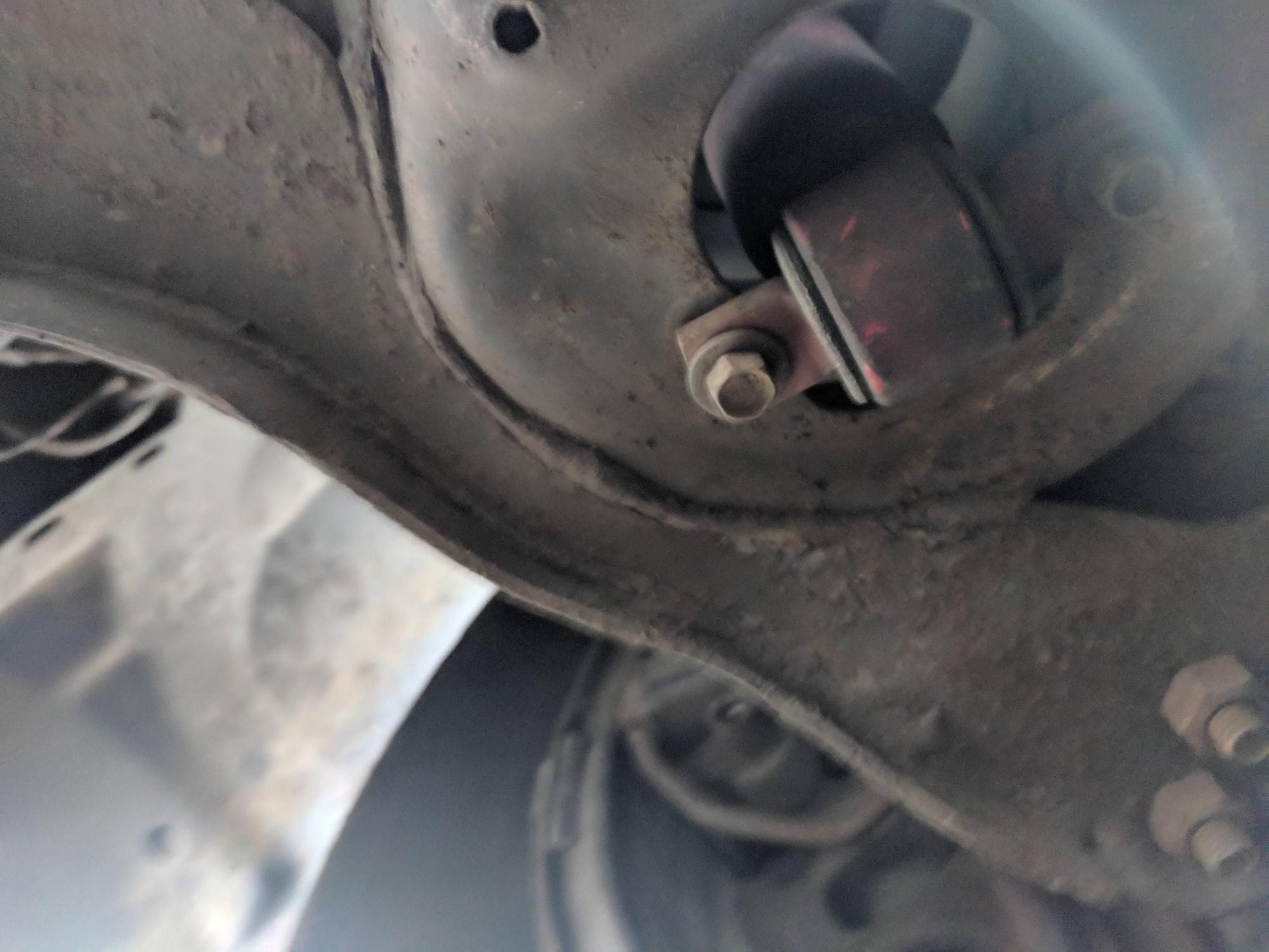

Harrumph I say. Lads, I do believe I found my culprit. Again, I can blame it on the previous owners. When I had got the truck, it was obvious to me the front end has had work, either ditched or fender bender. (bumper slightly off, and the overflow bottle had been cut from the bumper mount) Whoever straightened it out did a pretty decent job, impact was obviously on the driver side. assuming this is also why it's red and not factory black, new fender, paint job, (and the driver fender has holes for the magnum logo, passenger doesn't)
BUT ANYWAY this is just preface to what I just found, I've actually inspected the shocks before, at least, the driver front... It has a nice red Gabriel, matches the truck minus covered in road gunk.
Drivers side lower mount looks like this:
Apparently when they redid that side after whatever happened, they put a new shock in. Logically, you would say, why not replace them in pairs? It was not logic. The passenger one looks stock and my problem became obvious.
This is the passenger side:
Lower bushing has erupted, so when it's loaded, the lower is rattling around. Explains why I felt it through the floor and not in the steering.
Doesn't seem to horrible a job to replace, jack up truck, remove tire, two lower bolts and upper nut, slide out, replace? Does this process seem correct? It's a RWD.
Also, I can't go all out on cost, should I go with a pair of Gabriel or Monroe? (I'd love some Ranchos, heard a lot of good, but a bit out of price range for now... cause of replacing everything else.)
EDIT: Took another look to see where the upper nut is, that is going to suck to get to... But happened to notice I'm also missing the passenger side bump stop. Guess I should grab that as well. Also looking at Rock Auto, thinking about those KYBs, they any good?
EDIT2: Went with the KYB Excel-G, got both fronts shipped for $56. Not the cheapest, not the most expensive. Doing research a lot of people put the KYBs above Gabriel/Monroe, thought about the gas-a-just, but people say they're stiffer. I don't offroad or haul much, so a little softer oem style should do good.
