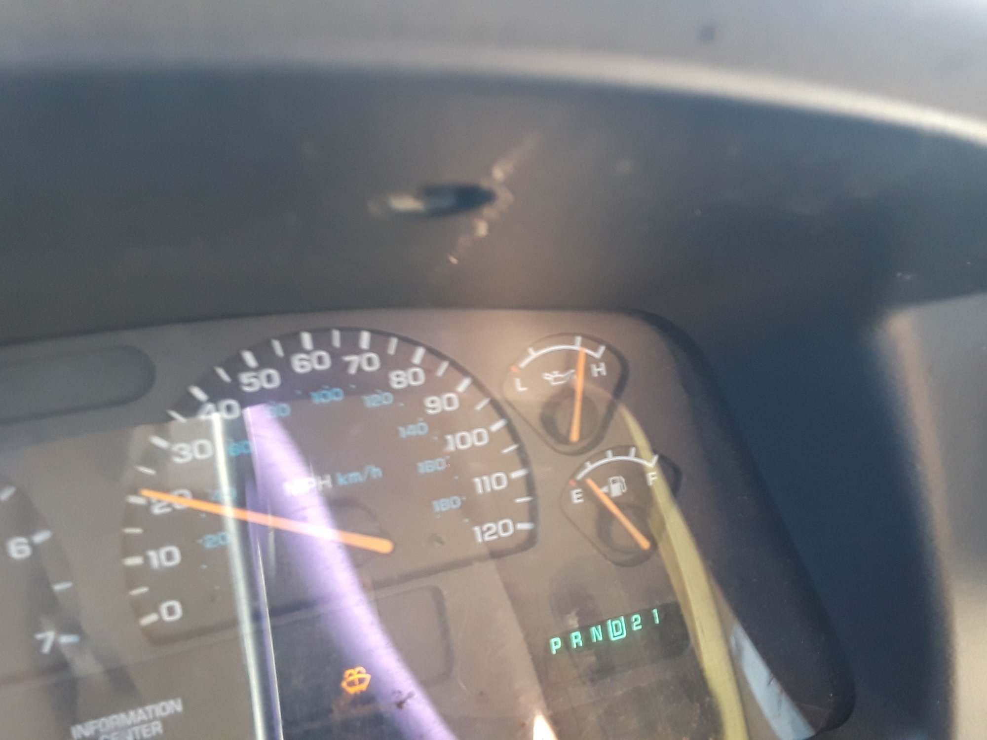

I have a 01 3.9 AT dakota an wanted to know if this is normal on the oil pressure.
After both start up an running down road an for a little bit after the oil guage is a bit high...
seems to go down a bit later also.
Just wanted to know if this indicates anything i should look at or later do.

Change your oil recently? I know on mine, (full size truck) with fresh oil, pressure is always higher, and will taper off some as the engine warms up. That's normal.

While there is indeed such a thing as "too much" oil pressure..... (and I have the perfectly spherical oil filters to prove it.... ) I don't think its an issue for you. So long as the gauge stays in the 'acceptable' range, I would just smile, and be happy.

Yeah, but he's complaining of high oil pressure. High viscosity will only worsen the problem. I said 2019 with regards to oil technology, not engine design. 0W20 has a tough oil film that will flow easier and clean better.
There are two three things that could be causing his issue in no particular order....
Oil blockage (this is where a thick oil would cause more issues)
Failing oil pump (although that usually causes pressure loss)
Bad sender
I'd put a mechanical pressure gauge on it.
Oh...I forgot a fourth reason that oil pressure could be high....excessively thick oil.
