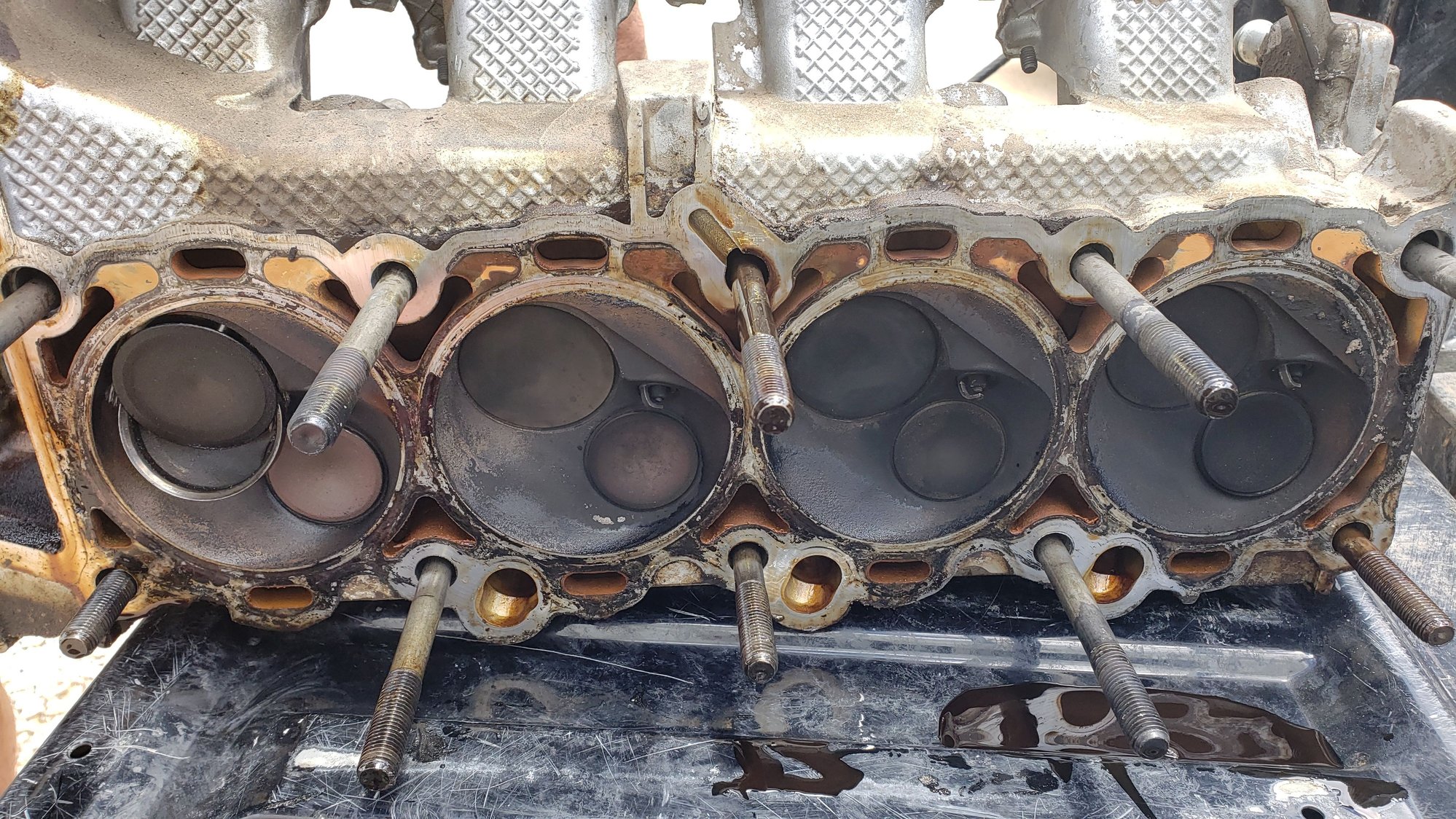

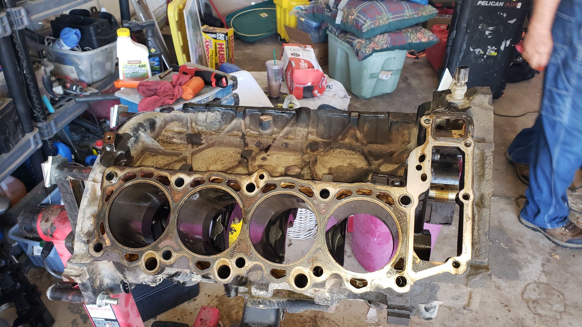

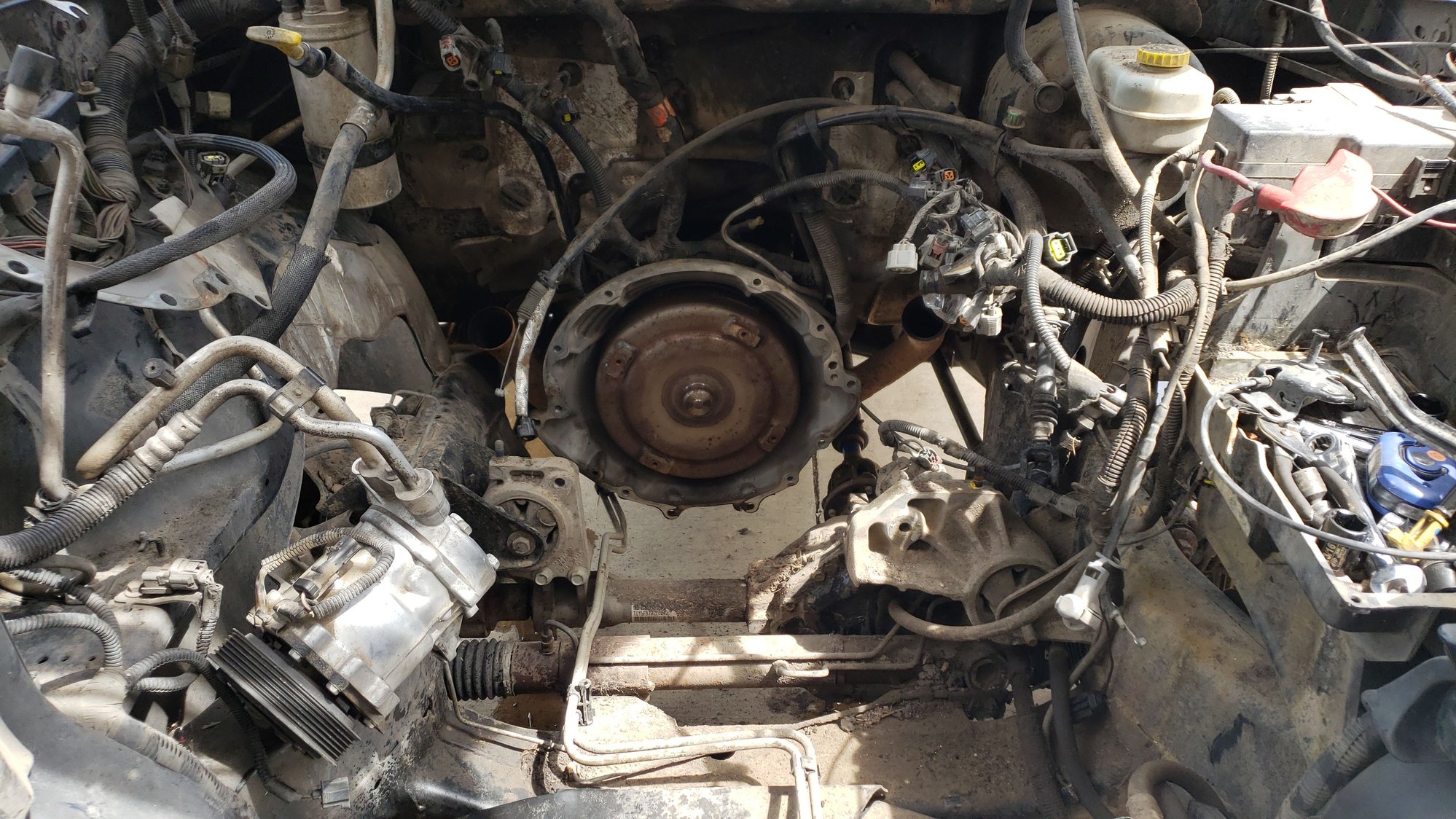

Finally got it out. Will start to tear down the weekend. You can see the seat intact on #2, which I regard as a good sign.

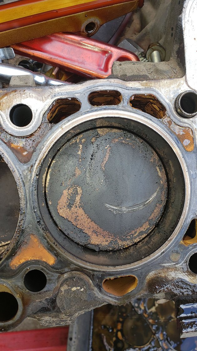

Only one seat bad enough to damage a piston. Heads look fixable but still unsure the best route.

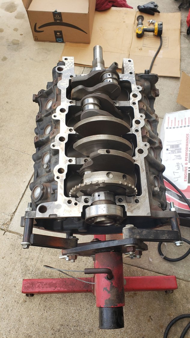

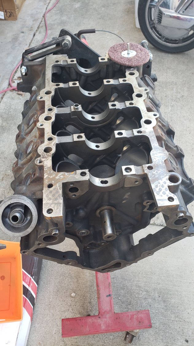

Update,
Finally had time to start putting the motor back together. So far just got the crank in and bed plate torqued down
