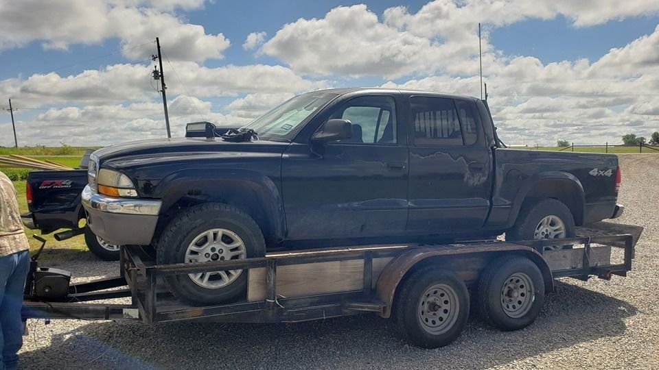

Greetings,
Just bought this 03 QC with 4.7, 4x4, and 205k miles. Currently running, but very rough. Not really driveable but I did manage to drive it onto the trailer. Located in DFW, TX. Paint is obviously junk, but it's straight, rust free, and only a couple of tiny dings on the bumpers.
It's been a ranch truck for a little while so it's dirty inside but not beyond recovery. Once I get it running it'll be a spare car for occasional home depot run. Eventually I want to be a proper weekend fun truck, and reliable enough for the occasional trip to NM or CO. Mild lift with big tires, bed liner paint job, modern head unit and some custom bed storage.
Anyway, like I said it's running VERY rough. It dies if you lug it down. It died when trying to ease it up the trailer ramps, or even when trying to maneuver it around slowly with a lot of steering angle. The seller claims it overheated hauling some stuff around their property and the issues started after that. In addition to the rough idle it occasionally sounds like it is backfiring, but in the intake if that makes any sense.
Any idea where I should start? For now I just want it running ok if possible, but we're prepared to rebuild if needed.

Began to get into it today. Did a compression test and had 3 with low compression and one with no compression. FIL says may as well pull it out so we tore it all down and got it to where we'd just have to unbolt the exhaust and transmission next weekend.
FIL decides to pull a valve cover just to see what we can see. Two rockers had popped out from under the cam. This is common on these when a lifter dies. So intake on cylinder 2 wasn't opening which is why we saw no compression. We're going to replace all the lifters and slap it back together enough to see how it runs
Where's the best place to buy new lifters, or anywhere I should stay away from?
