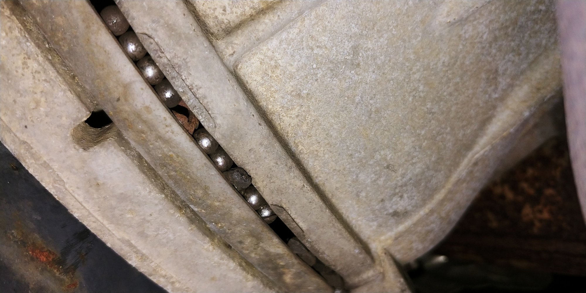

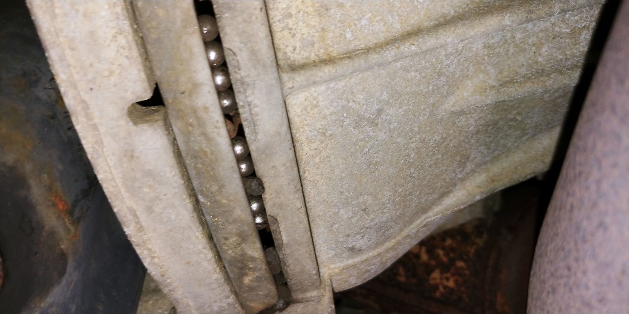

According to my build sheet I have a NV3500 HD
My clutch started acting bad, felt crunchy when engaged. Any idea where these ball bearings could have come from?
Old Sep 15, 2019 | 08:52 AM
Posts: 87,403
Likes: 4,214
Input shaft bearings..... Trans needs to come out.
Old Sep 15, 2019 | 12:13 PM
tonypilot7's Avatar
tonypilot7
Joined: Feb 2015
Posts: 178
Likes: 6
From: America's Pizza Oven.. Phoenix, AZ
I'm thinking your throw-out bearing exploded. Either way, the trans has to come out.
Old Sep 15, 2019 | 02:59 PM
akeED's Avatar
akeED
Joined: Sep 2018
Posts: 44
The shaft bearings are ball and not roller?
The throwout bearing uses ball bearings?
Old Sep 15, 2019 | 09:47 PM
00DakDan's Avatar
00DakDan
Section Moderator
Joined: Dec 2010
Posts: 4,858
Likes: 47
From: MA
Throwout bearing, definitely. I had mine grenade like that too.
