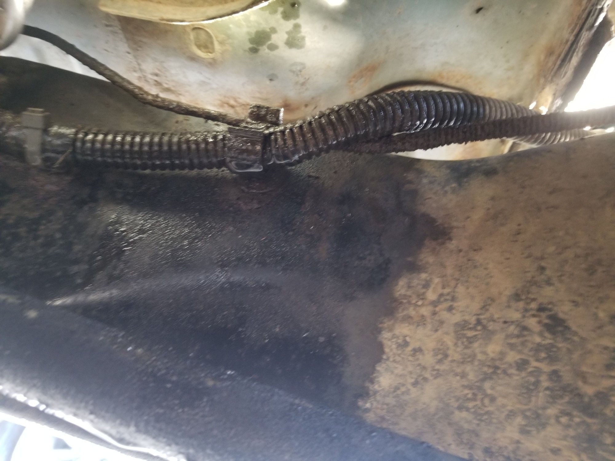

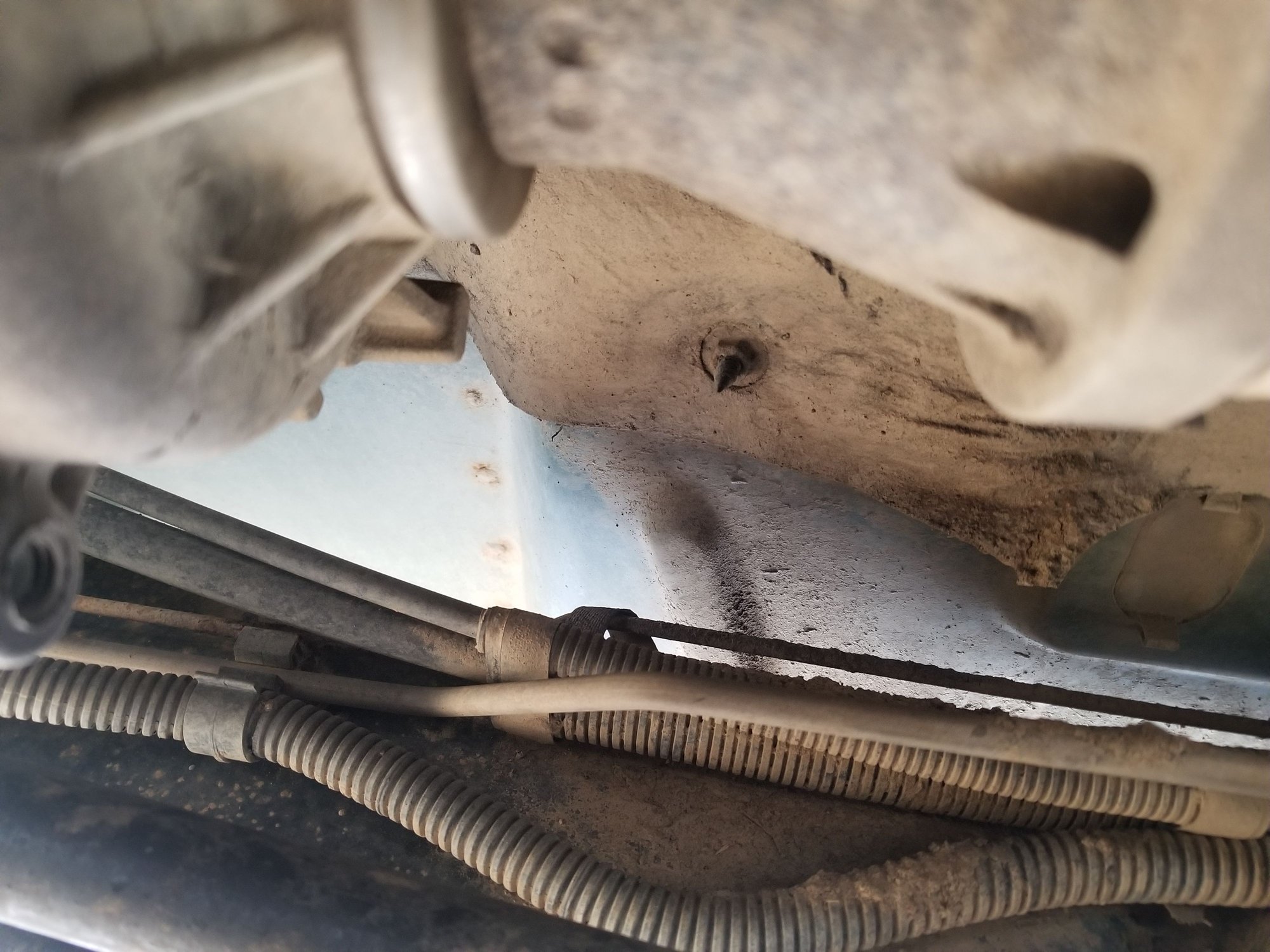

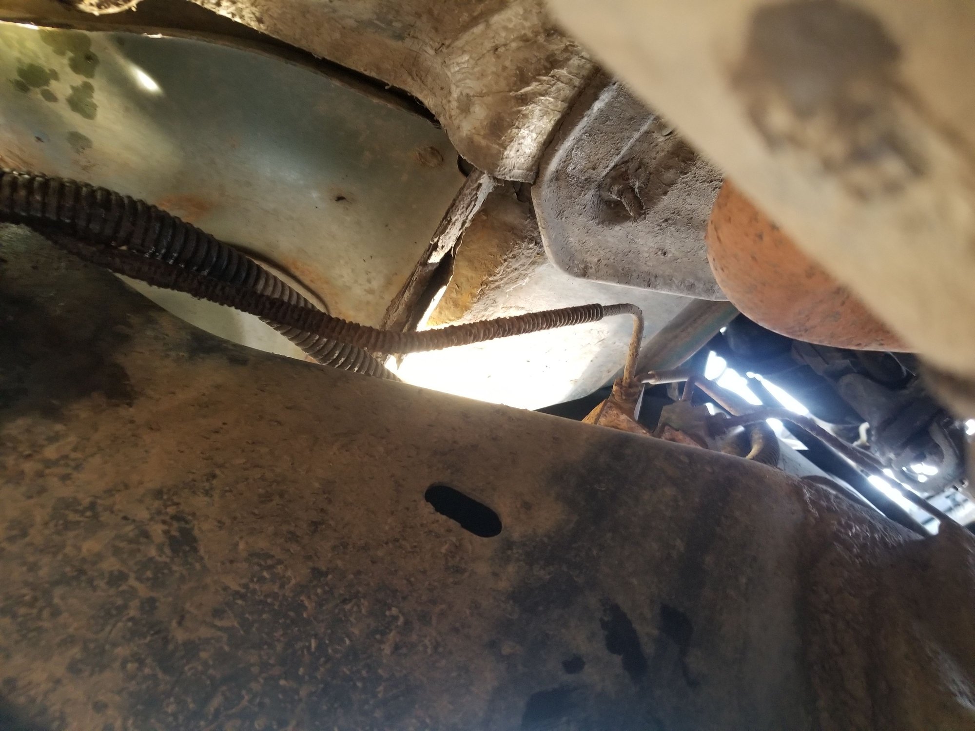

Hello there guys i have a 02 dodge dakota 4x4, in the photos im leaking from this line and need to know if any body would know the part number. thank you derrick

unfortunately the rear brakeline had been out of production and unobtainium for a couple years. You'll have to get a roll and make your own line.
