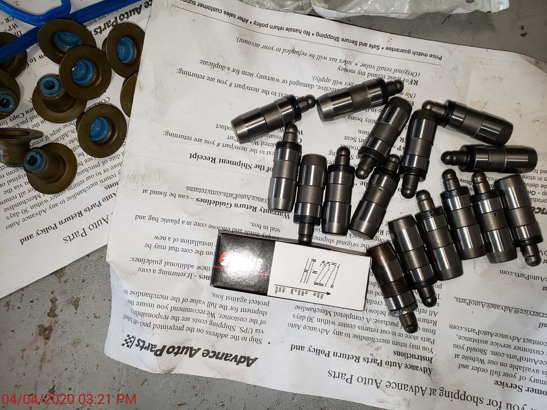

So I pulled the head cover off the passenger side before to see if I had any fallen rocker arms and luckily none had but it was really nasty with caked oil. I ran some moly cleaner through it, seemed to lessen where it was baked onto the interior of the head but is rather still caked onto the cam and rocker arms. So I guess my first question is how do you clean the caked on crap. Second I pulled one of the rocker arms and looked at the lifter. So I can't push down on it (ie no spring action) but after a little playing with it I can at least spin it so I'm not sure if it's a fixed lifter orva standard spring loaded one

You should replace all the lifters. When they get hard like that, they seize and throw rockers. I"m in the process of doing that right now. These are Sealed Power brand. I'd tell you to run a motor flush through it, but I'm afraid you will clog the oil pickup if it's that bad. You may need to do it anyway, then pull the oil pan and clean the pickup..
Start running a thin full synthetic and stay away from conventional. I run 0W20.

Yes it's a 4.7l in going to clean the rockers best I can. I ran the moly cleaner through it and it's only this disgusting so it may require a couple more flushes and then drop the pan, no idea what was in the motor when I got it but it's first change was a high mileage synblend but I will probably goto a full synthetic next. I intend on changing the lifters anyhow. They are soaking at the moment. So they either collapse or get bound up with junk?

At this age, I'd change them cause the springs are worn. If a rocker ejects, it can do damage. When new, they are nice and springy as you push down on the plunger. None of mine were like that. If I grabbed the plunger, it would move up and down with no springiness, which would cause that cold start clatter. The seized one wouldn't move at all.
If I were you, I'd spend the hundred bucks and get a set. Use the Advance discount at the top of the page. You need 16 of them.

Got 7 out of 8 lifters changed in the passenger side. (Started to rain) all of the 7 were able to spin but had 0 springyness. The new ones look very similar to the ones I removed but they flex.
