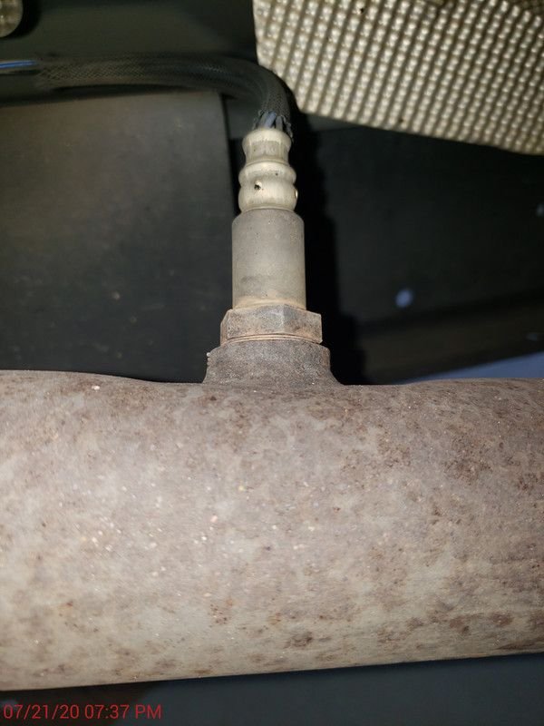

I was bored this evening, so I sprayed the shift linkage on the tranny with graphite dry lube. I do it once a year... it makes shifting at the stalk feel very smooth, esp shifting out of park, which is usually clunky.
While under there, I verified that the Dak only has two O2 senors. That's important when considering the fea$ability of replacement. I'd never recover the $$$ spent on 4 sensors in improved gas mileage. I shoulda sprayed them with PB blaster but it slipped my mind. Not too bad though. No real rust here in the south. Looks like a regular or adjustable wrench should do the job just fine. No crows foot or special O2 socket needed
Upstream sensor (before the cat). It's gonna be a beyoch unplugging this one as the plug is jammed between the body heat shield and the transmission.
Downstream Sensor (past the cat). The camera was pointing towards the front of the truck here.
