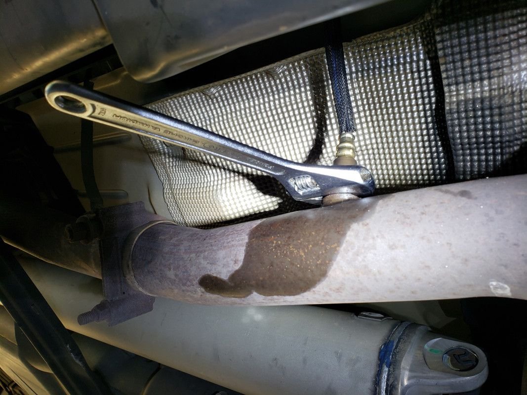

Well, I finally got the O2 sensors installed. Lets see if they have any effect on mileage. Lately I've been seeing slightly less than 14 mpg, mostly local driving.
Almost 7.5K since the valve job, so lumped it in with an oil change and wheel rotation. With the new valve seals and valve stem seals, I lost no oil. Even with 7.5K, the oil was still honey colored on the stick. The tailpipe still has no soot buildup from when I cleaned it out back in early June. https://dodgeforum.com/forum/2nd-gen...ml#post3483358 Not bad for 317K.
The old sensors 'looked' to be in great shape. I'm keeping them as spares since they were technically still good. The downstream was easily removed with an adjustable wrench. The upstream was a bit more challenging cause the transmission pan was in the way. I managed to find a rusty old Chinese 22 mm wrench and was able to lean it just enough to make it work. Getting the plug off where it was mounted was a beyotch, but it's done
Upstream
Downstream
Rear pads getting low! Maybe on the next oil change.
