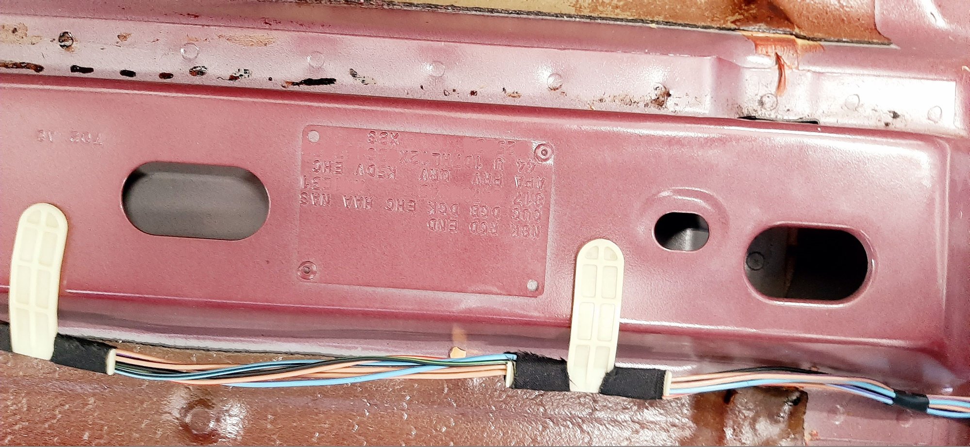

Now then, since I do have stuff out of the truck, I do have a few observations about it. Remember when I recommended swapping VINs to a member? I found a VIN plate under the carpet riveted to the passenger side of the rail that the fronts of the front seats bolts to. I also found quite a bit of factory installed MLV pasted under there. And, when I pulled the rear panels off I found a plastic bag stuffed with fluff on each side. At first I thought it might be a previous owner's drug stash.

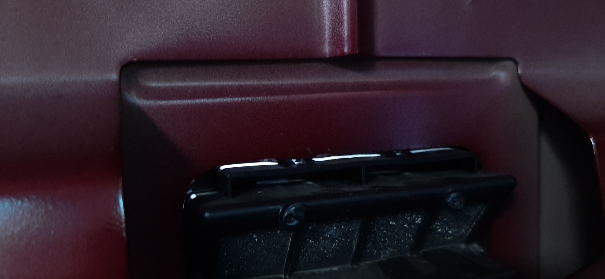

The rear vents in the back of the cab leak water, as I found water in the plastic tray under the seat. The vents clip into place, but are hard plastic against metal and it's not a tight fit. Water runs down the back of the cab wall, and runs right in between the vent and the sheet metal. It would be worthwhile for the rest of you to check yours. A little silicone would solve the problem.

This is a picture of one of the rear vents, with a flashlight shining from above, that shows where it leaks. I DID unseat the vent just a bit in order to get the shot because while I could see the light coming around the vent top with the vent fully seated, my camera could not. The opening is large enough that water running down the back of the cab will come in and run down to the plastic tray under the seat. My tray had about 1 inch of water standing in it. Both vents have the same problem.
The aforementioned data plate, slightly altered to remove identifying information for the truck.

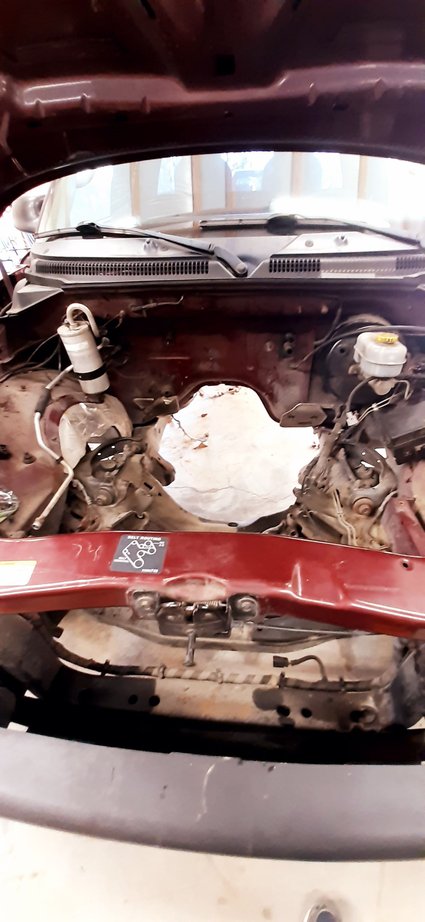

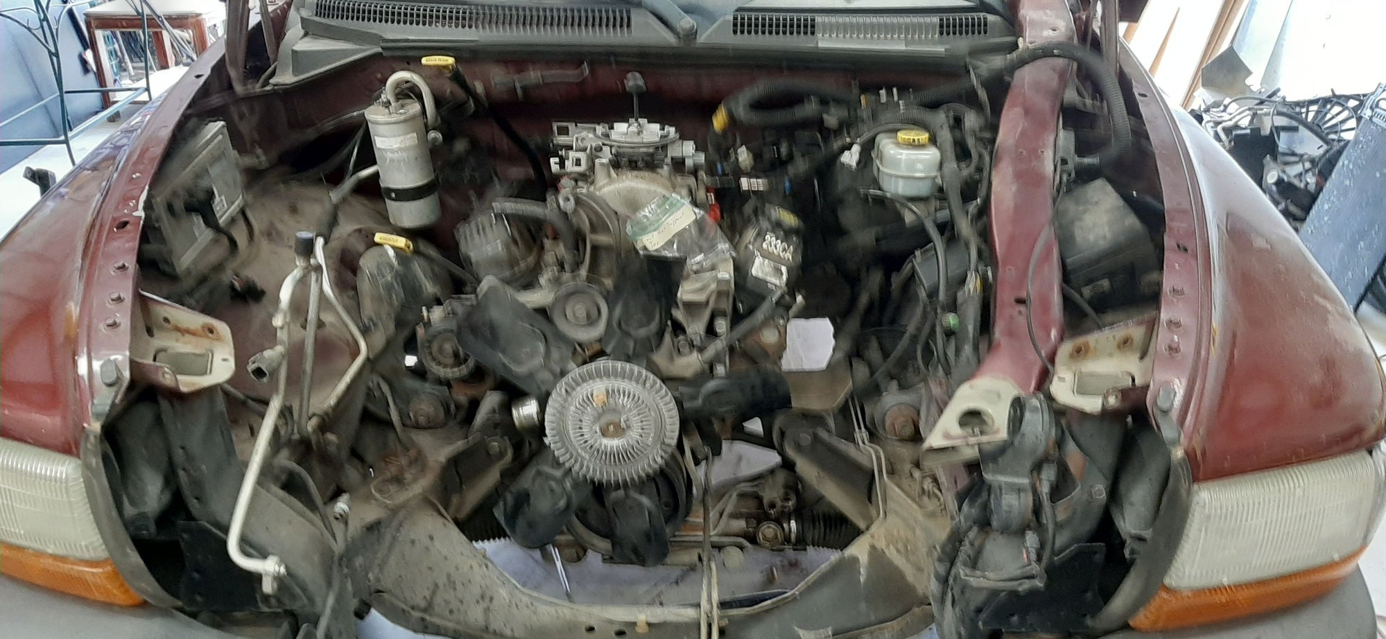

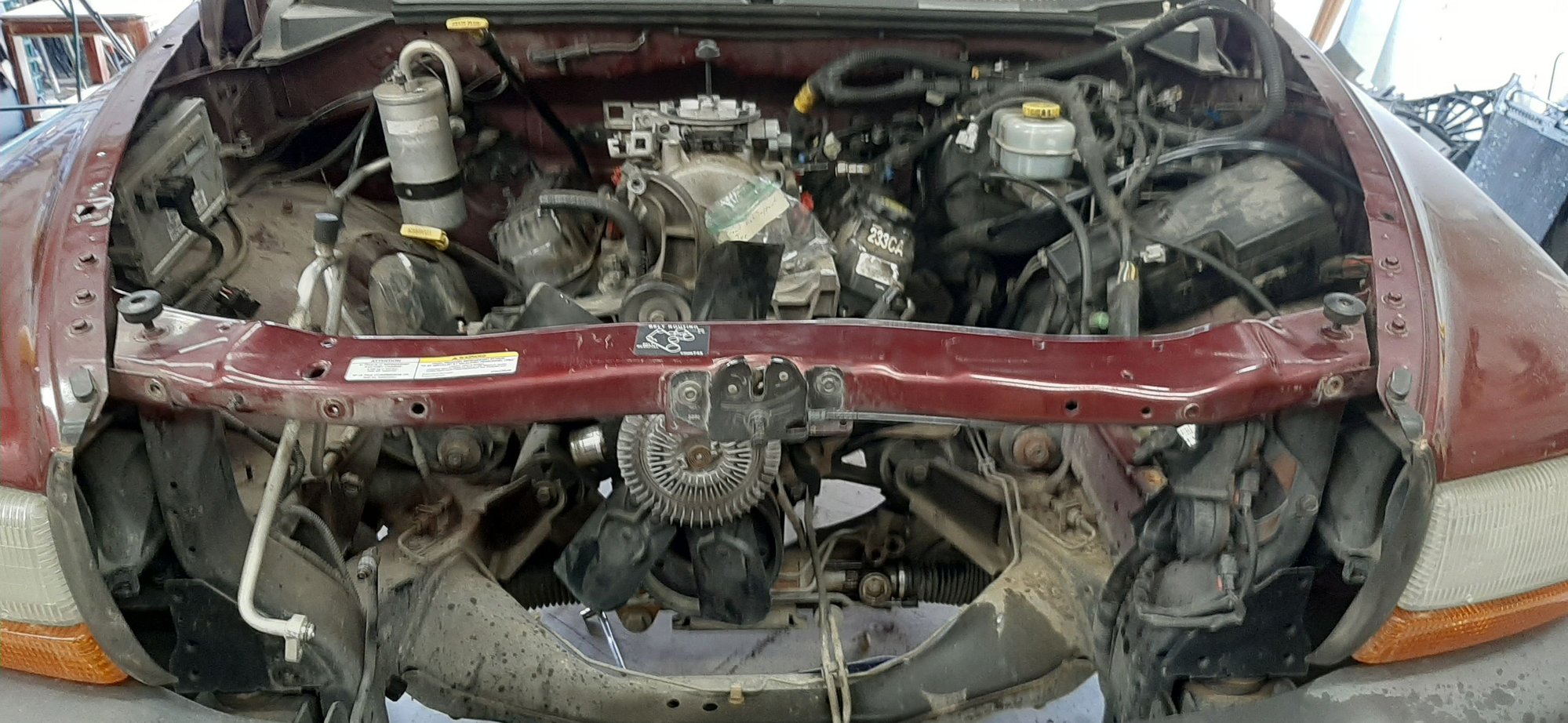

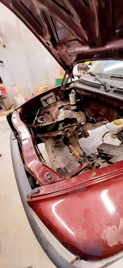

This was my favorite part of this job. Now you see it...

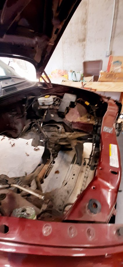

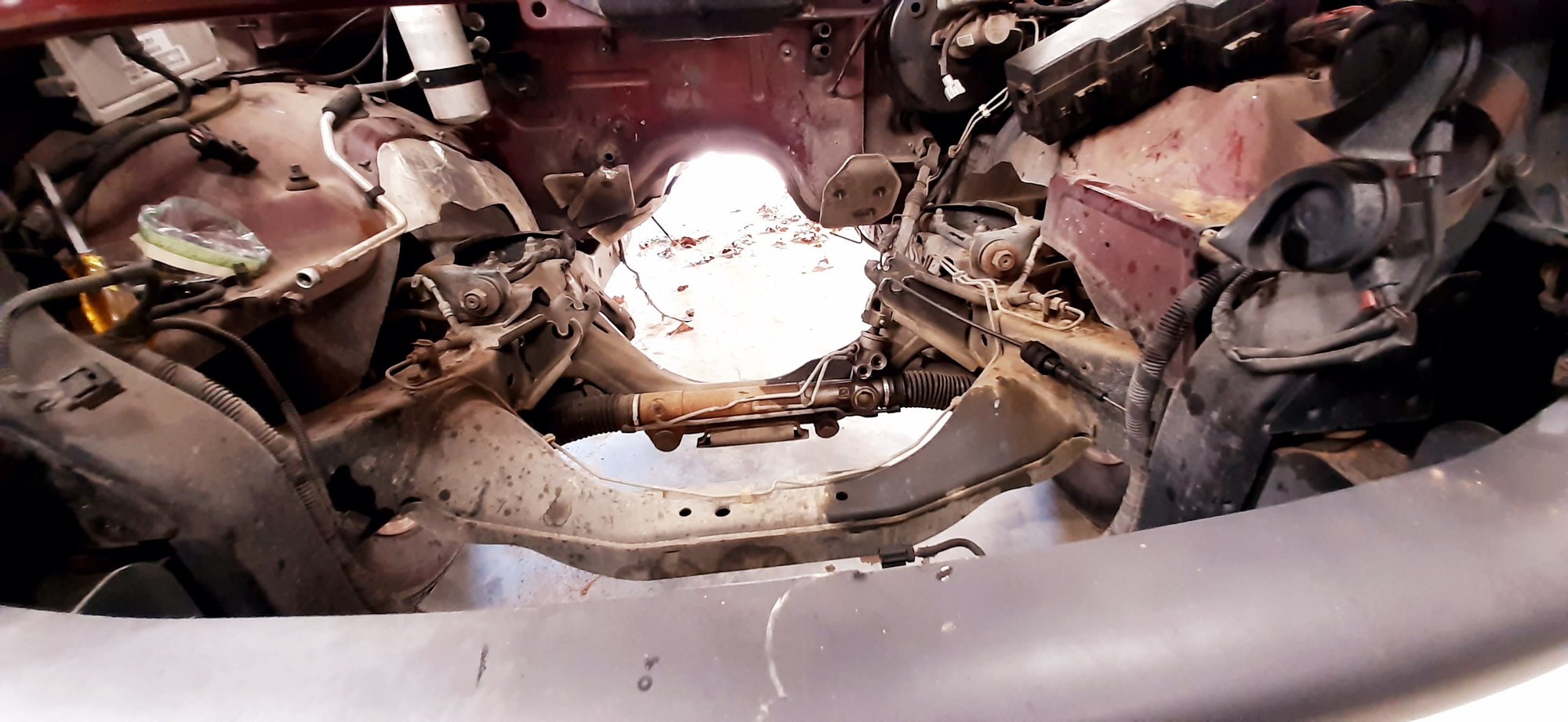

Now you don't. That removable rad support top made it SO much easier to pull the engine. You'd think Dodge designed this truck specifically for hot rodding.
And the engine, transmission, and driveshaft are out.
