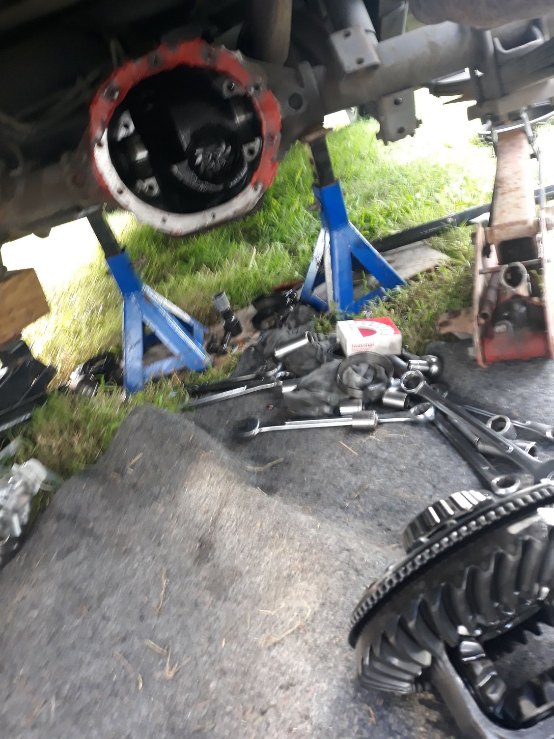

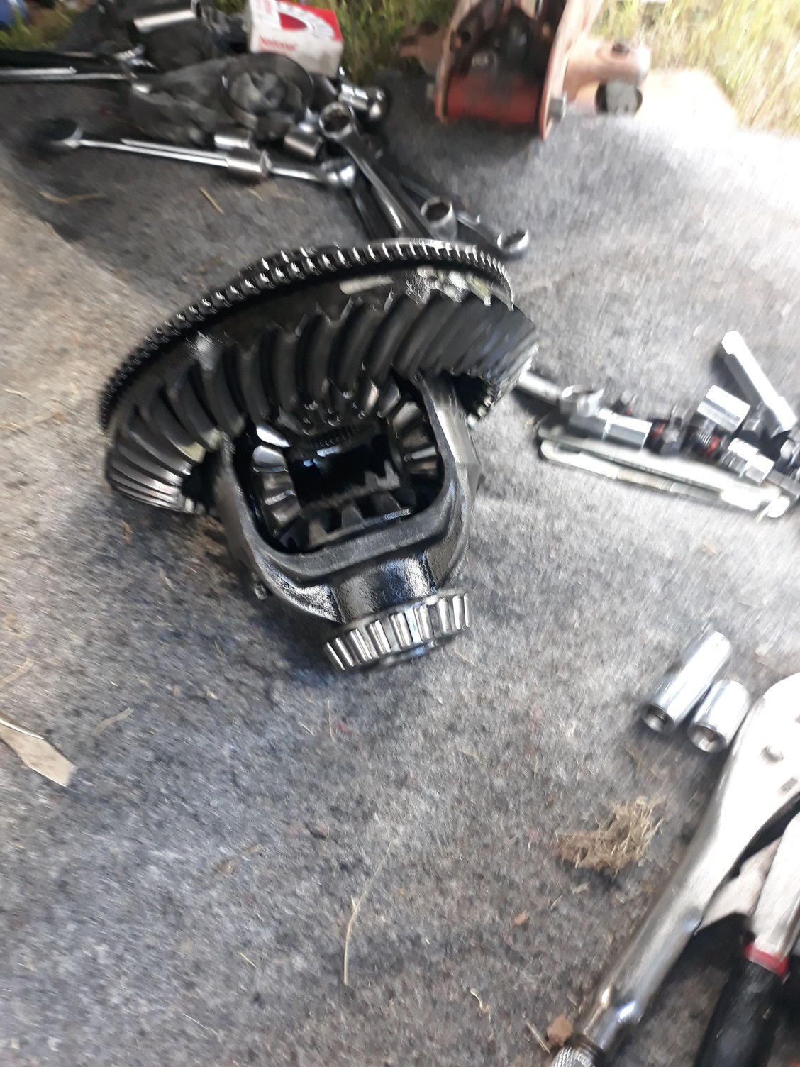

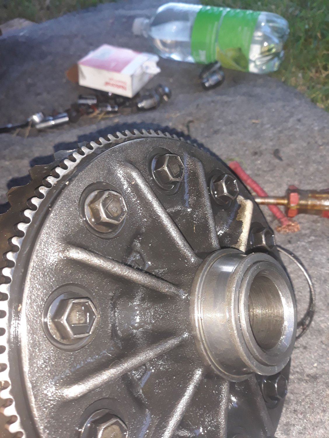

I got the differential out on my 01 ,2wd automatic. What tool works best on carrier bearings ? It it tight there an not a big lip to hook to.
Also should I look at the pinion bearing an how do i tell if the bearing in it is bad without taking it apart..
got outside bearrings off but inside is in there ..
Thanks
Old Sep 10, 2021 | 08:56 AM
Posts: 87,468
Likes: 4,220
One of the clamshell style bearing pullers, and a press.......

Took it in to shop..had em off an new on for $30 in 15 min👍

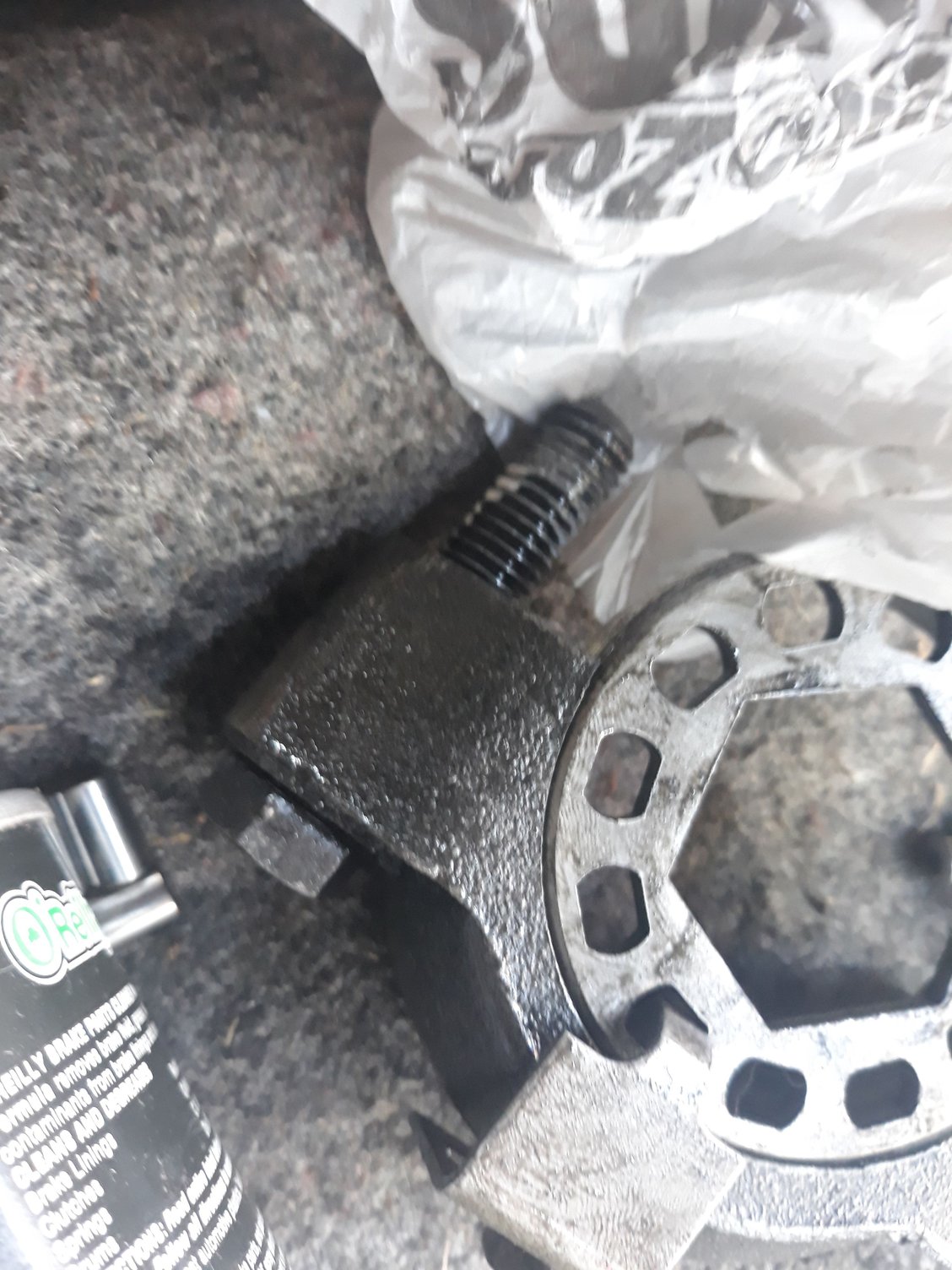

What does this screw adjust exactly.Its on a clip to the notched wheel by bearing ?
Old Sep 11, 2021 | 11:14 AM
Posts: 87,468
Likes: 4,220
That is just a lock for the adjusting nut. Adjust it where you want it, torque everything down, then put the clip/bolt in, to hopefully keep it from turning.

How tight should i fiT that slotted wheel in into cover. Against bearing?
Enough to let bearing an diff have a bit of movement 1 slot edge viewable on outside.
Old Sep 11, 2021 | 12:37 PM
Posts: 87,468
Likes: 4,220
On those, I am not sure. Should be a procedure for setting backlash in the service manual. If you don't have one, we have several available in the 2nd Gen Ram FAQ/DIY section. They are for full sized trucks, but, I think its the same axle.
