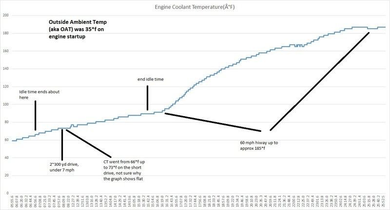

This graph is off the Ram, the slow rise area on the left is the time it took to get from one end of the apt complex to the exit. 5~10 mph with one short steeper climb up a hill. Once on the freeway (entrance 100~150 yards from the apt exit) the rise rate of the CT's is pretty consistent. The flat spot in the middle of the freeway run is a long downhill section, 1~1.5 miles IIRC and the truck is in neutral. The graph shows an approx 25 minute chunk of the 35~40 minute drive into work. At the end of the clip, it is still not up at operating temp. It has a 200* stat in it, front radiator most likely completely blocked since it was 35* out, electric fans in place but not ever turned on.

The sludge issue can be managed and the right solution found, my thinking is to run the motor between 195~200 moving forward. If it had an iron block with iron heads, I'd run it at 200~205 if not higher. The hotter the engine, (within reason) the better the fuel economy (one of the secondary goals).
I know what worked to extend the life of the Cummins motor, which I thought 2x was on its way out, some of that knowledge will get applied to the 4.7. I already see it with the stiction eliminator in the oil which kind of surprised me. Pressure has stabilized significantly in the ~150 miles that it has been in there (according to the gauge). CT's are still up over 200*, soon I will drop in the 190* stat, yank the fan clutch and re-evaluate from there. Still have some work to do to get the warm fuzzy 300 mile day trip level. Work in progress...
