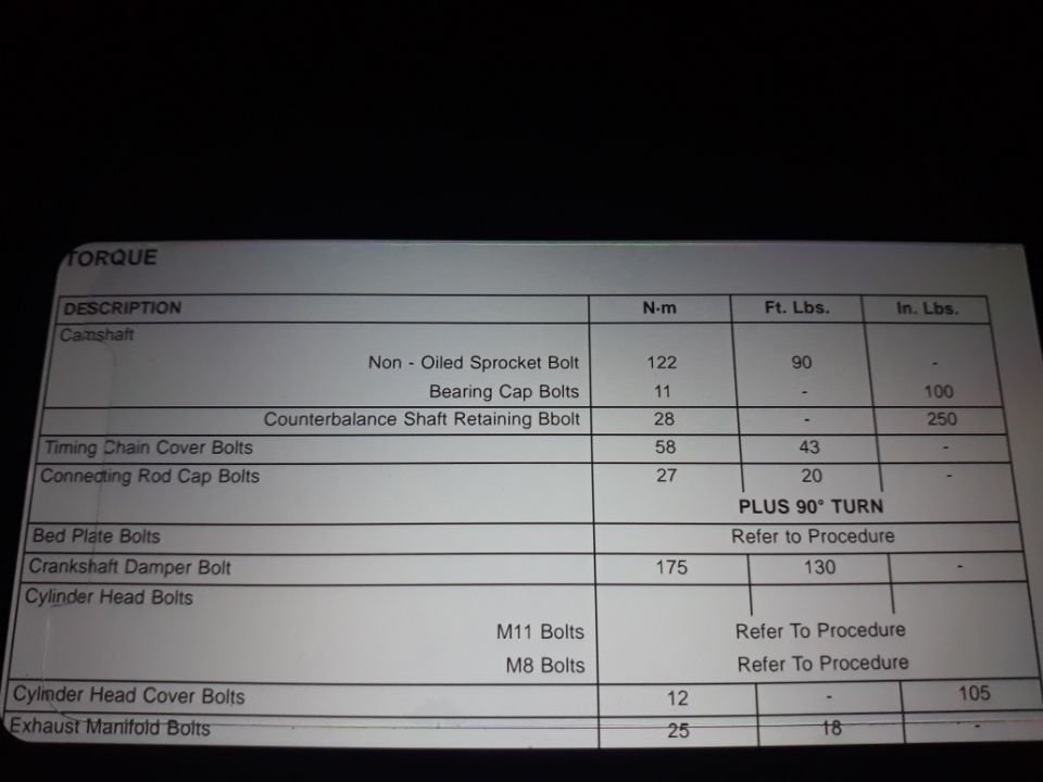

Vibration Damper/Hub To Crankshaft 135 Ft-Lbs 1620 In-Lbs 183.04 N-m Years: All
Note: Magnum - Vibration Damper to Crankshaft BoltVibration Damper/Hub To Crankshaft135Ft-Lbs1620In-Lbs183.04N-mYears:AllNote:Magnum - Vibration Damper to Crankshaft BoltType: BoltDim:Length:Head: HexagonGrade:
Saw this also ..yes its that bolt that goes thru balancer..
Pic is from that downloaded fsm
Type: Bolt Dim: Length: Head: Hexagon Grade
