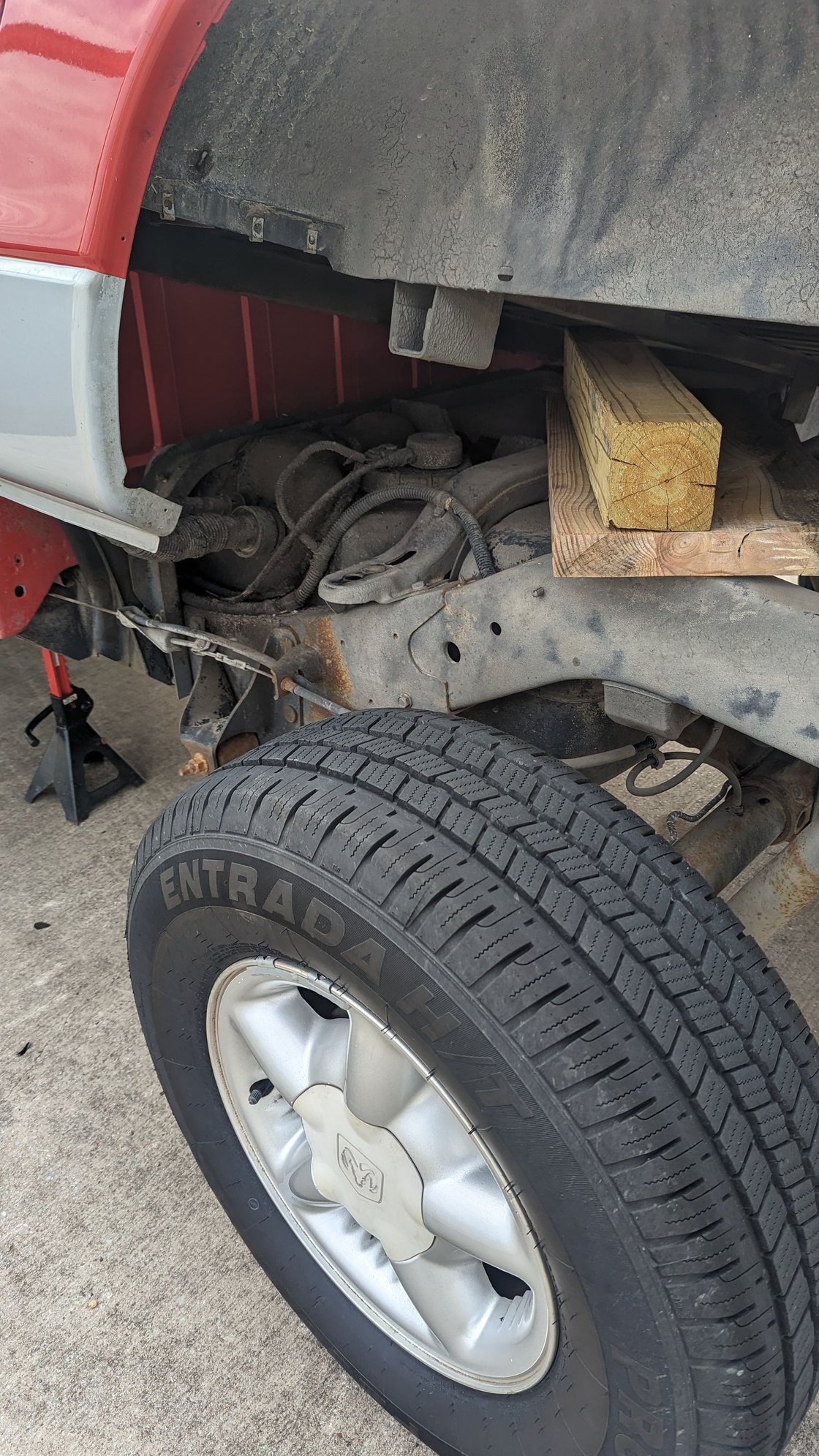

Next question: drop the tank or raise the bed?

Old Feb 15, 2023 | 10:01 AM
  #36
Posts: 87,479
Originally Posted by tensleep
Why full, of course. I was smart and filled her up prior to an ice storm. 🤦‍♂️
That's definitely 'lift the bed' territory then.

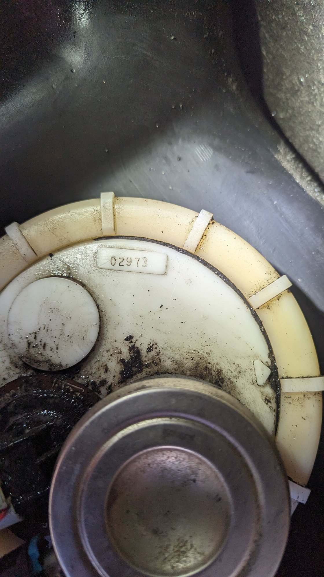

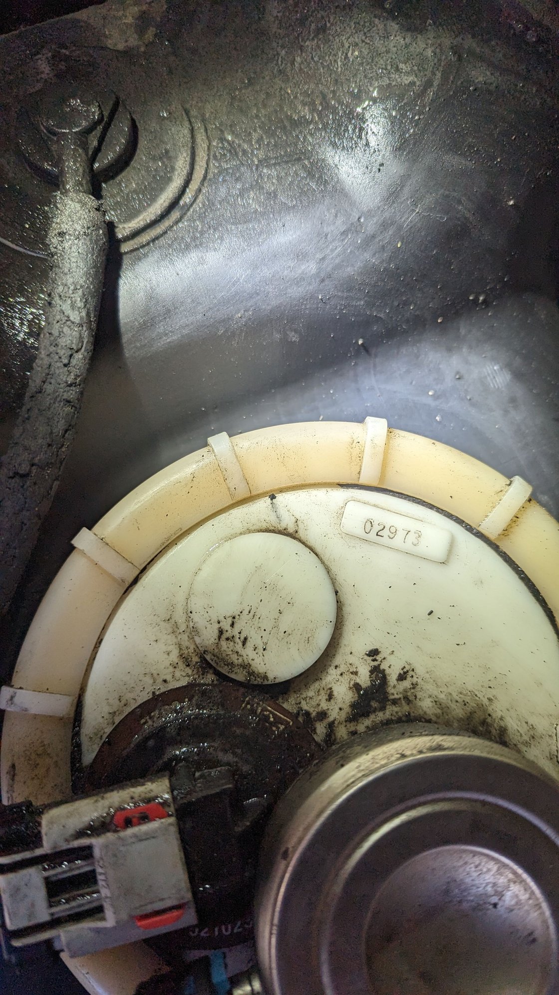

I have everything exposed and cleaned up. Now. I have to remember how these disconnects work. I really don't want to break anything at this point. From looking at the old pump and the new pump I don't see the dreaded rollover valve. At least I'm hoping I don't have one. Am I wrong? I still have to get the old pump out but I thought the rollover valve sat on top. Here are some pictures.
New pump
Old Feb 16, 2023 | 03:20 PM
  #39
Posts: 87,479
Yeah, looks like they did something different there. Your new pump should be a direct replacement.
