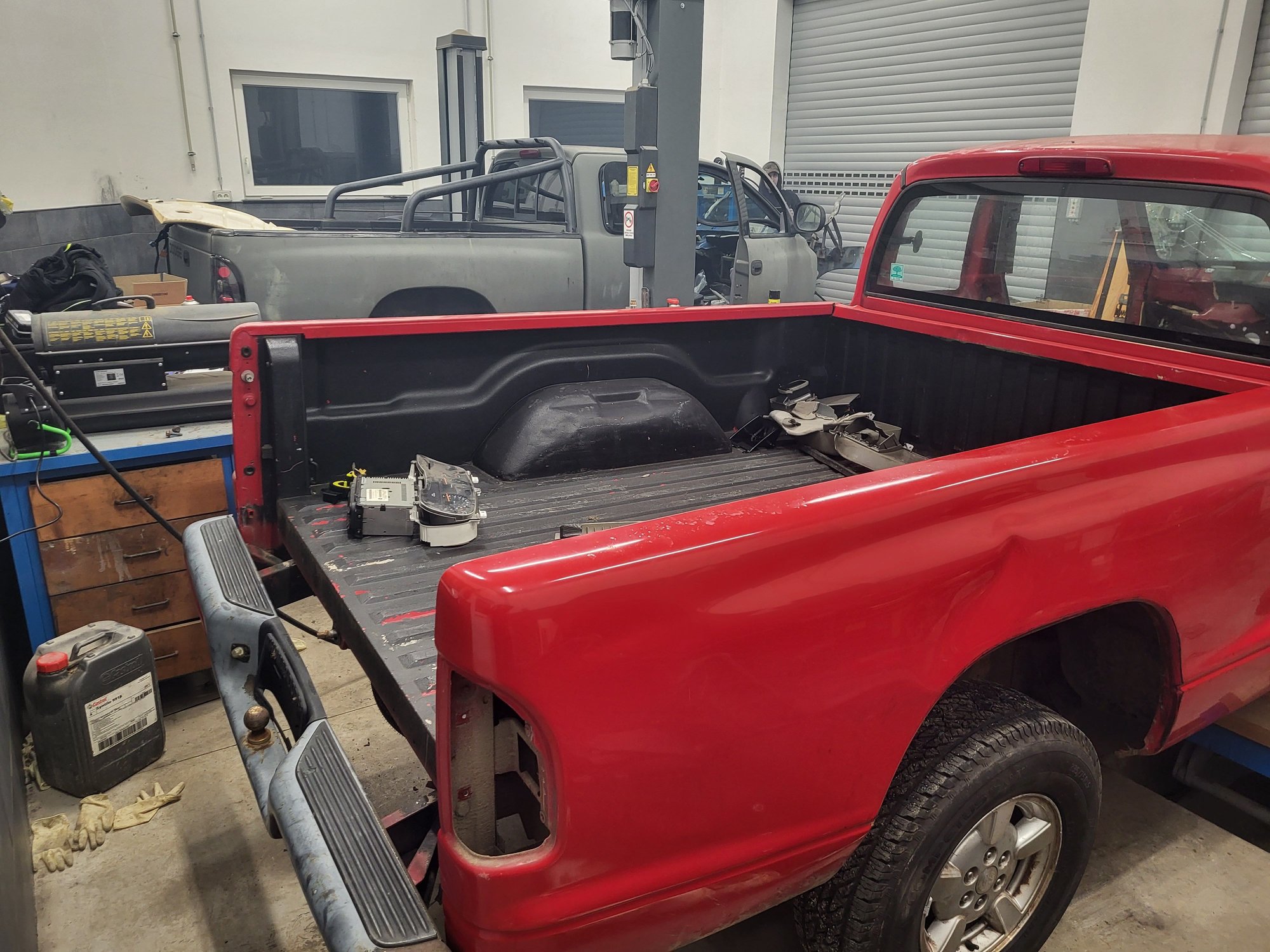

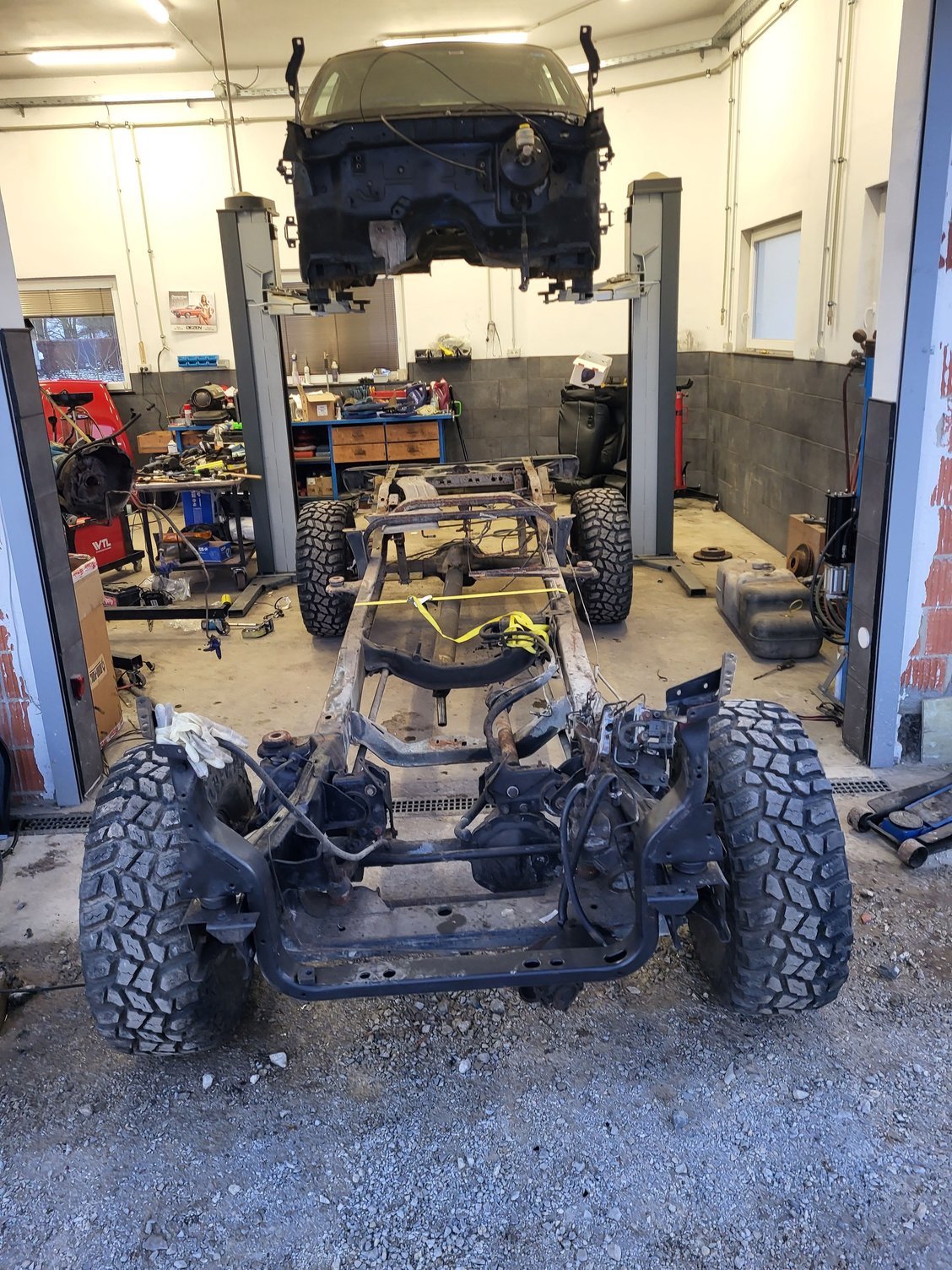

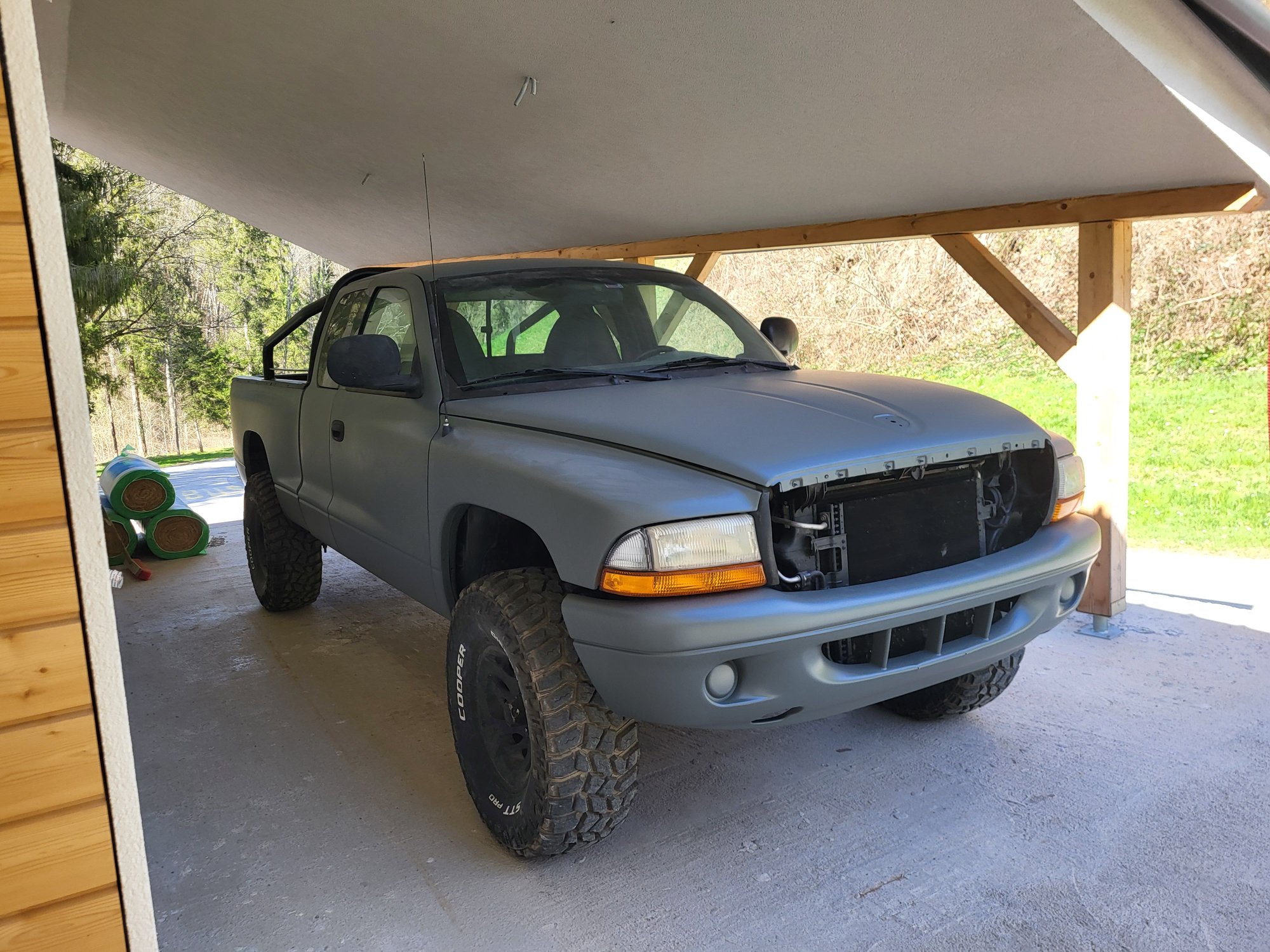

I have a Dakota 1997 3.9L 4x4. The engine bay was cought into fire while driving and after the fire was put out there was quite a lot of damage on the engine, brakes and electricity wiring.
I must add that I am coming from Slovenia and you can't find a Dakota here on the street, so the spare parts are quite a problem to get here.

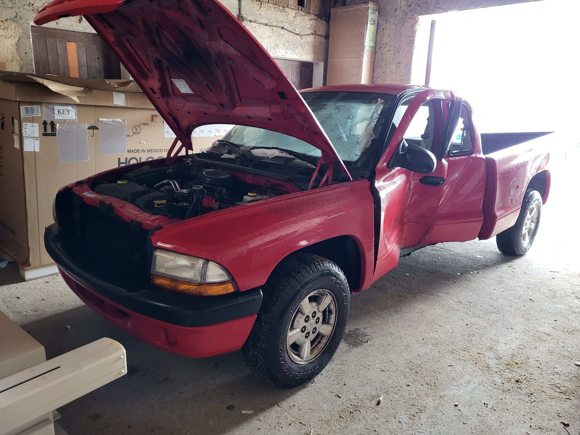

I have found a Dakota 2001 with 3.9L 2WD in the neighbour country, which was crashed on the side.

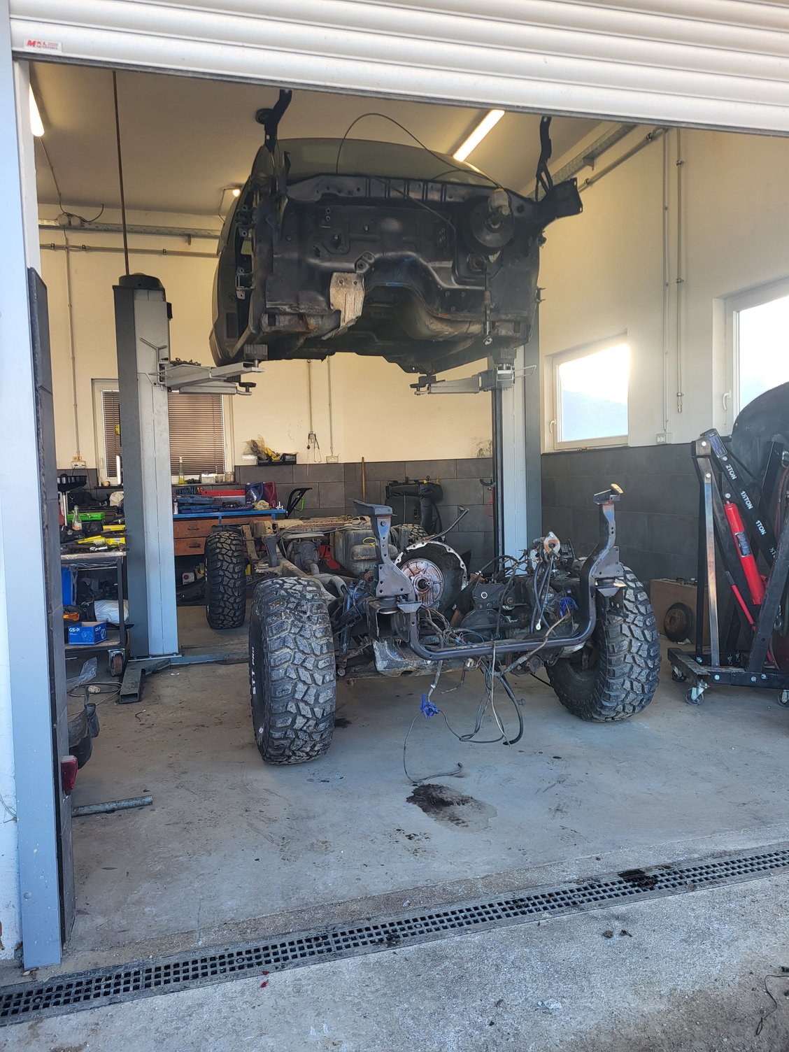

I have bought it as a donor car - it was normally driveable. I decided to swap everything from 2001 to 1997 truck, so I have swaped complete electronics, complete cables, cabine wiring with dashboard, engine wiring, computer and so on..
The only thing that did not fit was the transmission, (2WD to 4WD), so I have combined the two. From 2001 is now the front end of transmission with the pump and lever for shifting and transmission solenoid. And the second part of transmission and a transfer case is from the 1997.
First question I have is.. speed sensor on the transmission in 2001 and 2WD is located at the end of transmission and it has 2 pin connector and on the 1997 4WD is located at the transfer case and it has 3 pin connector. Is it possible to wire that 3 pin speed sensor that would work like 2 pin speed sensor?
I was reading that speed sensor could be the issue that transmission is not shifting? Could be anything else?
Thank you!

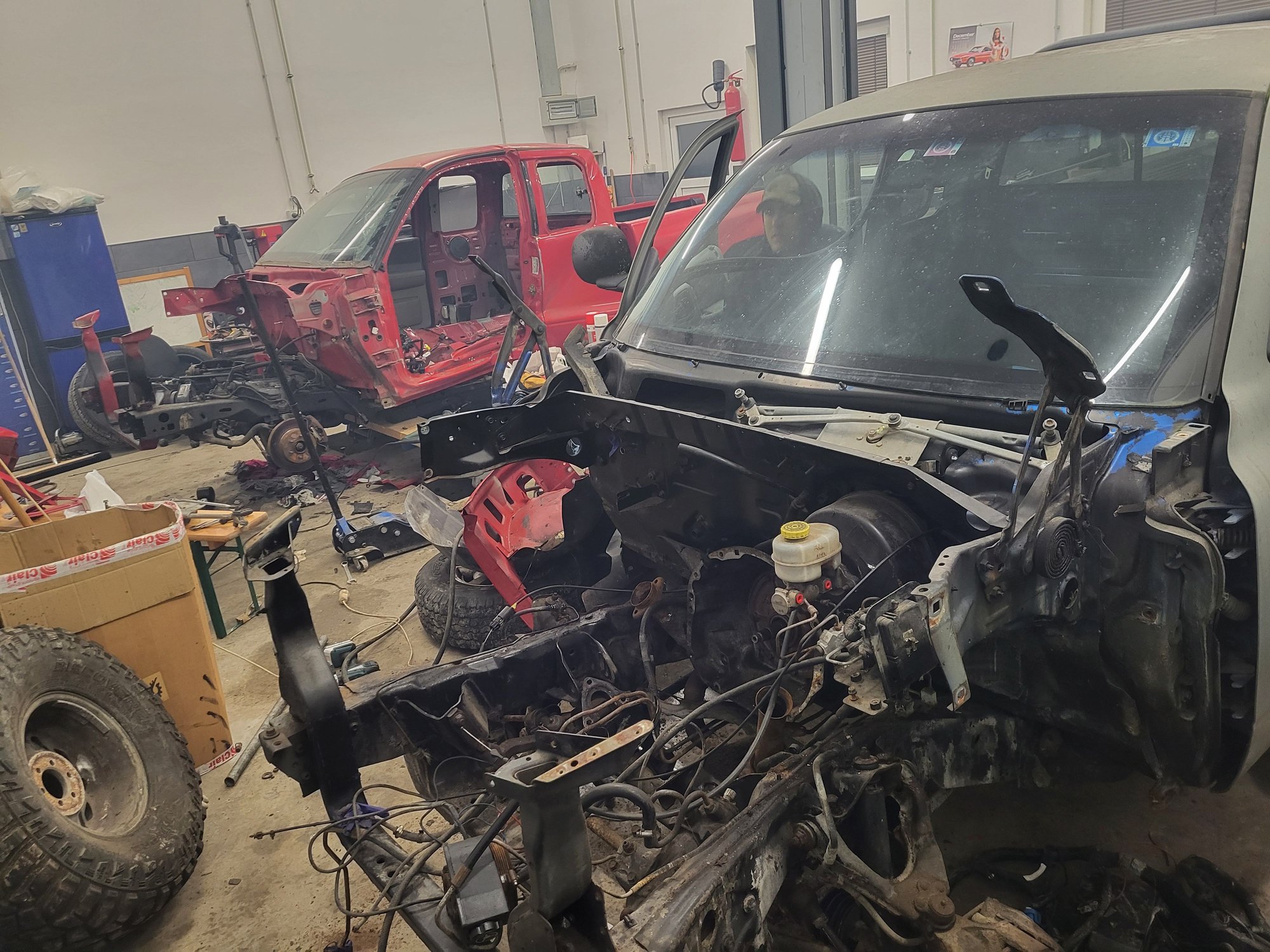

Hello again,
I am sorry for my late feedback. So.. for now I am experiencing two troubles.. one is that I don't have brakes on the rear side, I have changed the rear cylinders and it's still the same. I have put apart the front master cylinder and it seems that it does not work good for the rear end (car was staying on the same spot for a year and a half wihout oil in cylinder).
The second problem is still the speedometer.. I have changed the sensor on the back (abs sensor?), and when I start to drive the speedometer works and the car shifts normal, after 20 seconds of driving the speedometer goes to zero and stays there and of course the car shifts to first gear. If I turn off the car and then back on, the problem repeats.
The sensor I got is not original, could that be the problem? Or is there any grounding that could cause this issue?
Thank you!
