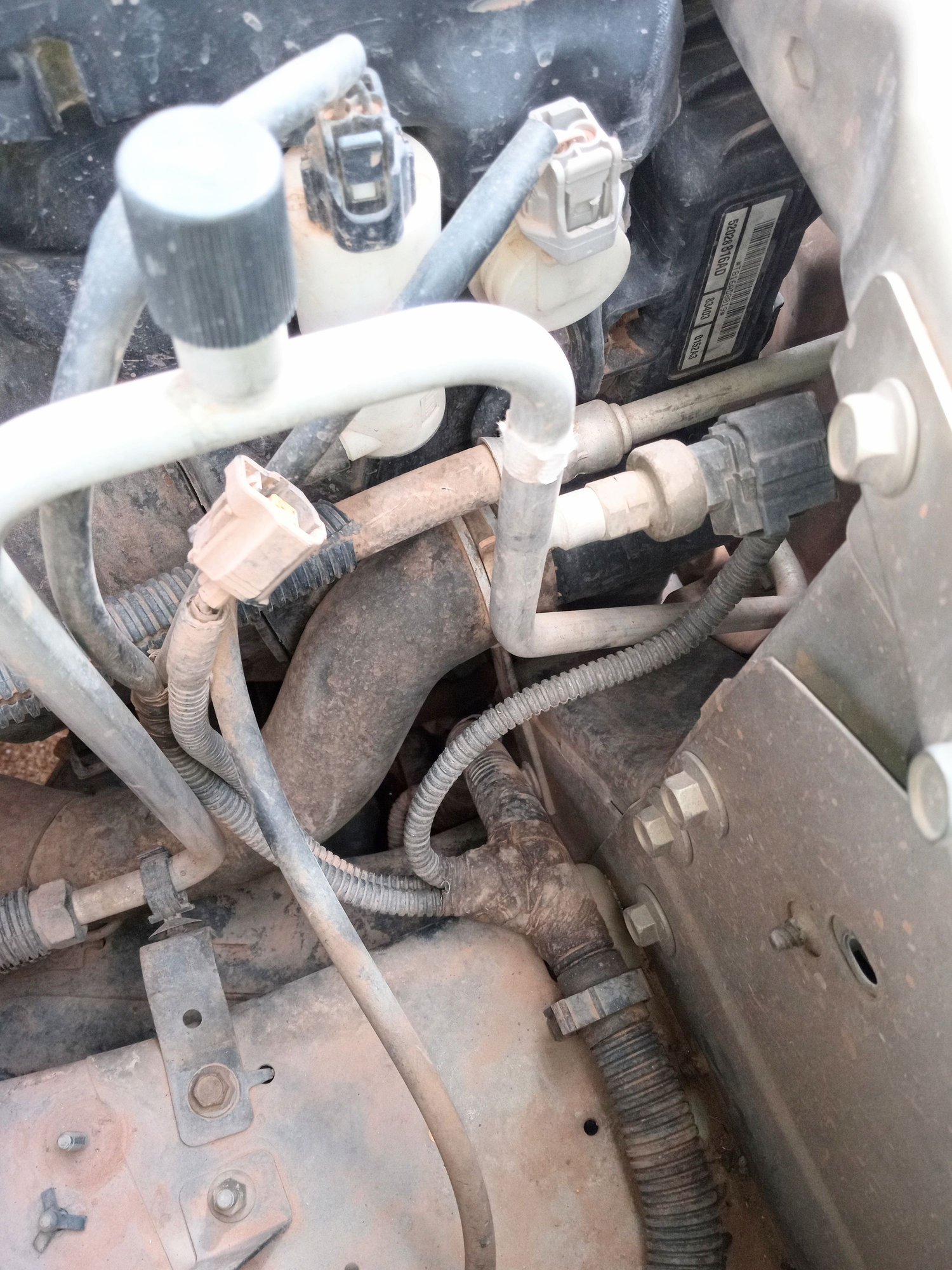

2002, 3.9 SLT automatic, quad cab-Been trouble shooting a nobus code. Found this connection disconnected resting on the frame below air filter. It's a short wire so can't go much much further than where it is. Can't find a hookup for it. Is it supposed to be connected somewhere? Thanks.

Does your truck have fog lights? If not, it may be an unused connection for that option.
No fog lights. That's probably it- Thanks

Smack! There are fog lights that are hooked up and working.
The connector in question is part of the wires plugged in to the computer nearest the front of truck.

a 2-wire connector is going to be a switch or a temperature probe. What you are seeing as "short", I am seeing as "fell down".
Is there an ambient temperature sensor on the radiator core support on the front of the truck, between the radiator and passenger headlight?
If yes - Is it perhaps missing a connector?
If yes - do you have the overhead computer display?
Thank you.
Not seeing a connector, no overhead computer. I see only three connections in that area- all hooked up. Looked for a lose lead hanging in front and on top- nothing so far. The lead off the connector in question is short. Pulled the air filter box nothing there either. I hope this pic shows a better picture. Thanks all.

Entirely possible that connector is simply for an option your truck doesn't have. Dodge did a lot of that....
Get a factory service manual for your truck. There is nothing better for tracking down odd problems.
Thank you. Would it be a good idea to cover end of that connector so no moisture gets in?

I just went and checked mine. Confirmed it's the outside air temp sensor. since you're doesn't have the smart overhead computer, you don't have the sensor on the core support.
