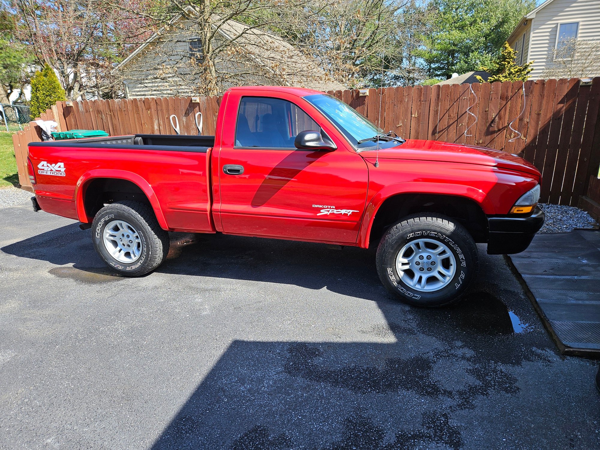

Hello I want to install a new automatic transmission pan with a drain plug when I change the fluid.
(I recently bought a 2003 Dakota Standard Cab 4x4, 111,000 miles.)
How do I tell what automatic transmission is in my truck? 42RE or ???
Thank you...
kd

Nice lookin' truck. That appears to be in really good shape.
Get a build sheet for your truck from here. Should tell ya what trans ya got. (case sensitive, use all caps for letters.)

I don't think 2003 had the 3.9 V6, so it wouldn't be a 42RE. I could be wrong on that though.
If it's the 5.9, it's a 46RE.
If it's a 4.7, it's the 45RFE later re-named 545RFE.
If it's the 3.7, it's a 42RLE.
Looks like it has the torsion bars cranked and 2" spacers on the rear axle. If it rides a little rough, that's probably why.

Thanks for that... great info to have. That tells me it's a 42RE A/T. It also says the truck is an SXT.
I appreciate your help!
