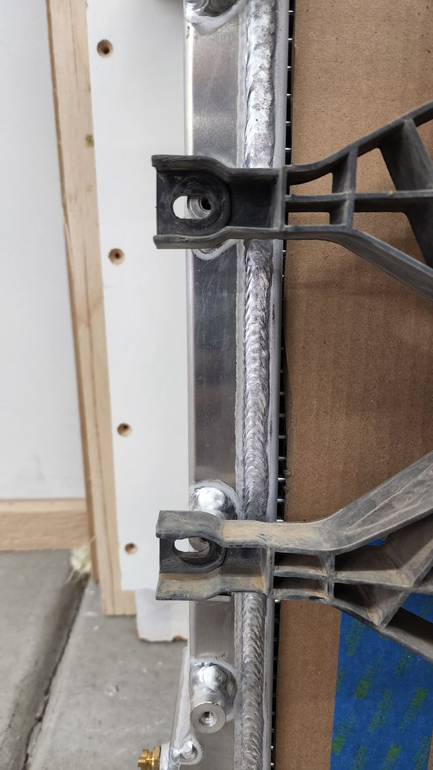

Wow, this radiator is worse than I could have imagined.
Brackets aren't even close
Fail on the lower fan shroud
Fail on the fan hole alignment
Fail on the evap hole alignment
The only thing that does line up is the upper shroud.

Good ole Chinese QC. Send it back and get the CSF.

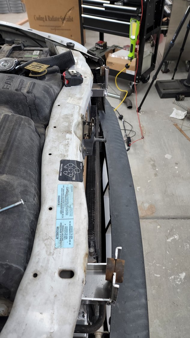

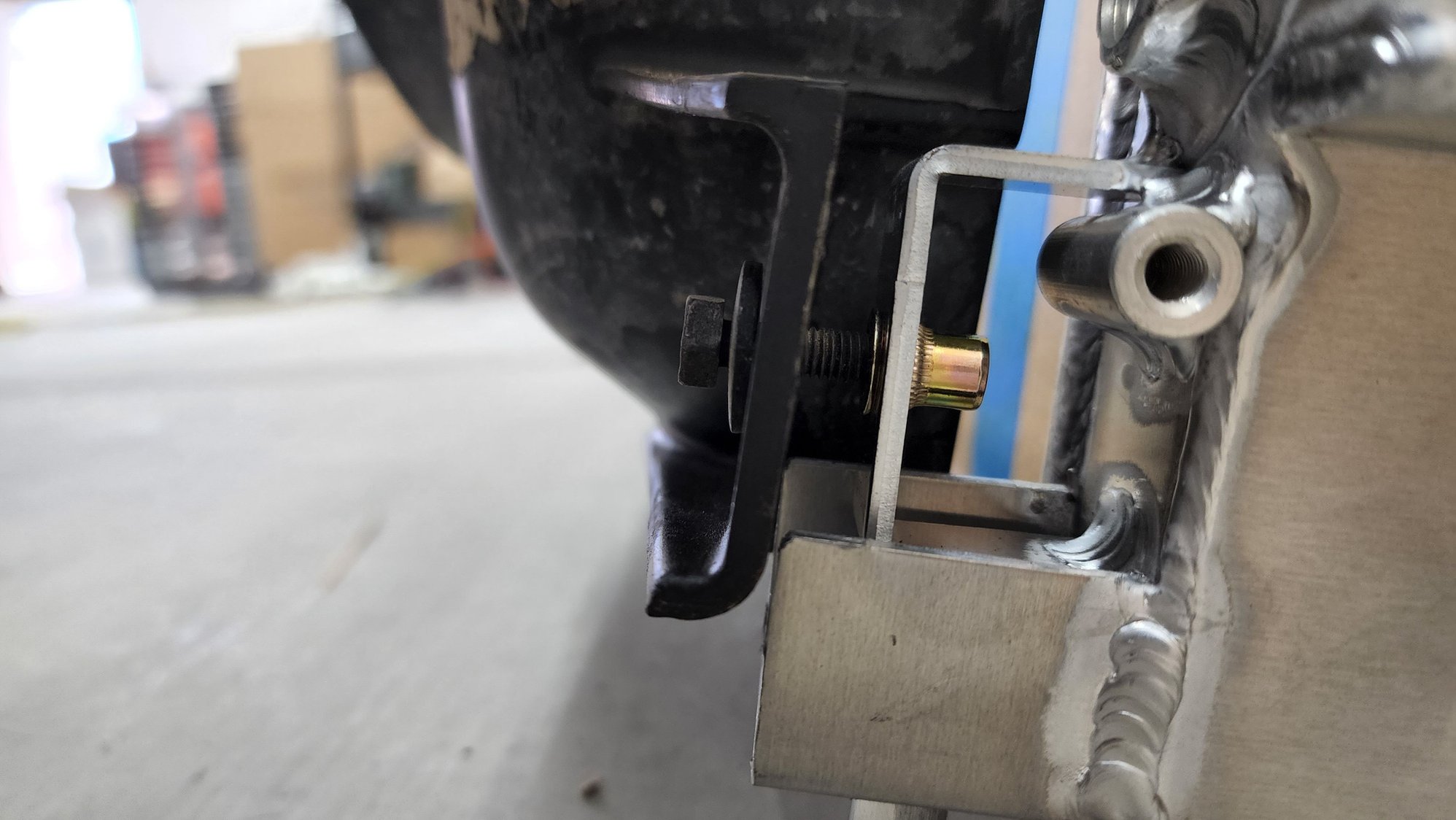

Finally got it all back together. Did a bit of fabricobbling on the rad to get it to fit in the right spot. I'm just ecstatic it didn't leak.
Part 1 -
Part 2 and 3 (and maybe 4 if needed) coming.
