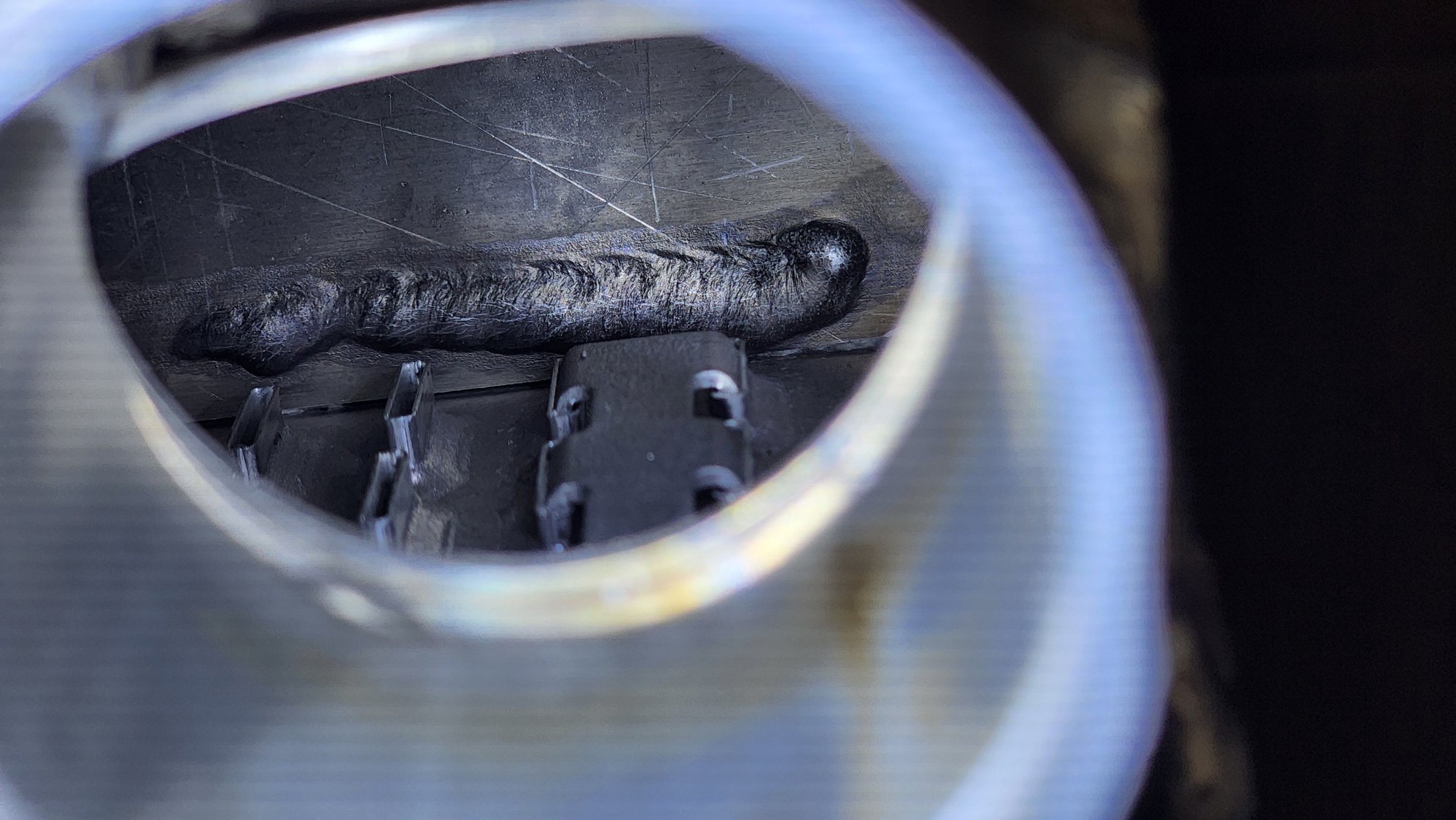

I ended up going all in for the 4 core.
Certainly not the best specimen of aluminium welding.
I found it odd that on both sides of the top 2 rows, they have some sort of metal piece mostly plugging the cores.

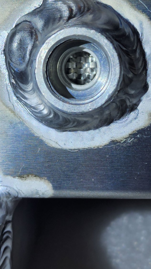

The thing I was most concerned about was what kind of tranny cooler they were using. Seems to be a pipe with some sort of expanded metal in it. (I stuck a borescope in the end tank)
At first I thought they left machining swarf in the hole, but whatever it is in it is rigid. I always assumed the OEM radiators used some sort of stacked plate heat exchanger. I wonder about the effectiveness of this one.
I was on the fence about adding an external cooler, now maybe I'm on the side of doing one.
