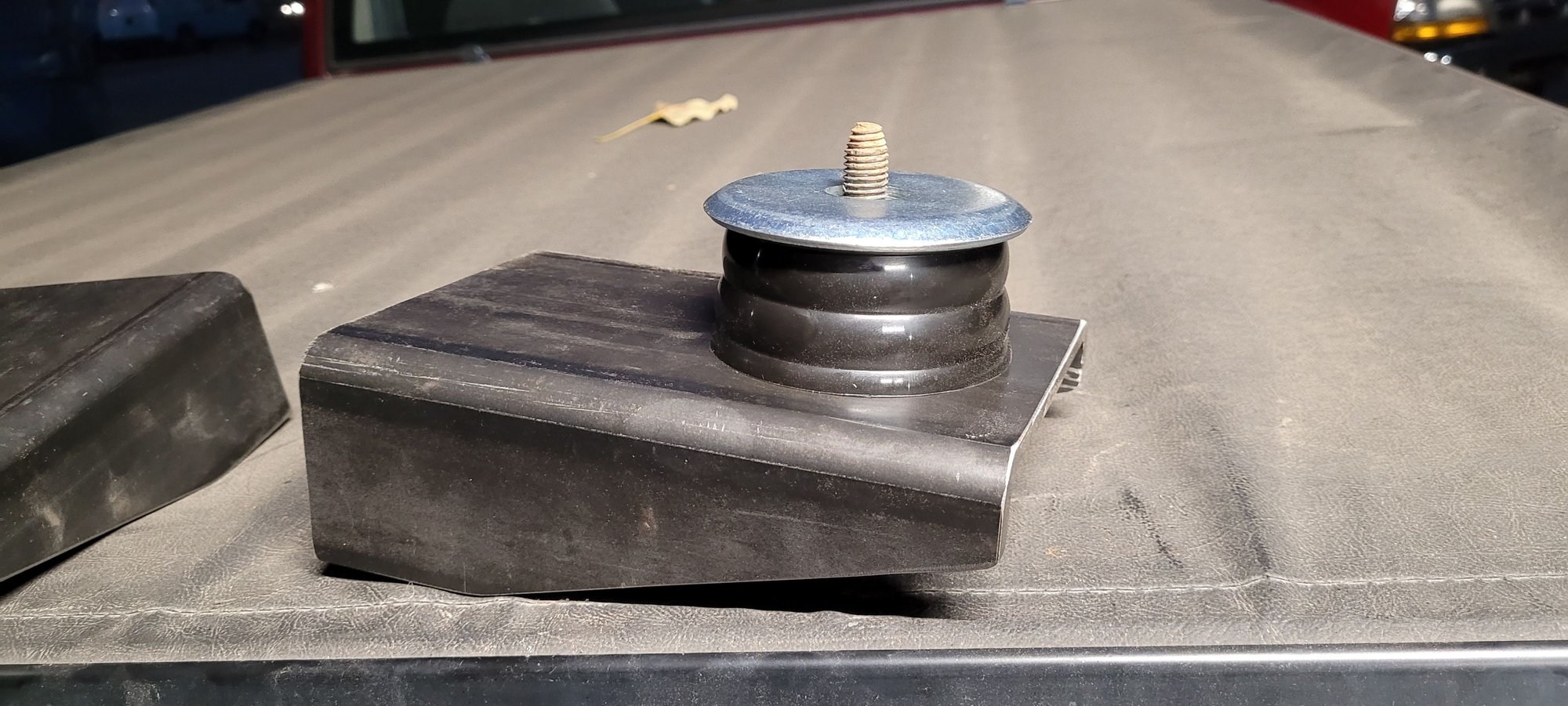

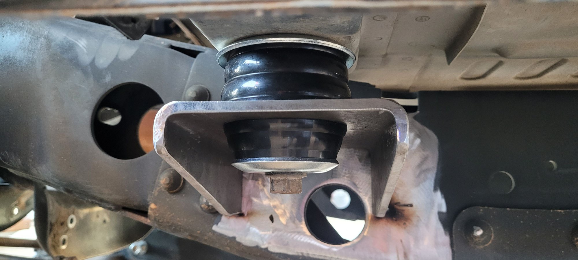

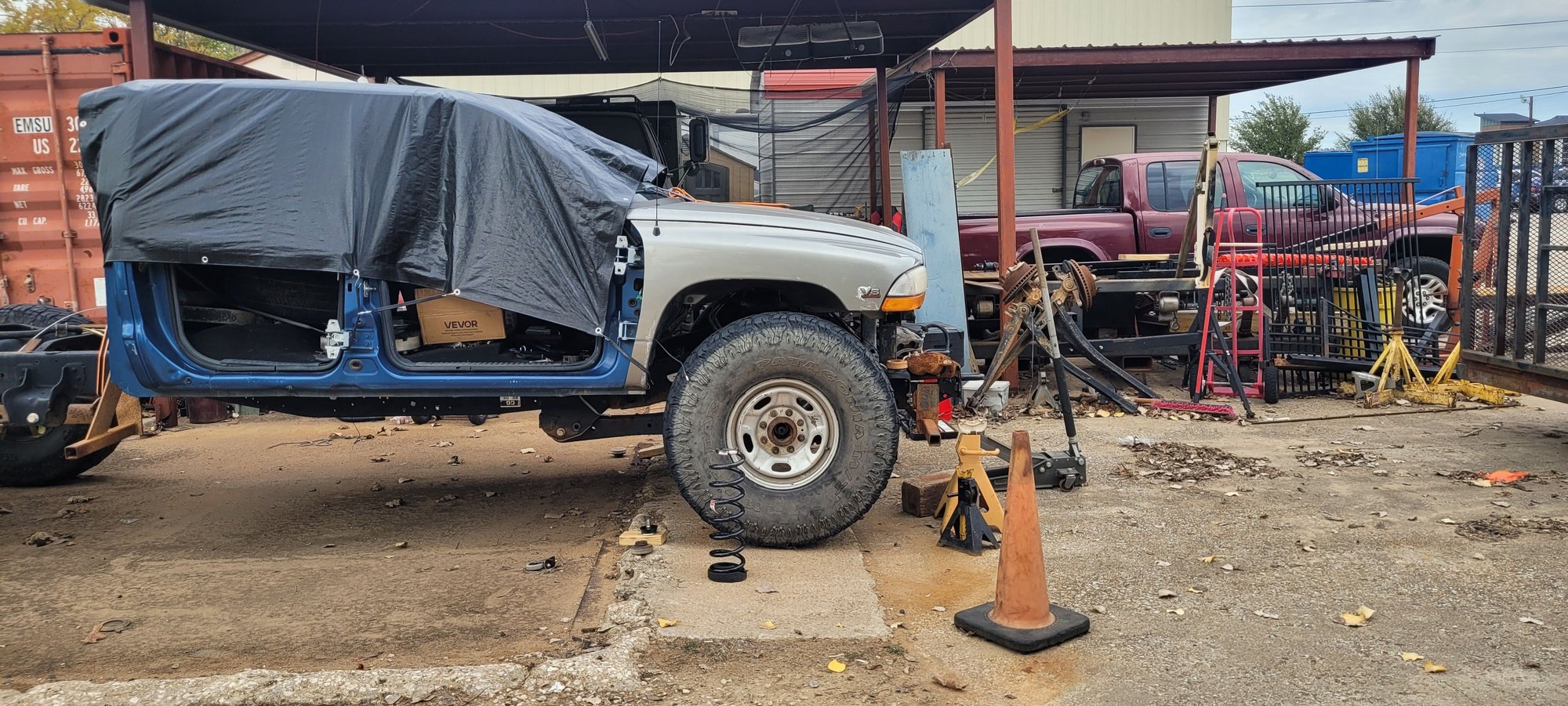

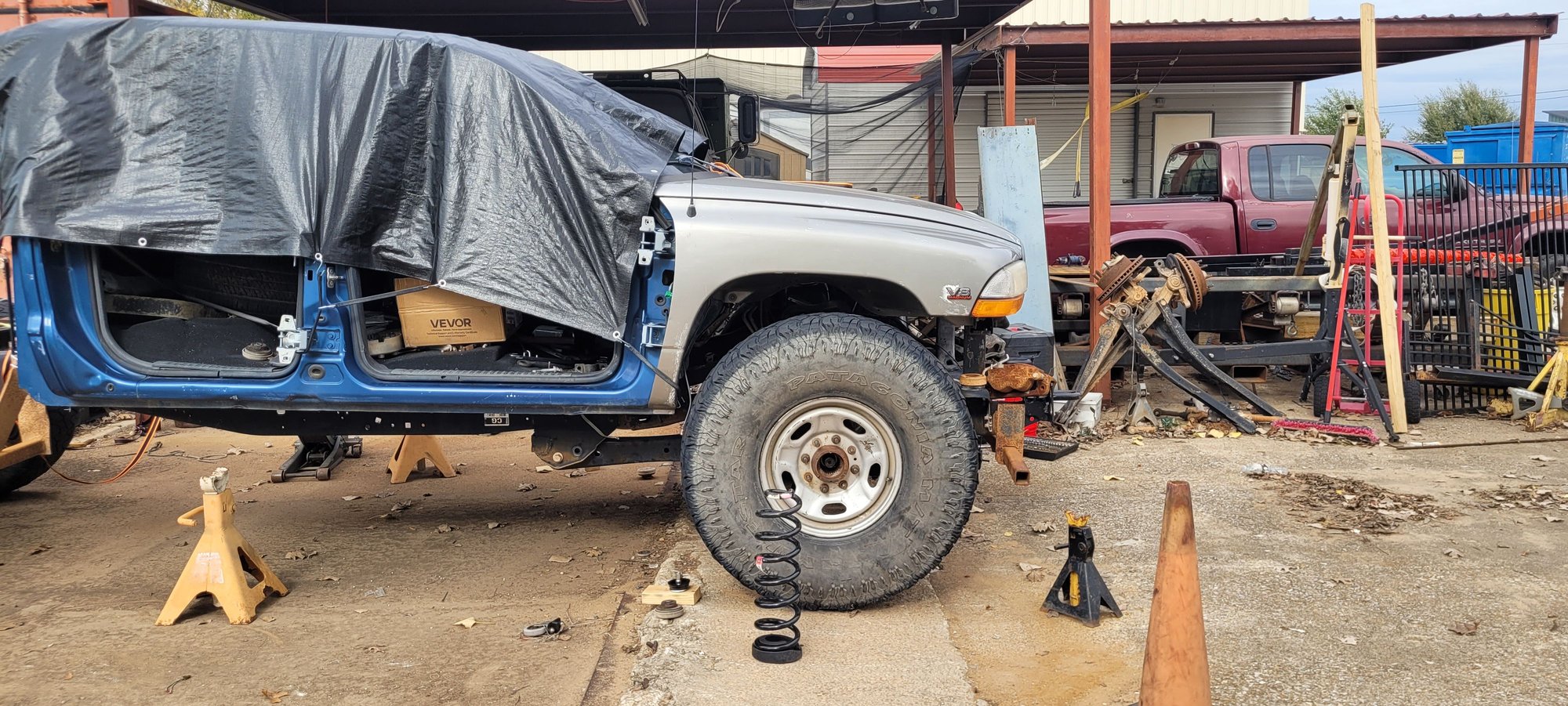

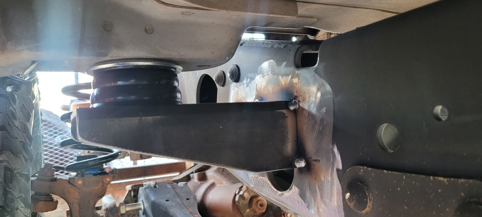

Been slow going with family but was able to get a little done. I adjusted front axle in the wheel opening because at full bump the wheel was a little far forward. With the wheel past full bump there is no rubbing from lock to lock except right at lock where the rear inside of the tire rubs the radius arm.
After the cab location was set I cut the frame cab mounts off and built new mounts out of 5"X3" 1/4 wall rectangle tubing. I drilled out the hole for the body mounts and then cut the profile for the mount. We are trying to keep the ride height as low as possible so I set the cab as low as I could without worrying about rubbing when flexed. Next step is for my son to weld in the cab mount, after they are on solid we will be chopping the front of the frame rail. We need to do this to make the frame line up with the core support mounts.
Before
After moving the cab forward
Approximate ride height
Cab mounts

On Christmas eve we were able to get the cab mounts burnt in. My son has done some small welding with me and this was a good chance for him to get more experience on his truck. He welded the flat section of the body mounts and I welded the verticals but first we had to get the frame low enough to get access to the top side. We jacked up the cab and then put stock wheels on the front to make some room.
A few pics of him burning wire.
The only pic of his weld that I remembered to get... He left a big gap between the tack and his bead, the bead looks pretty good and we ground the tack down and feathered the bead some and tied them together.
​After getting everything welded up we set the cab back down and centered up, then he got to "drive" it some as I pushed it back into its spot.
