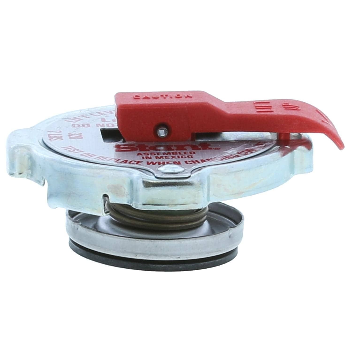

I wanted to know which pressure on the radiator caps others use on their 3.9 6cyl Dakota..I'm noticing with a 20lb -the reservoir looses fluid often but it's full under the cap..an with a 18lb the resivoir stays normal but at the cap there's loss of fluid.
Both are new caps ...An it's been burped

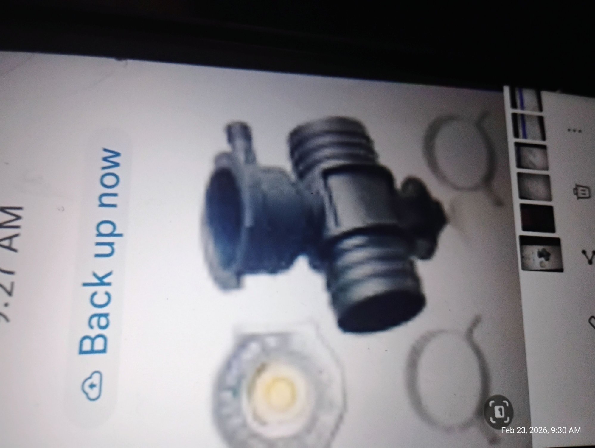

Not that I can see .I had ordered,an installed, a new part that joins the 2 hoses with the 1 new cap that all came together w the 18lb cap on it. ..the 20lb is new too an has a release on it, I think it's a auto zone one
...maybe additional air is still there ,but if so I'd think the stant would not show full as I remove cap.
I did a combustion test also(I was curious )-an it's fine .all blue .

Rent a pressure tester and test it. Are you bleeding with the front up high? I usually jack my front end up all the way. The system should take care of the rest of air anyway. It self bleeds as the engine heats up and cools. That neck looks like the one on my 4.7.

Yes,I raised the front as burping the system, even to the point the level overfilled the funnel .
I will put a different pressure tester on it.The last one was making a spewing sound where that tester
​​​cap meets the new filler neck piece...

My cap is 21 PSI. Yeah, you need an airtight seal and once you pump it up, it should hold the pressure steady for X amount of minutes (google this). If the test cap is sealed good and the needle drops too fast, then you have a leak. Best to do with some fresh cardboard underneath and in a quiet garage if you have access. It took me a few tries using one before I struggled and bit with the correct fitment for the tester too. Finally figured out that I didn't need the adapter portion. Some info and pics in this thread... https://dodgeforum.com/forum/2nd-gen...loss-4-7l.html
Do one of those VIN searches on a Mopar site for the cap and see if you it tells you the PSI there. If it doesn't, google the part number from there, then click on "images" to view all pics.

I got a different tester an at the neck it's holding good there ..Oddly both new caps are showing a slow slow leak..the 18 an the 20 ..I'm gonna try another new cap an test it It's odd for both to show leaks ..would you go 18 or 20 ? An would you go with the one that has the release or are they more prone to leak?
It slowly lowered no matter if at 18 or 16 or 20

You know what I tried..In store on 4 caps- new -not 1 held continued pressure !
Of course it took ,what 50 seconds ,but slowly dropped on pressure - !
An only those same 2 brands 20lb were the in stock ..yes very weird .It's possible that middle, cap adapter piece, on the test kit has a extreme small leak too but rare.
I got a Murry 20lb without the release .
Do those pressure testers loose air easily when it's connected on the direct cap test w adapter?
When I did it on the new filler neck ,normal level of water ,it stayed on the 18 I pumped it to.
Do the tiny tiny tiny bubbles ,that may not have got burped out, slowly get released from a long drive? I went 100 miles on it a few days ago ..I can try a reburp too .I'll recheck hoses also.
Interesting that I need a 21 lb an stores don't carry them ..I guess staying w 20 is ok then?.
