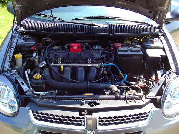

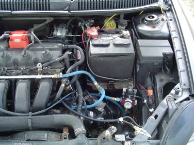

Any line having to do with the turbo is not a vaccum line. Your termonology is off. Lines to the WGA or BOV need a "boost" referense in order to work properly. CIA or brake vacuum line will never see any positive pressure resulting in your WG and BOV not working.
Size:  27.8 KB Name:  DSC01518.jpg
It's hard to tell from my photo... I suggest the wastegate have its own boost line. I also suggest this come from the intake manifold if possible. BOV referense should be after the TB.
As much as i did not like the guy above me yelling in all caps, he does have a point. If you don't have the slightest idea of anyting i posted you do need to uninstall your turbo kit.
