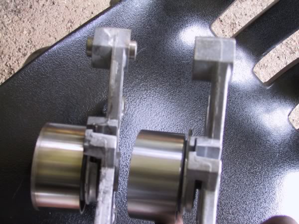

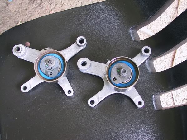

Is the timing belt rubbing the inside of the timing cover? Was the bracket reused? There are two different brackets. One has a sleeve of sorts going through it, for alignment I guess, and it could make the belt stick out just too far if it shouldn't have that bracket.

Not sure which bracket you are referring to. I believe the tensioner came with a bracket. This kinda leads to a suspicion that I have had all along, that Chrysler provided the wrong parts. And yes, all parts are strait from MOPAR. Wouldn't be the first time the local dealer has screwed me.

Here are the pics someone else provided me of the bracket differences I'm talking about.
