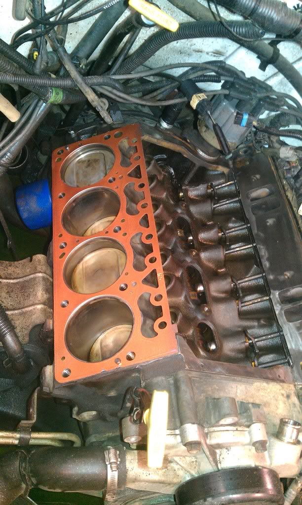

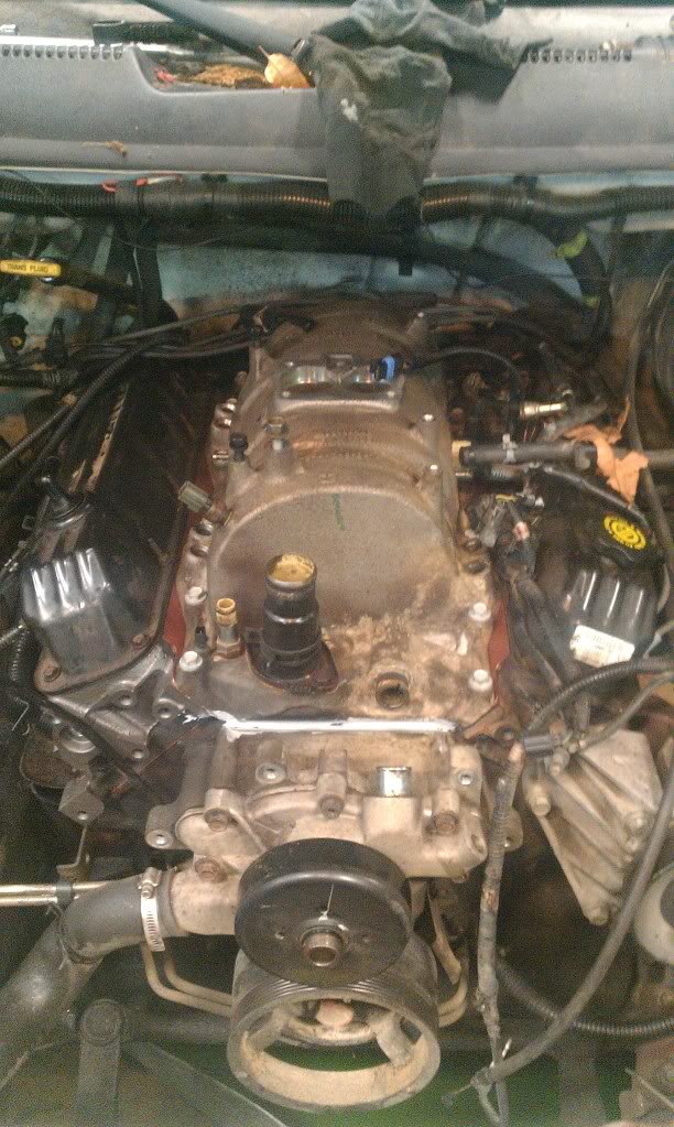

This is where I'm at now. Still hoping to get it all done today. I'm coating all gaskets with copper coating to ensure a good seal on my maybe less than perfect surfaces.

Aside from the usual high-mileage varnish, she looks clean! Dino oil or syn?

Is that a brand new head or just a very well cleaned one?

regular old dino oil kept it that clean, just well maintained. Brand new head. Good news, i got it all done and drove it home. Bad news still no change. cyl 8 misfire is still present, im at my wits end with this one. the only thing left would be piston rings but it has almost 190 compression. im going to go back through the ignition system, but everytime i hook up my spark tester its got good spark.

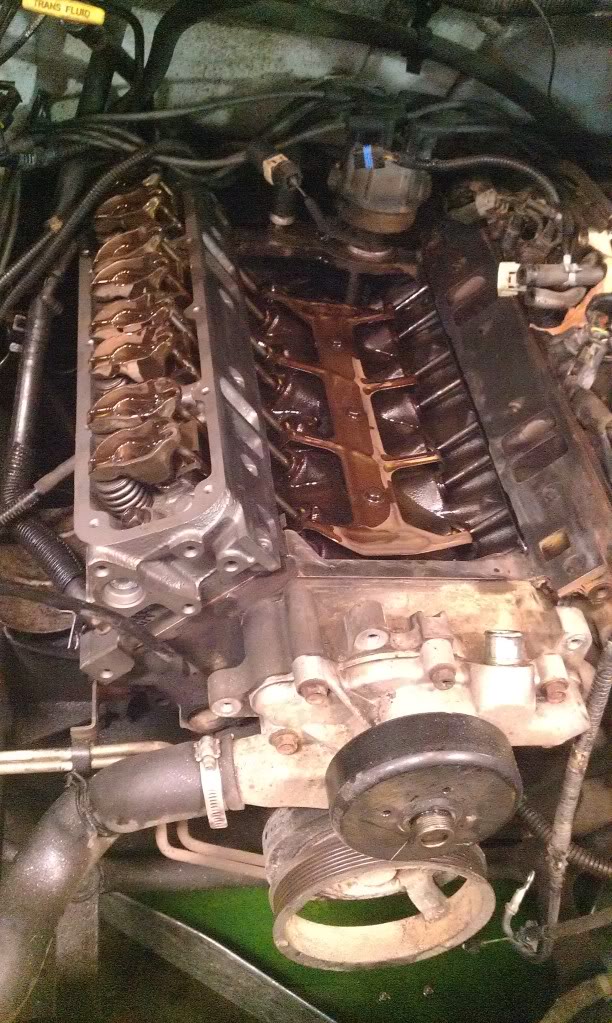

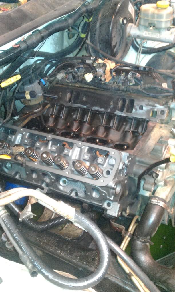

I forgot pics earlier so he is some for the pic ******.
