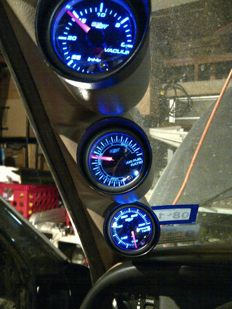

Installed gauge pod and gauges.

thats awesome how hard was it to do?

gdstock... i would pay to have them gauges. with all wires marked to were they go.... i want some like right meowwwwwwww......

With the wiring set (an optional part from Glow Shift) you run one set of wires with 12 v power, ground, memory 12v and one set of three wires for instrumentation to the devise being monitored. Gauges have a four or five pin connector that pulgs in. Instructions are very clear and easy. m If you get vac gauge, then you have to run the vac hose with wires. It is very easy.

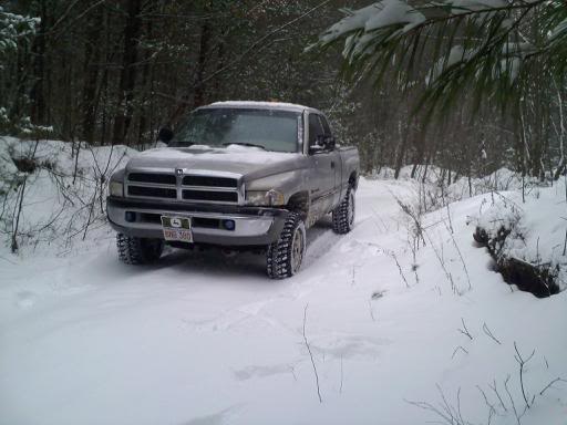

took it out in the woods during the snow storm.

I need these too
