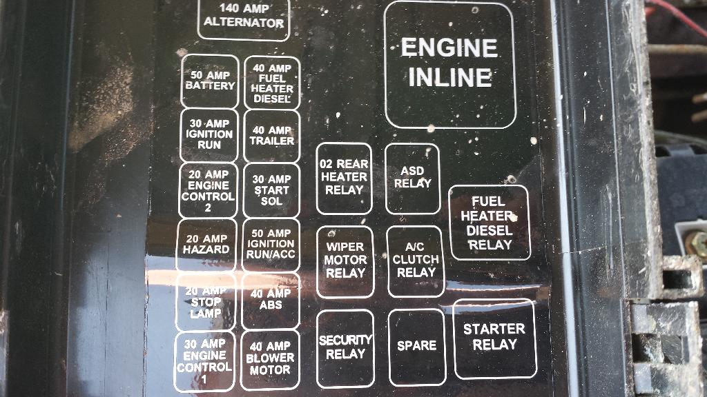

There is a relay in the PDC for the O2 sensor heaters. (I think) Swap that relay with another one, and see if the codes stay gone.
Heyyou you are the man! I went out and checked mine and for whatever reason the o2 heater relay wasnt there but there isnt a socket for it.. however there is also a fuse for the o2 sensors mine was blown. Im hopong problem solved!
Size:  122.0 KBName:  20140416_124122_zpsdqauvj4k.jpg
So ill elaborate on the heater relay missing..
Its impossible to plug a relay into the socket as it just falls in. However I dont have a security system but there is a relay for it. So mYbe its for the o2 sensor heaters...
Now I found that too, there is no plug for the relay. It just falls in. I though someone yanked em or something for some stupid reason, nope just nothin there it seems. Im gonna check the security system relay now that ya say that though, never noticed that before.
