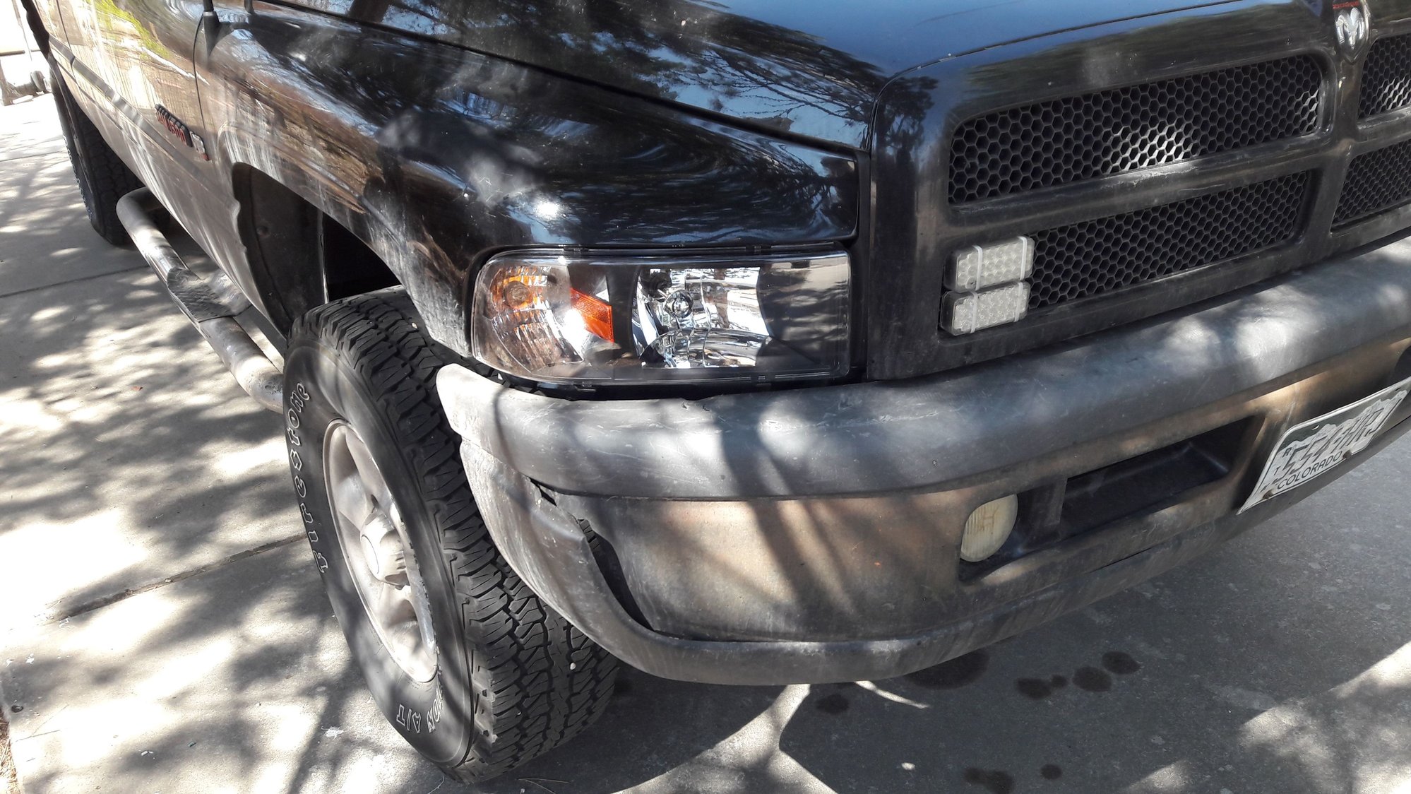

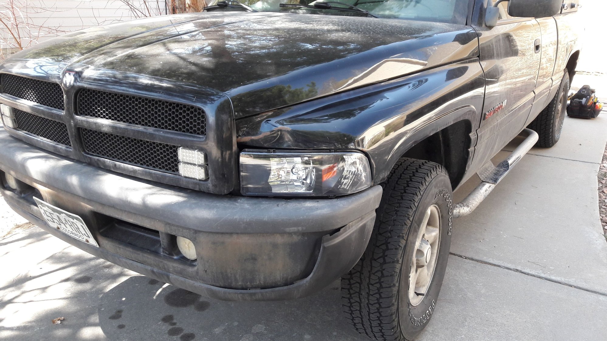

Wired up some new leds above the bumper since the old ones died off. Also found out why my driving lights quit. The switch had loosened so after tracing it back from the battery I was relieved it was that simple.
