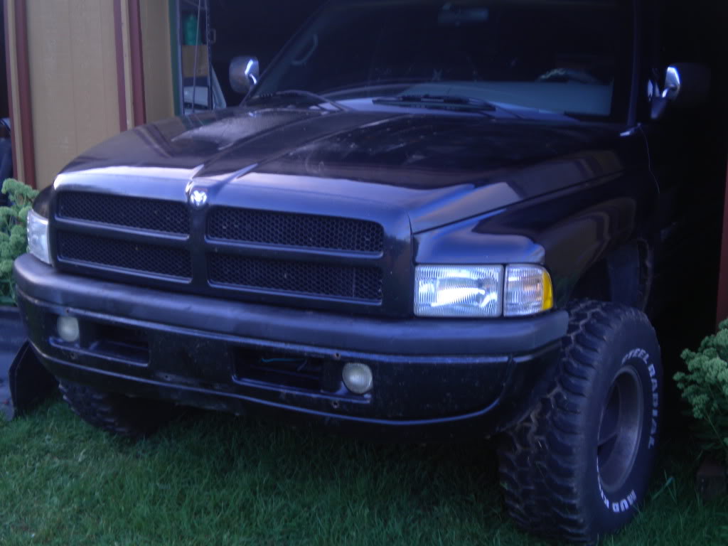

Here is my current Truck

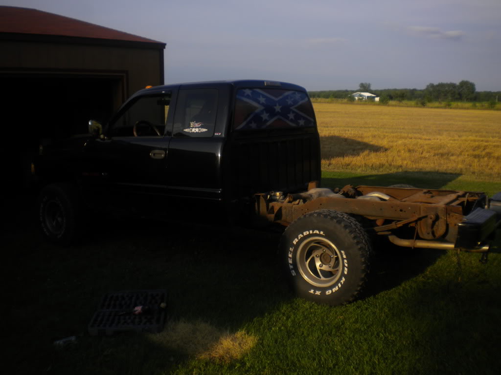

Work that has already been done to it in the past couple of days....
Tailgate and Roll Bar off:

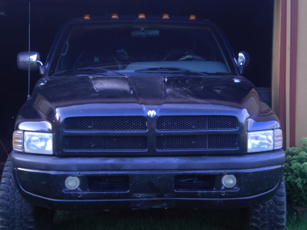

Whips off, man my truck looked naked by this step lol
Name:  <a href='https://dodgeforum.com/forum/vindecoder.php?vin=SUMZER2010JULY155' rel='nofollow' class='vin_code' rel=SUMZER2010JULY155.jpg Views: 45 Size: 98.2 KB" style="margin: 2px" class="post_inline_image" />

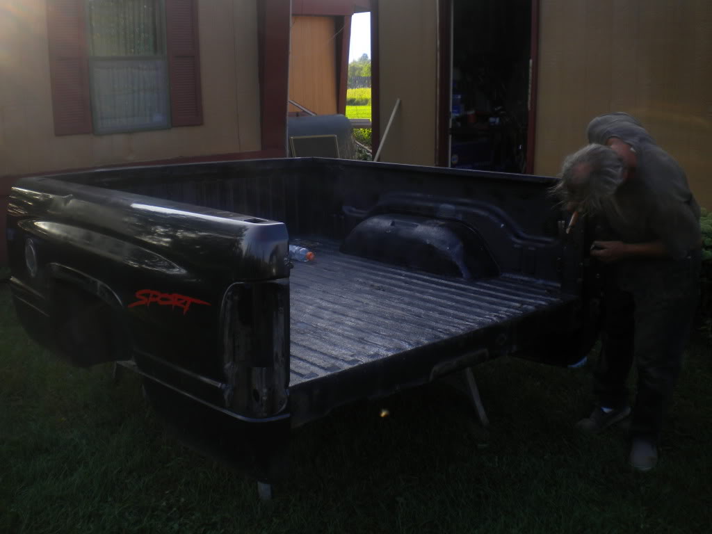

Bed was a PITA to take off. Six bolts hold it on, only two I could get off with a impact the rest was with a breaker bar or ratchet. This would've been a great time to have a torch at the house! But after a bit of struggling broke'em free.
Bed off and on saw horses: (Good ol'Dad even got in on the picture )

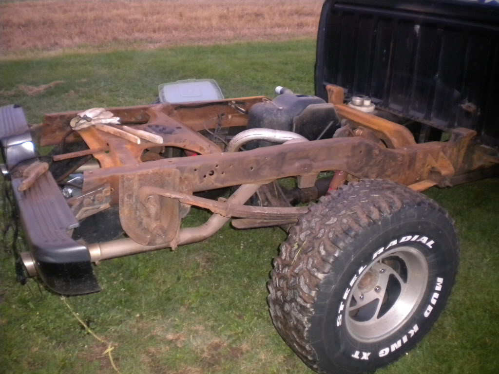

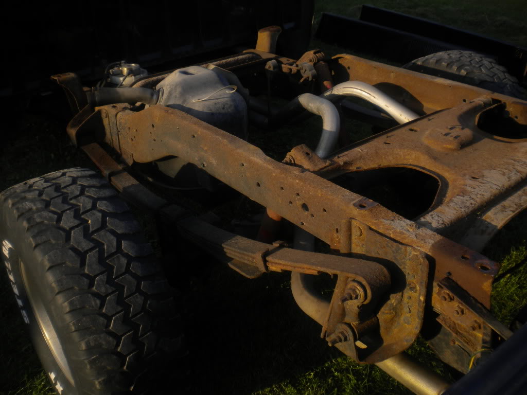

Going to sand the frame, rear axle, and paint it as well. Might use some SEM rubberized undercoating as I can get that at work. Or POR15 it.

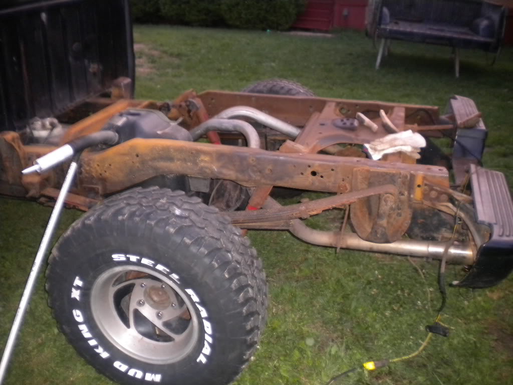

Well tonight I made good progress. The bedsides are completely off now! Woohoo!! What a b*tch they were but finally they are off. Got the frame and rear axle and leaf springs sanded and ready to go for POR15. Need to get a nozzle for the metal ready spray and tomorrow night I will be laying the POR15 on it. On to the pics.
Here is what the it looks like with out bedsides.

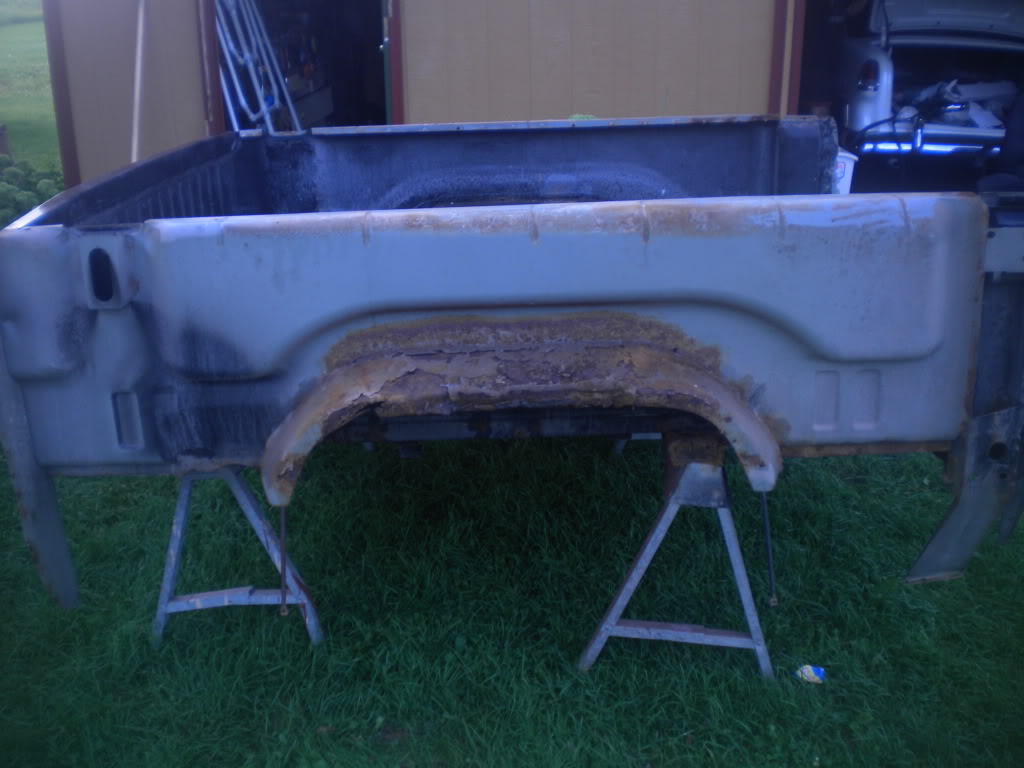

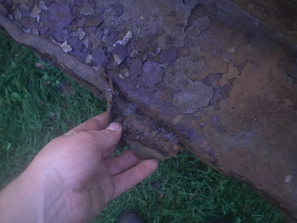

Pictures of the old bedsides... pretty nasty.
Name:  <a href='https://dodgeforum.com/forum/vindecoder.php?vin=SUMZER2010JULY186' rel='nofollow' class='vin_code' rel=SUMZER2010JULY186.jpg Views: 61 Size: 182.5 KB" style="margin: 2px" class="post_inline_image" />
Perfect example of why the wheel wells go to hell on these trucks so fast. Look at this foamy, glue crap that is on the inside of the wheel well.

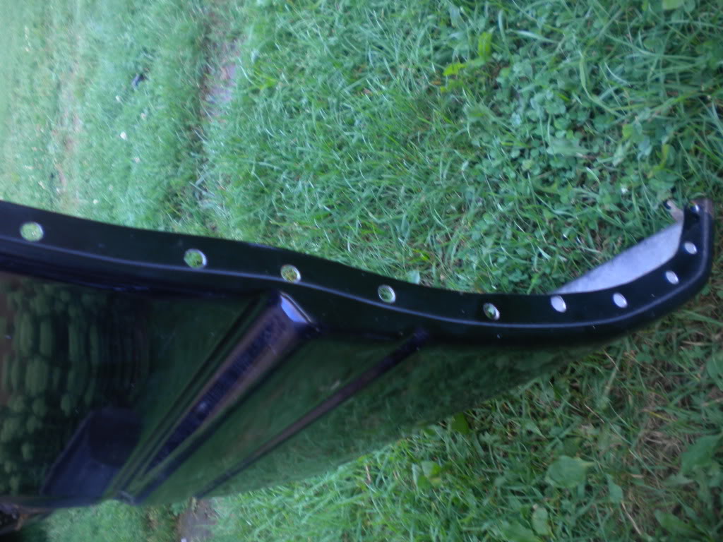

Some pics of the spot welds:

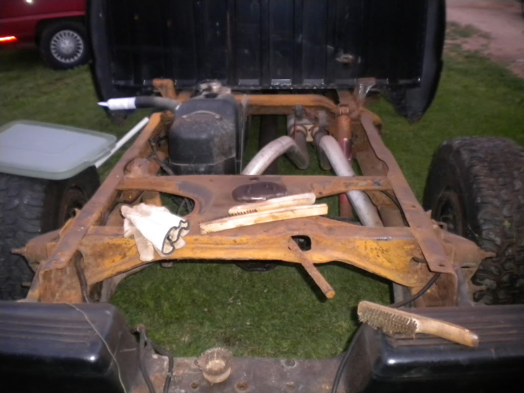

Started wire wheeling, brushing and sanding the frame for POR15

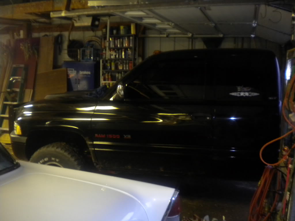

Backed the truck into the garage so I can work on it after dark. Boy she sure looks different lol.
