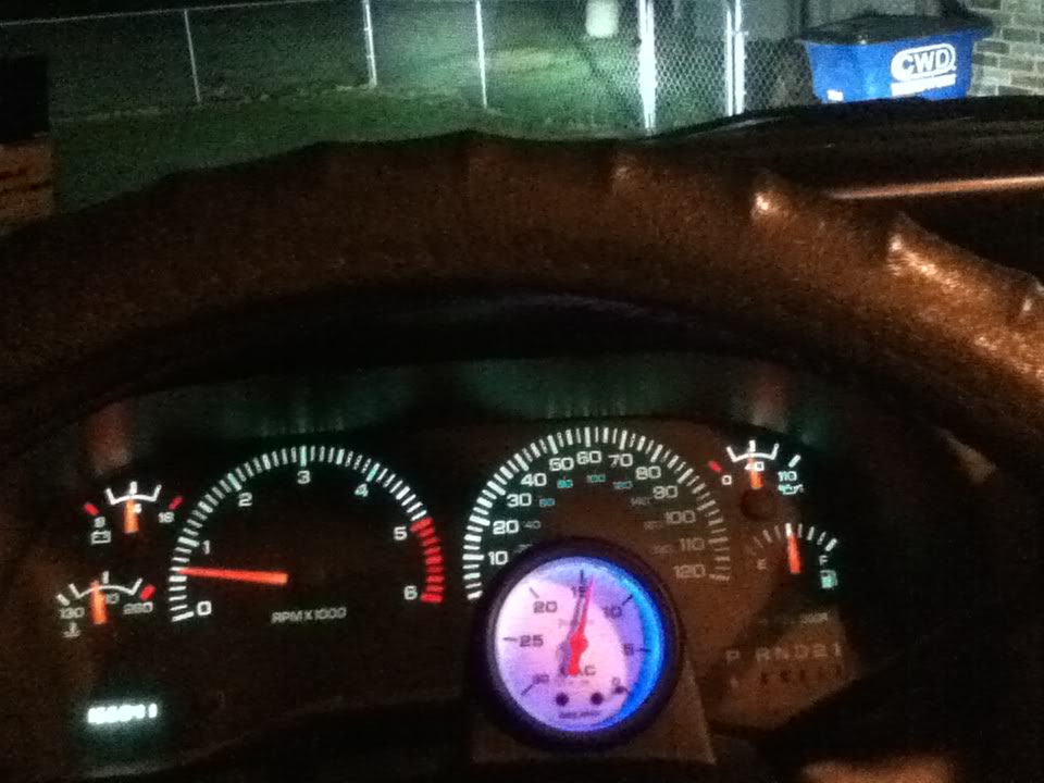

When I installed the gauge, I accidentlly bent the nylon tubing when trying to wire it throught the firewall and stuff. I was mad but ohh well. That's what it reads at idle....I get about 300 miles per tank full. After the install i noticed that when i drive with O/D off my vacuum is higher than driving with O/D on, even on the highway. So Im going to do a test run and see if i get better mpg driving with O/D off. I run about 2500 rpm on highway with O/D off going about 65mph - 70mph.
Reply 0
