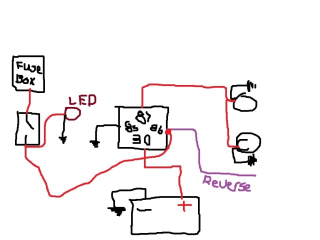

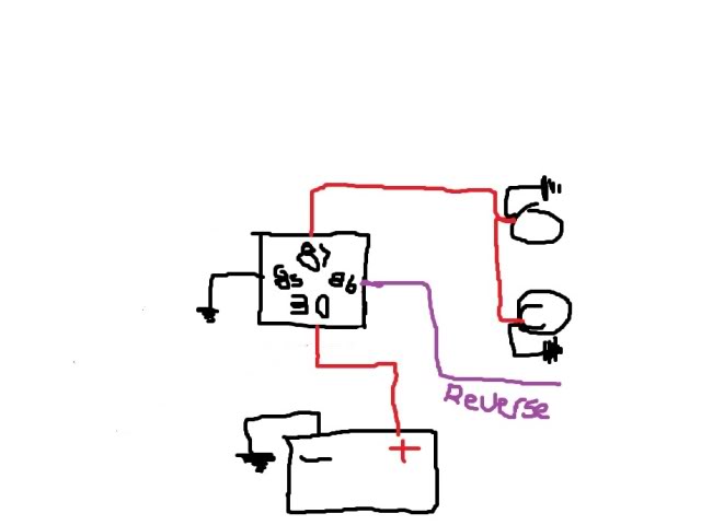

i have a wiring question. if i just added a switch just to turn them on manualy but still have them go on with the stock reverse lights couldnt i just add a switch into the 86 terminal(switch) of the relay and keep the stock reverse light wire in that? so basicaly on they are on off they will only go on with the reverse lights?
Crappy paint pics
How it is now

with switch
