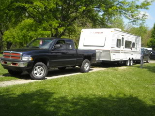

I see your 2400 pound boat and raise you a 7000 pound camper
