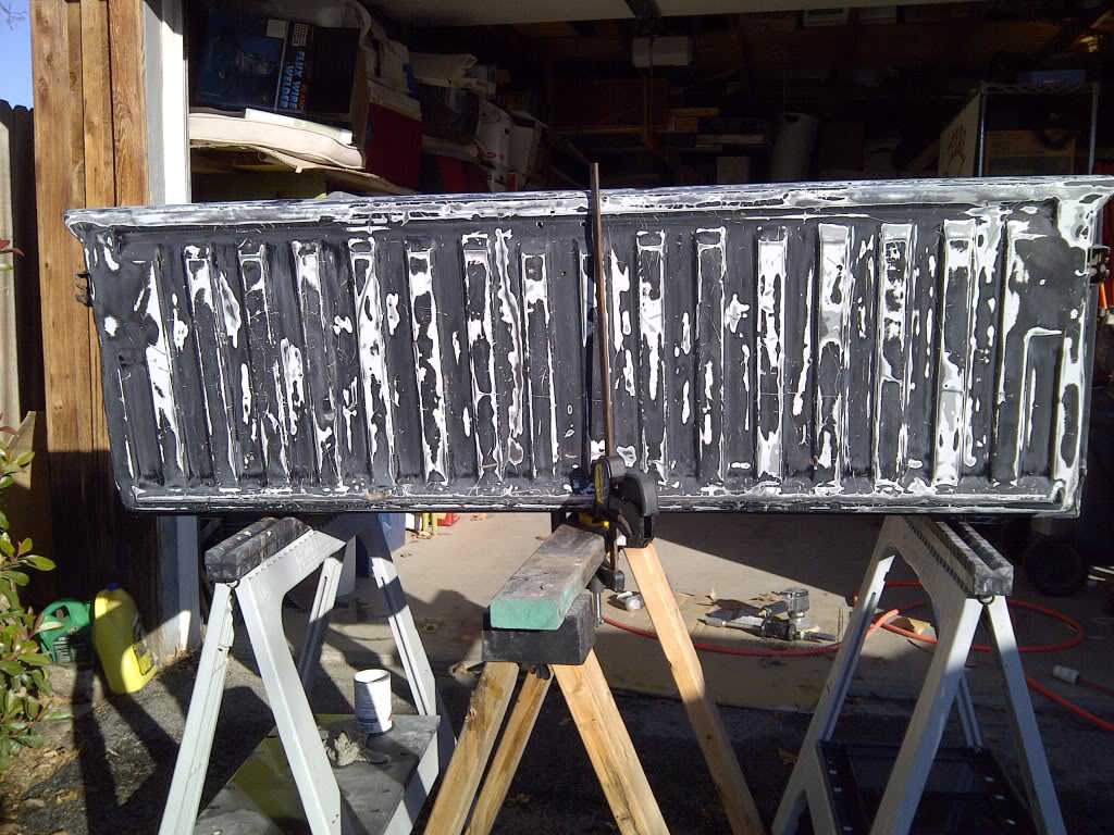

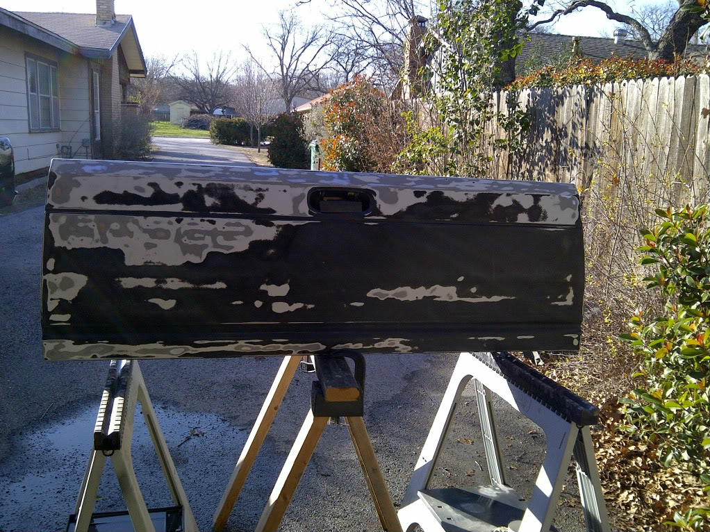

Removed rear door windows and sanded the part under glass to allw painting to edge. Also removed plastic trim form tailgate and sanded it down and pulled dents from top edge of tailgate. Won't fill these as the liklihood of chipping off is too high, but wanted to pull metal back into place and work back into place. Then sanded tailgate on both sides and all edges.

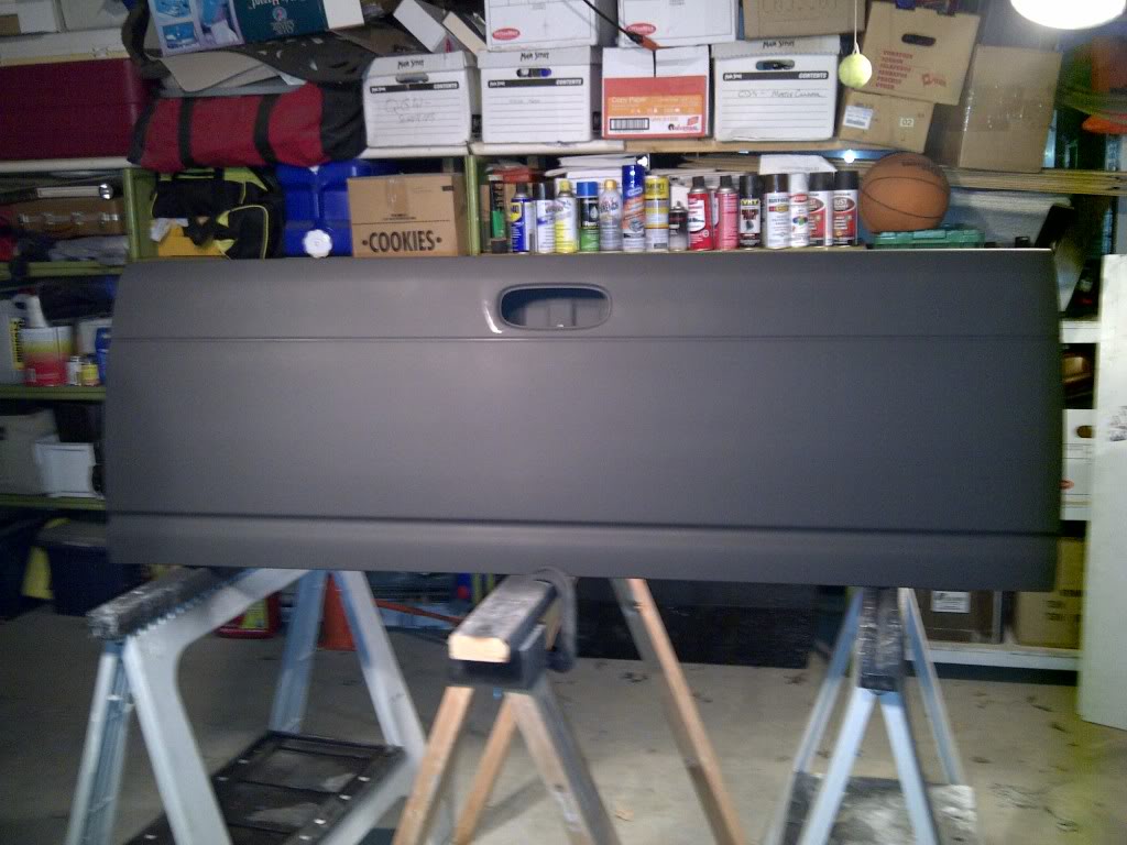

Primed tailgate with etching primer. Inside of bed will get liner.
There is a small run just to the left of the handle opening. I am assuming that I can wet sand it off with 1000 grit sand paper before laying 2K primer on?

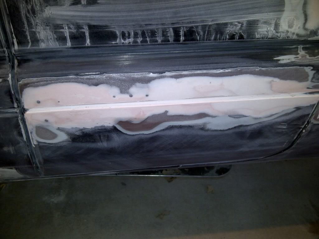

Still struggling with getting the small groove in lower panels smoothed out like I want in rear driver side door. If I cannot get it correct I will see about getting a door at a JY. This is proving more challenging than I thought.

Still trying to get the lower groove below the moulding on the quad door just right. Either too sharp an edge or not enough. Filled edge again tonight and will fashion a straigt edge guide to run a grinder the length to get correct radius tomorrow. May hold strightr edge against door with welding magnets.
Don't have an opportunity to check JY this week and on the road for work again next week. If I cannot get it like I want it this weekend I will probably go ahead and prime rest of truck and try to get another door next week or may take to a body shop to see what they would charge just to fix this area.

Got the groove in the rear door on passenger side "almost" perfect. Still have a little more to go to get radius correct, but almost there.
