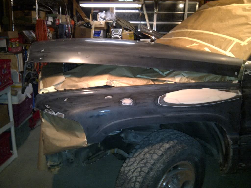

Got cab washed and masked today.
Engine bay masked:

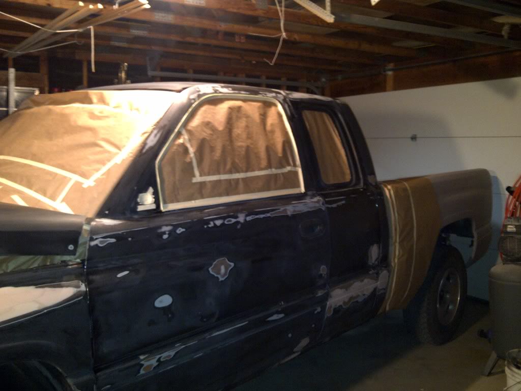

Left side masked:

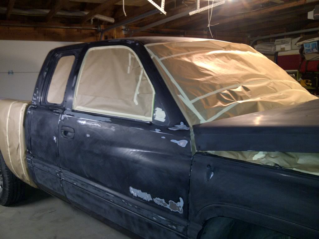

Right side masked:

not much left now. when you shoot your first coat of primer give the areas that you sanded down to metal 2 coats first then shoot the whole truck. this will prevent 'bulls eyes' and block out a lot nicer. are you going to rent a booth or spray it in the garage

I will shoot it in garage. I left for work this morning before my wife - I'm sure she was not happy when she found her car sitting out in the driveway this morning! But after masking all the glass, I couldn't really move truck - it is parked kind of crossways in garage so I have room on all sides! I am shooting all of it with an etching primer with adhesion promoter - 2 x on bare spots, then 3 coats 2K primer all over. I think the sanding is the worst part of the task!

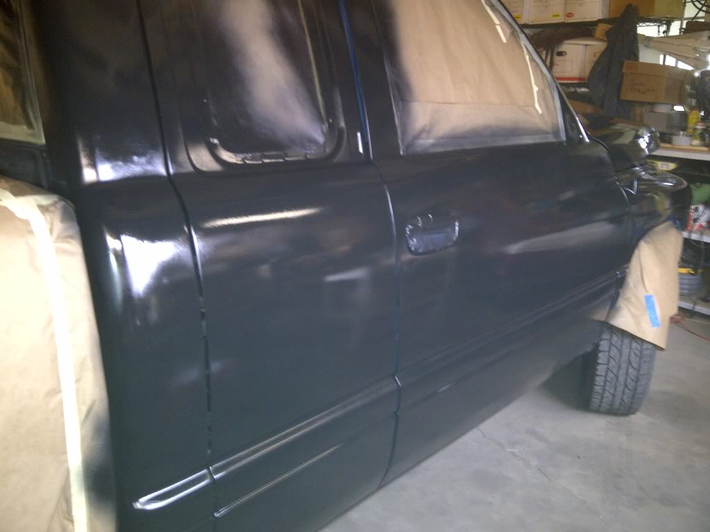

I was able to get out of the office at noon....but damn cell phone keeps ringing!
Wiped cab, hood, and fenders down again with wax and grease remover to make sure it was clean. A little dust form sitting in garage overnight.
Got good coat of etching primer down. Witing to dry to shoot 2K.
