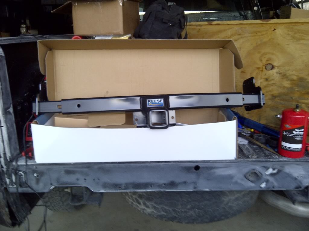

Also picked up hitch assembly for truck to be installed. Will have brake controller and tail light relays installed as I complete body work. Another cold and wet weekend coming up, so wiring and hitch work will let me get something accomplished - looks like it won't be paint again this weekend.

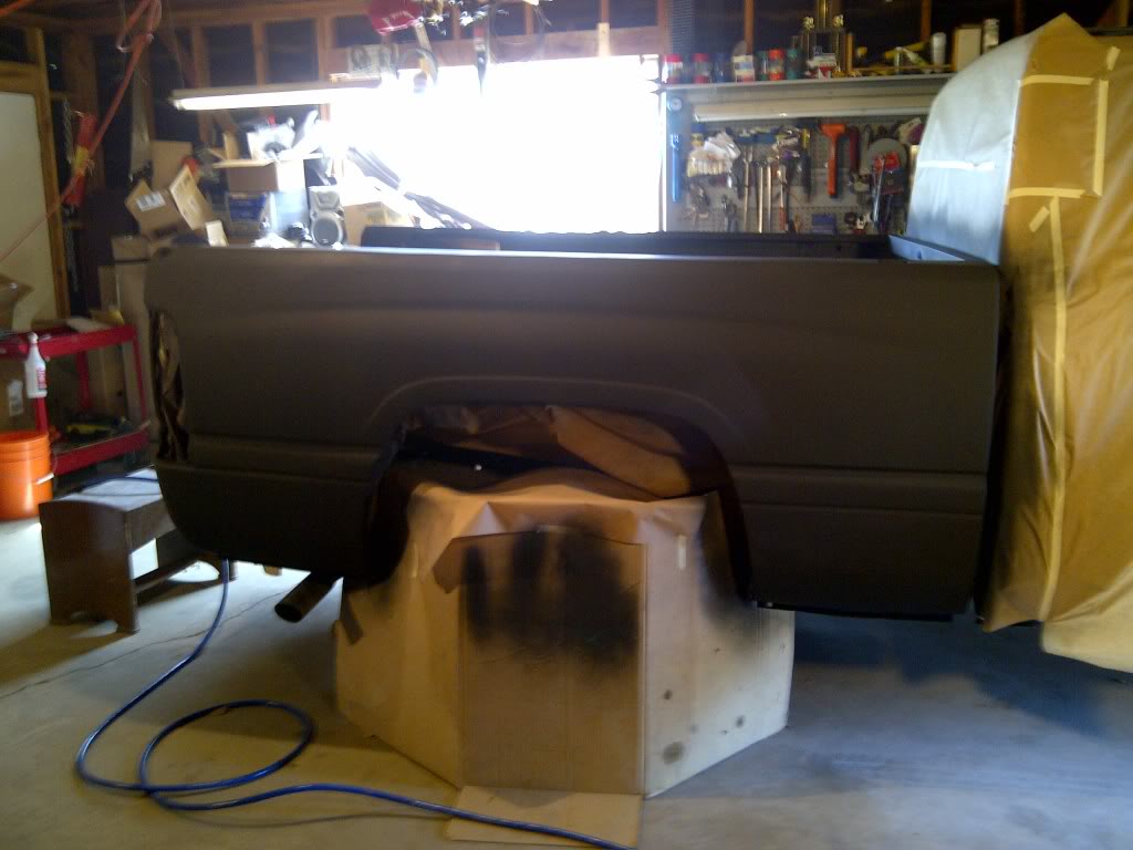

Weather is decent and I cannot think of a better way to use President’s Day than to start painting!

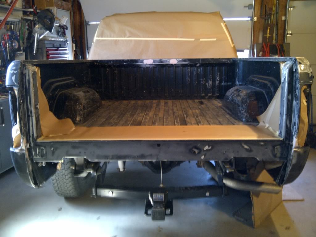

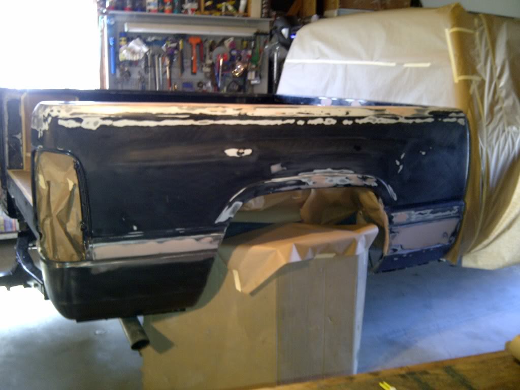

Before washing and masking:left side:
Left side staring today:
Starting to mask:

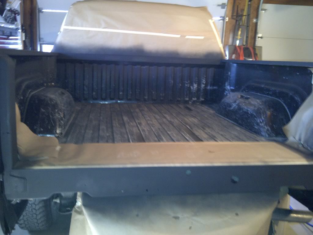

Left side of bed with etching primer:
Rear panel behind bumper and front of bed rail were primed:
Inside of bed will get bedliner applied at some point.
Will spray on 2K primer after the etching primer cures out – hopefully this afternoon! Feels good to finally make some progress again!

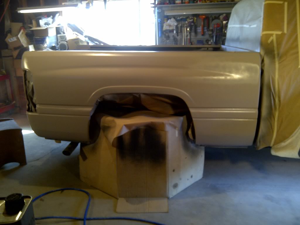

First coat of 2K primer.......

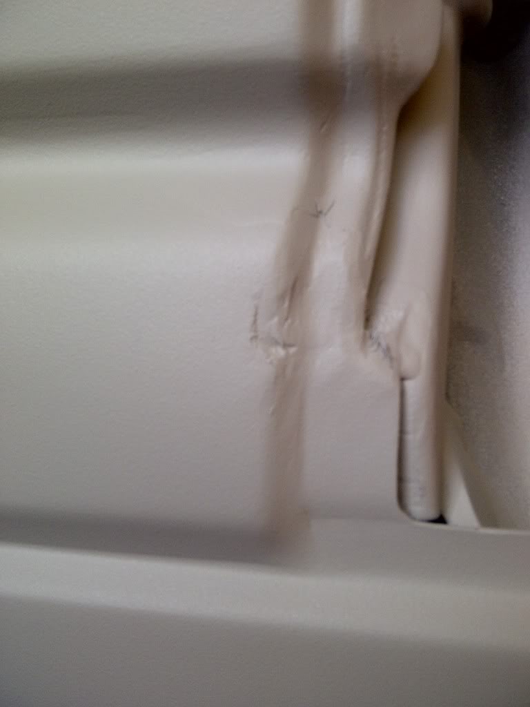

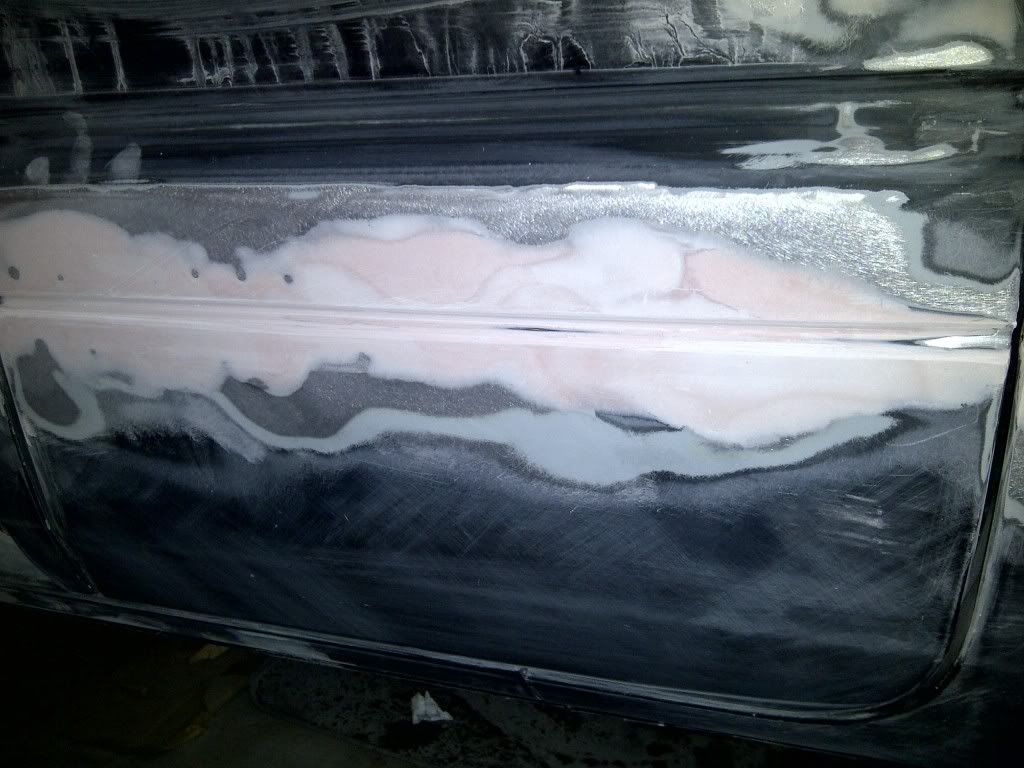

After 2 coats of primer, I noticed a little "Oh Crap!"
Can I lightly sand and fill this or do I need to take it down to metal? That is at tail light and welded seam.
