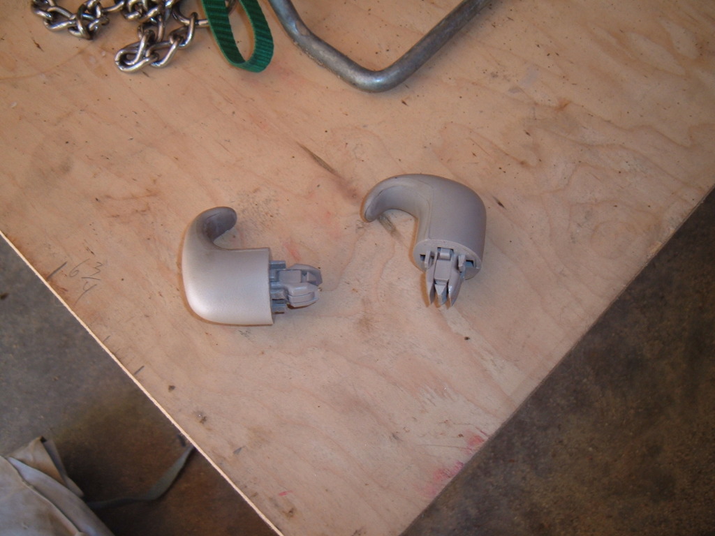

Looking good GD. BTW, if you need any coat hooks,let me know.
Damn. I did not see those in the items you had posted. Just picked up a pair from dealer on Thursday for WAY too much!
If anyone needs one (only one) for a 2003 and up, I have one new oner I bought on e-bay. Newer model requires larger square hole.

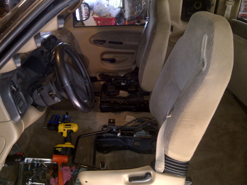

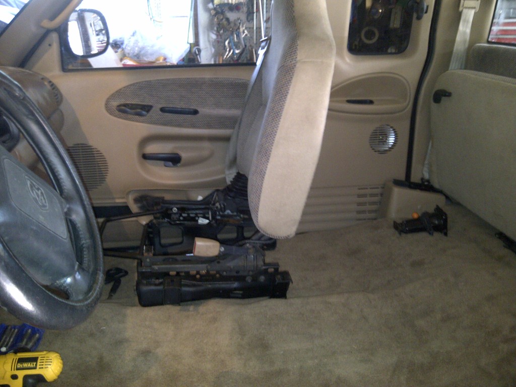

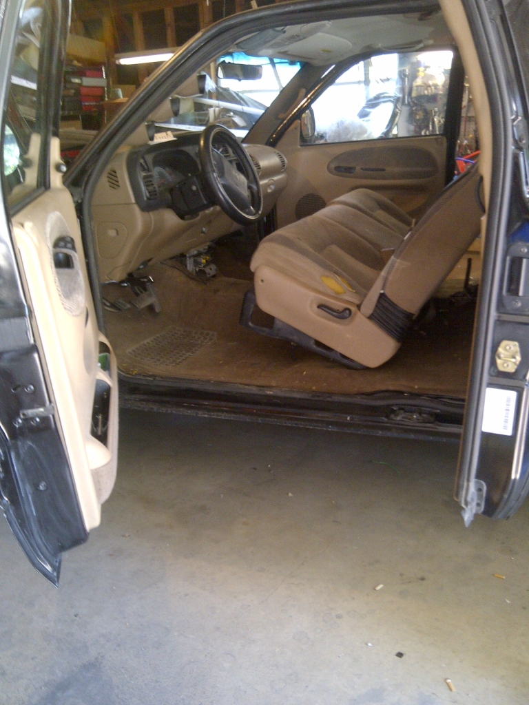

Back to work on the interior. New carpet came in this week, so removing seats was first up:

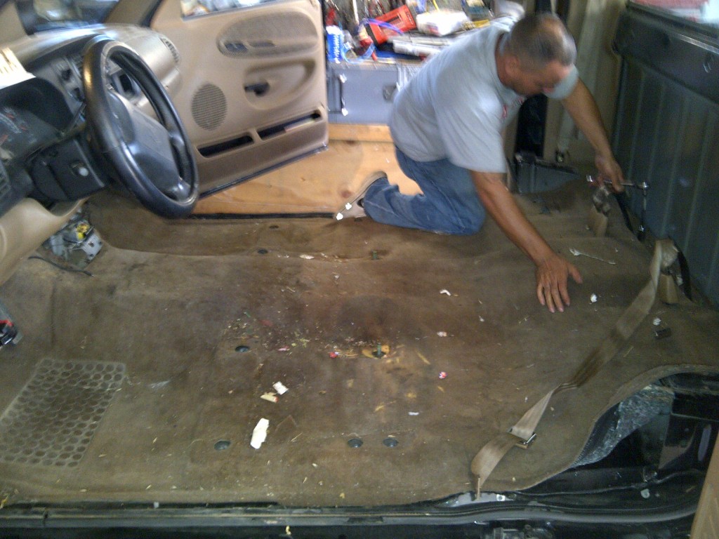

Now to rip out the stained and worn carpet:

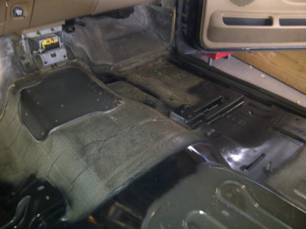

Carpet removed…and a little surprise….

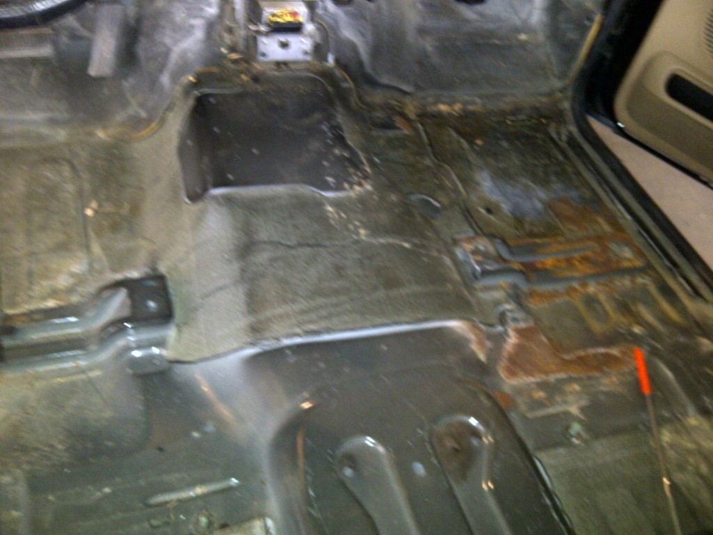

And nothing like discovering rust under the carpet……I hate rust:

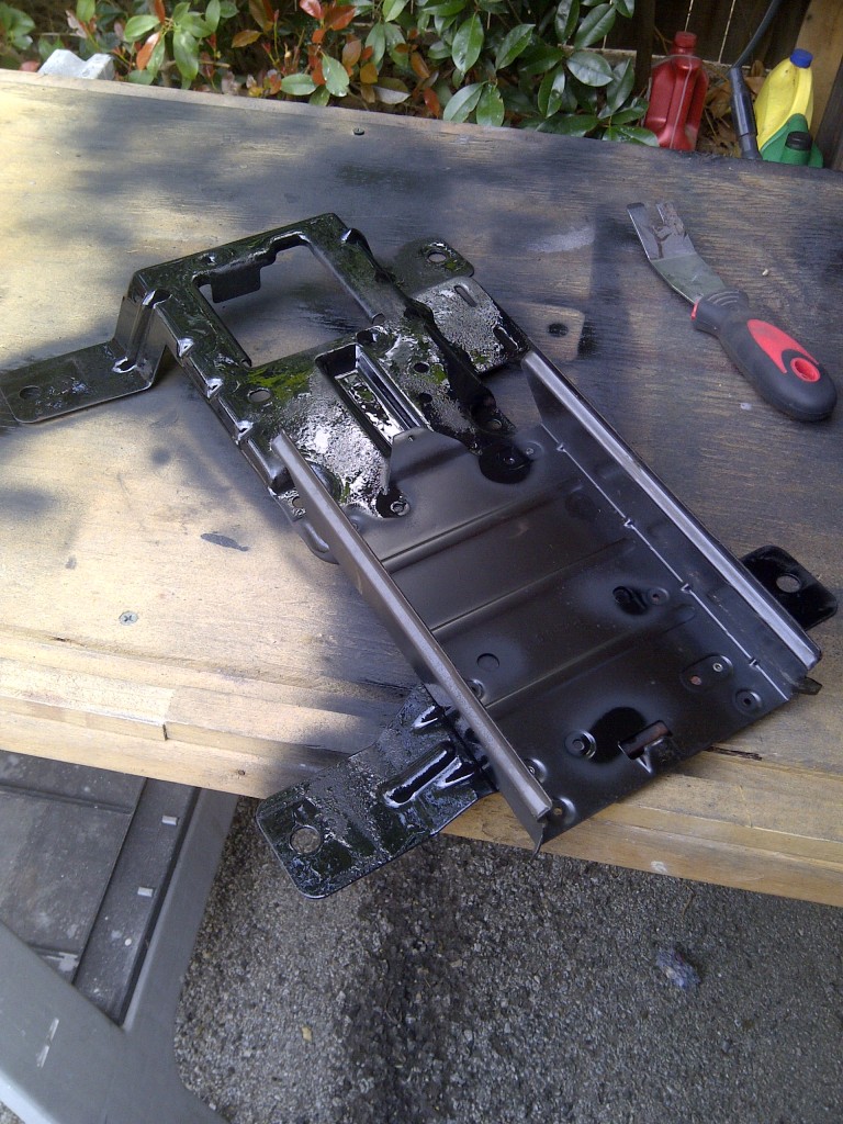

More rust in the seat brace on floor. Using a rolo loc disk to remove rust:

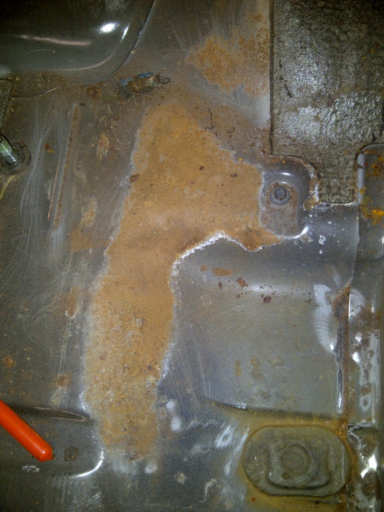

After sanding rust off, I sprayed with Rustoleum rust restorer:

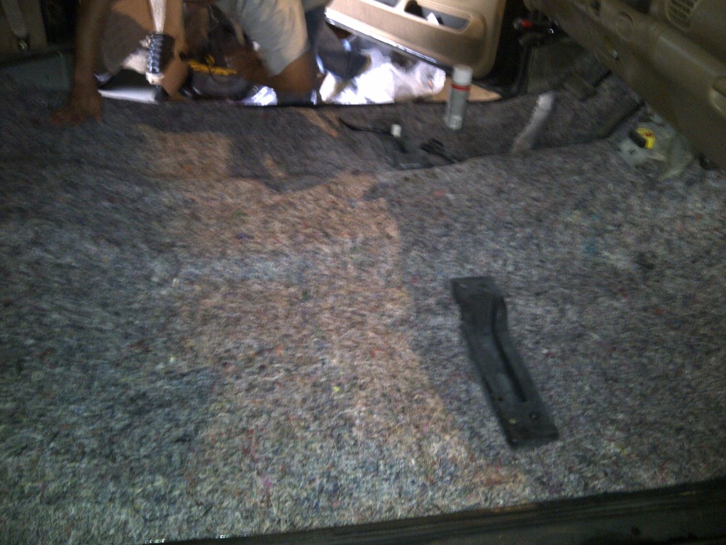

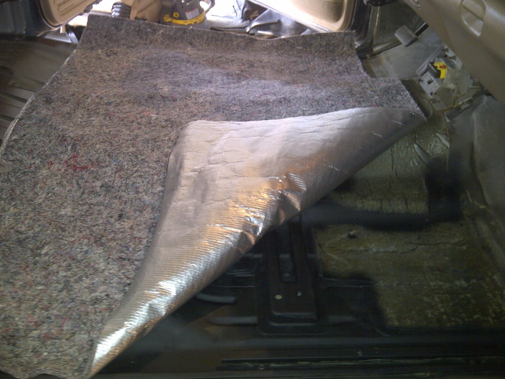

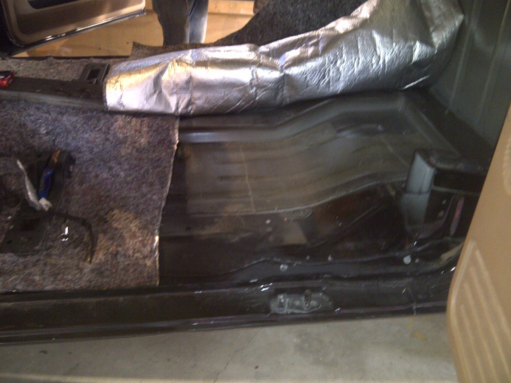

Installation of sound and heat deadening mat I purchased from LMC:

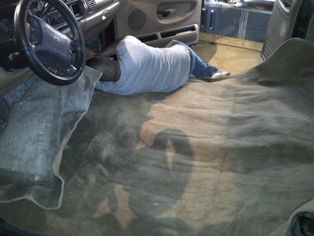

And now to lay and trim the molded carpet. Brother in law – not very smart. He came over to get me to fix the AC in his car….and I put him to WORK!

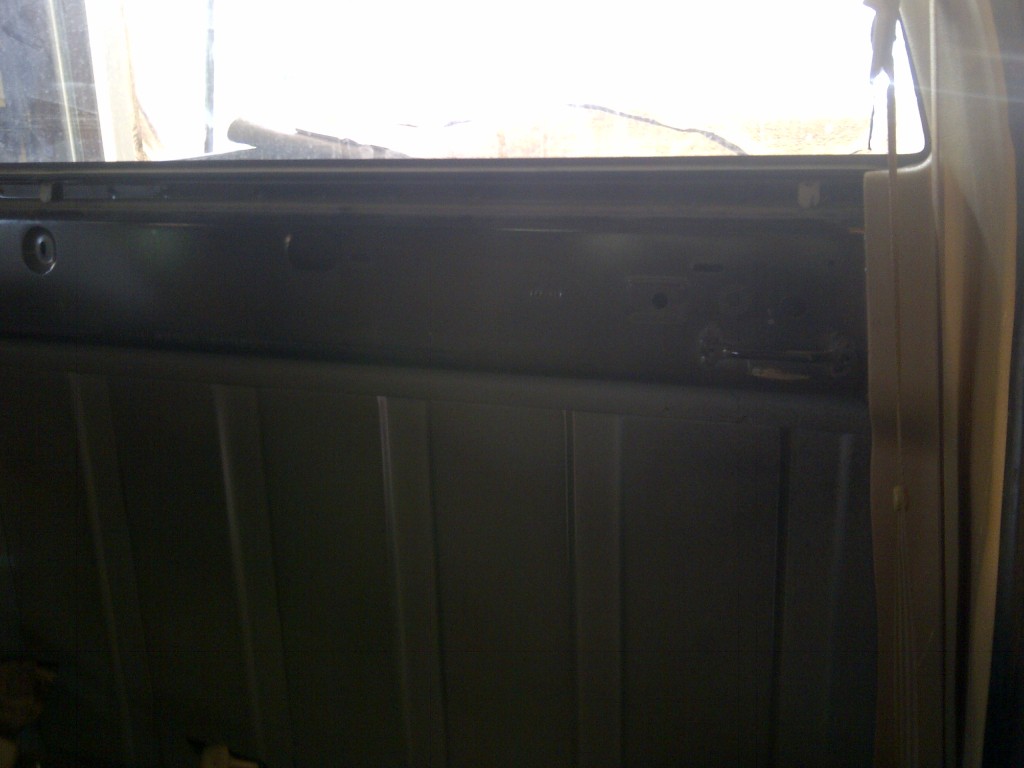

So for some reason, Dodge left the area behind the rear seat primer gray…..It will be metallic black tomorrow…..

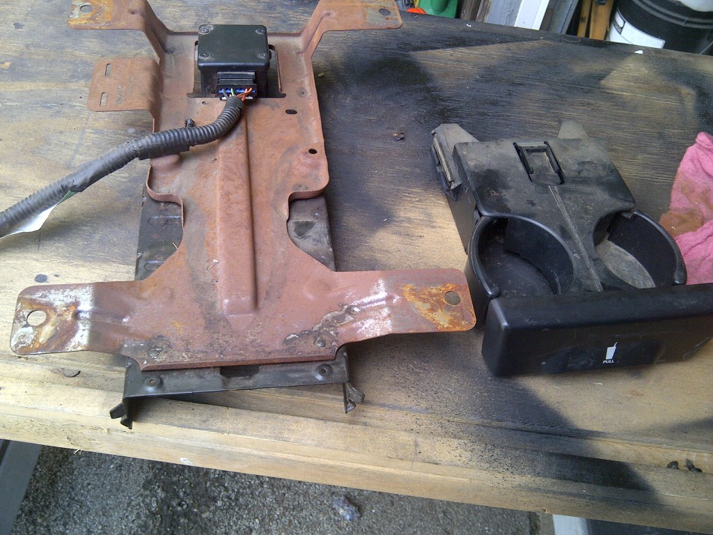

Rear cupholder rusted bracket:
Rust converter on bracket:

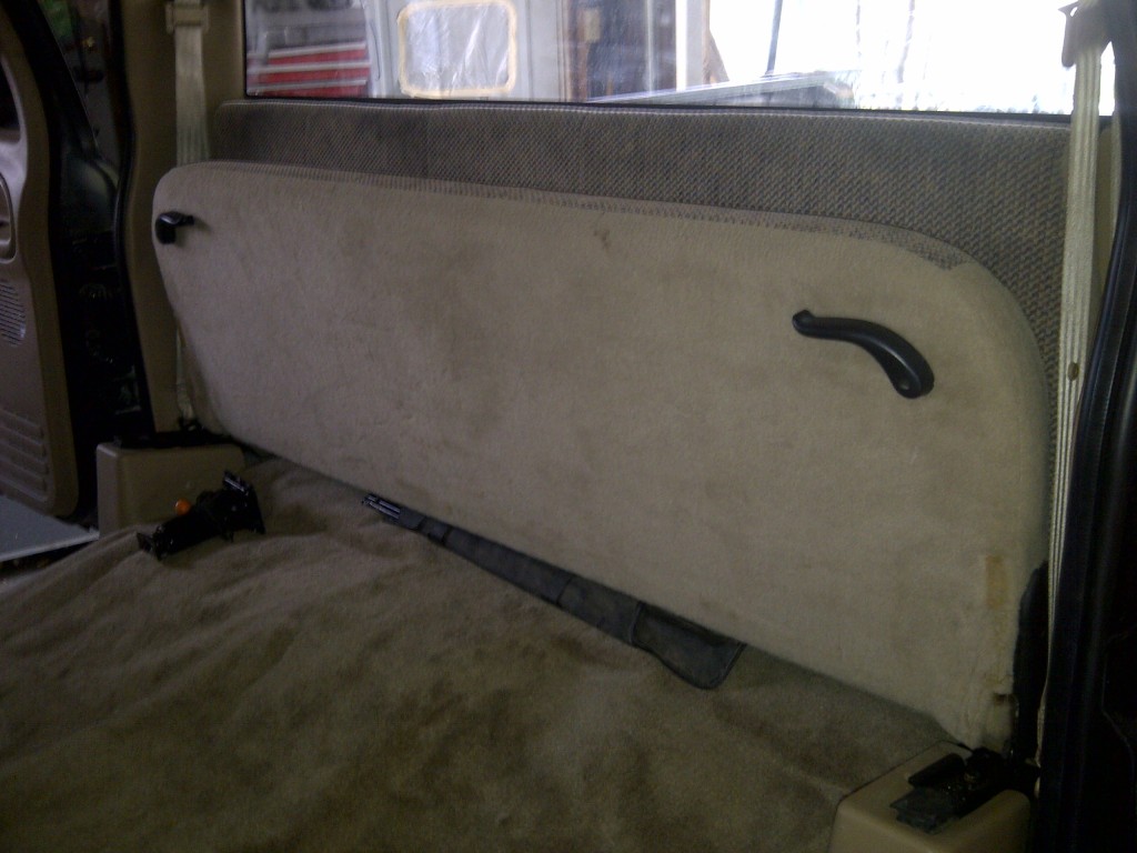

Rear seat installed:

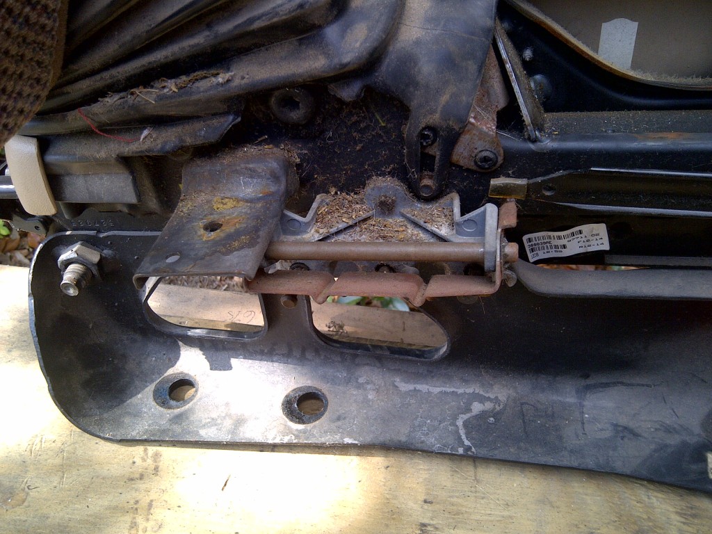

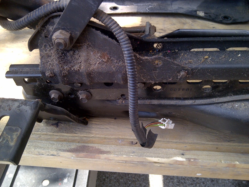

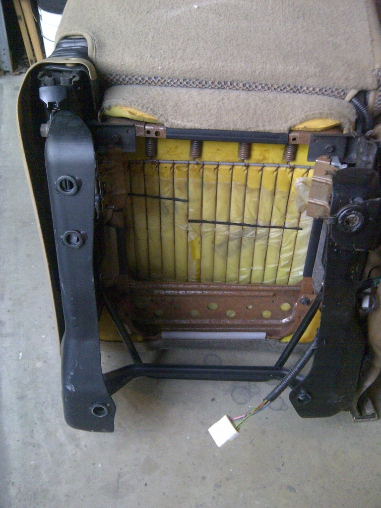

Front seat frame – I don't know how someone can let a truck get that dirty.
More dirt and that blasted rust (before converter):

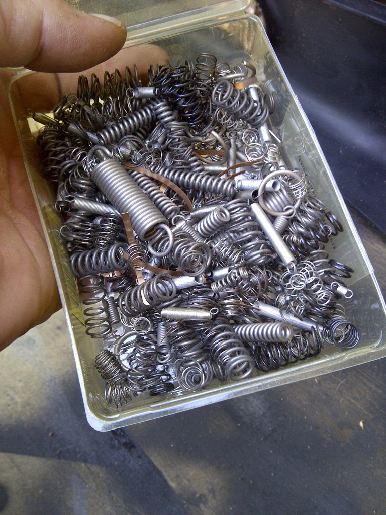

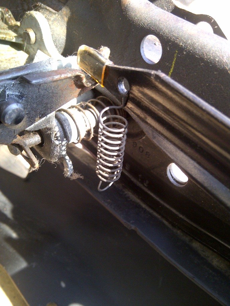

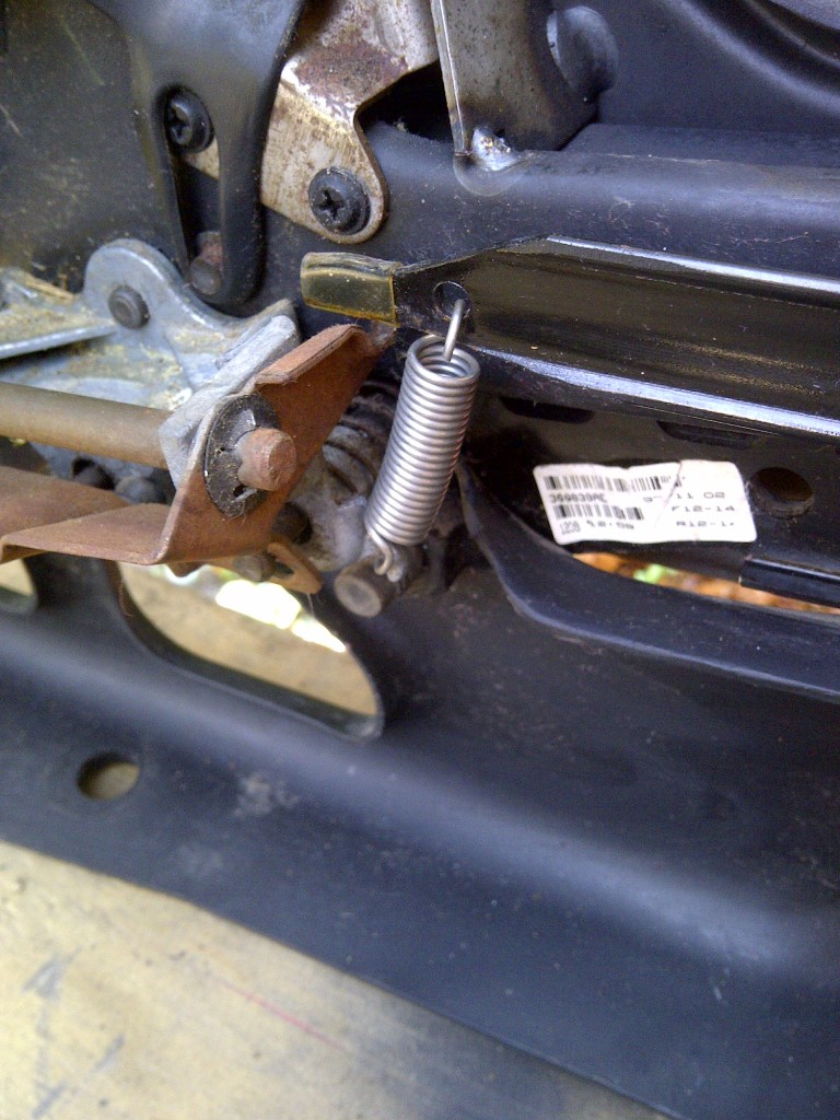

Spring for seat adjuster is sprung….
Looking for replacement for sprung spring:
Replacement spring for seat adjuster:
