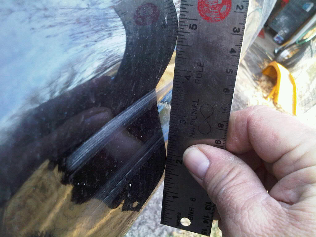

Well, back to the Ram. I discovered 3M Trizact Clear Coat sanding discs (1500) while in Austin. Tried it out on some slight orange peel on the scrap hood where I had already sanded and buffed. Then I buffed again. What a difference. I was hesitant previously to sand further as I was afraid to burn through the clear. This was not a problem, and the clear on the scrap hood is not as heavy as what I put on the Ram. So I started resanding with a wet orbital sander to get it looking even better. I hate to compromise and some of ther areas would probably not be noticeable to anyone else – but I would probably notice every time I walked up to the truck.
Here is a photo of the scrap hood looking down on it. You can see the reflection of the tree on the fight hand side with no sign of orange peel distorting the image. Keep in mind that the reflection you are seeing is on a BLACK hood! The dark in the image at the top of the photo is the underside of the eave of the garage. At the top and the lower left hand corner you can see some of the orange peel where I did not resand.

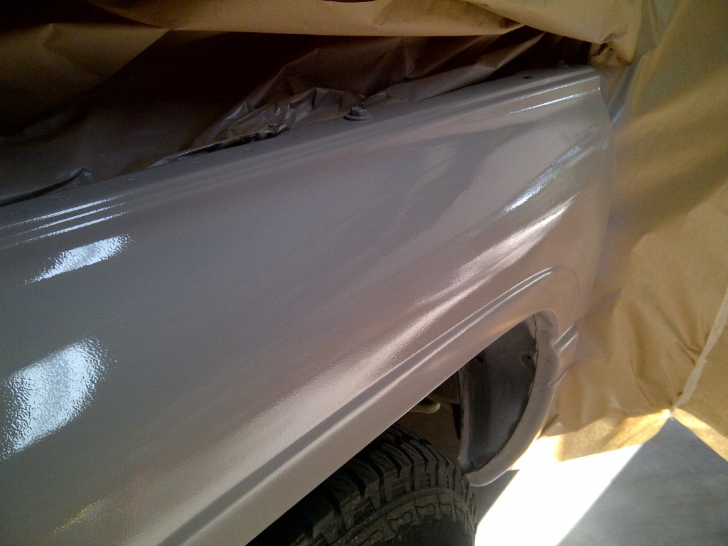

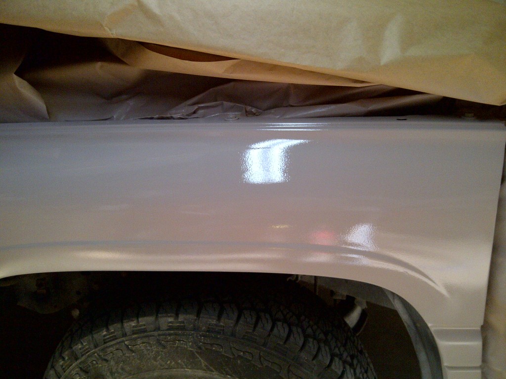

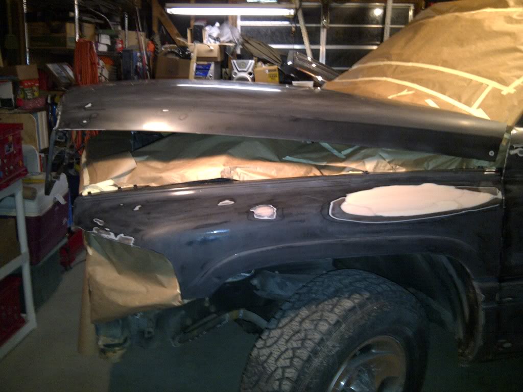

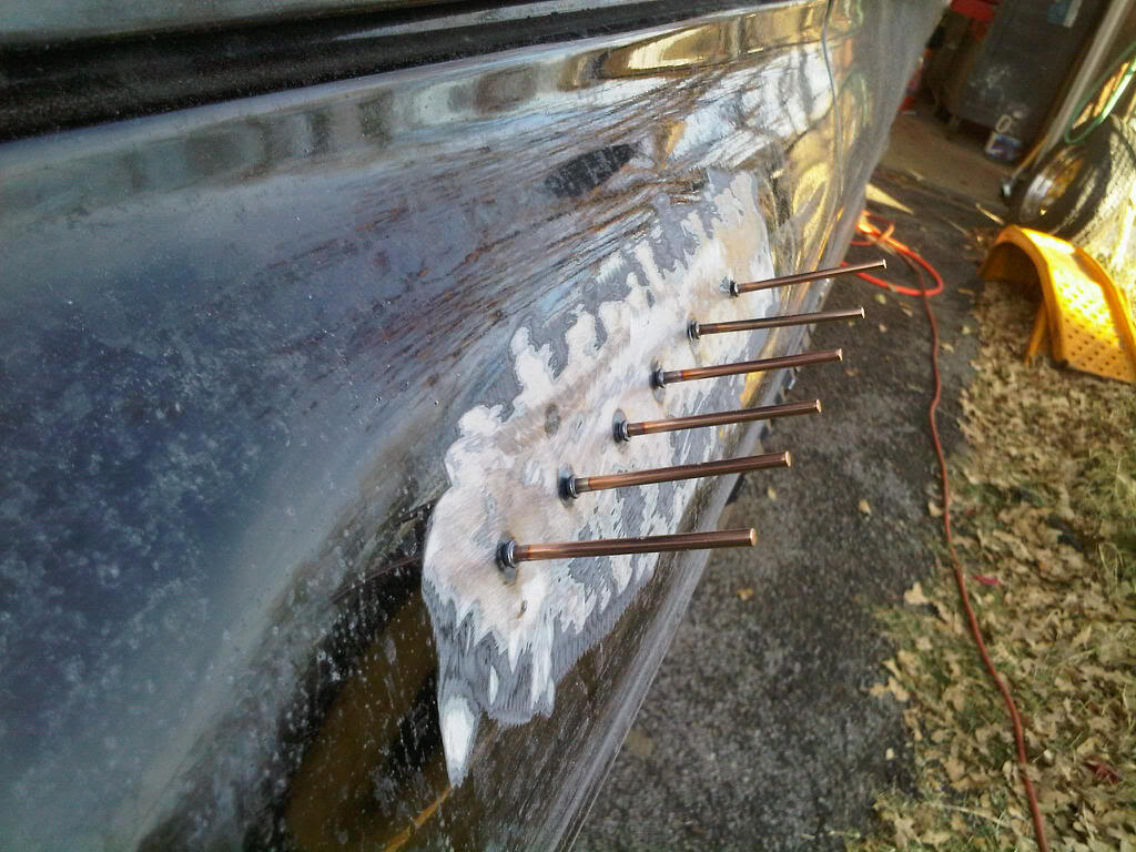

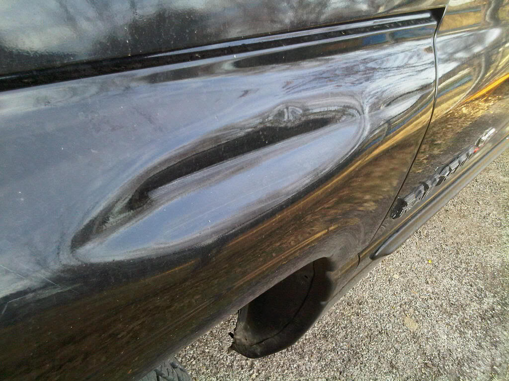

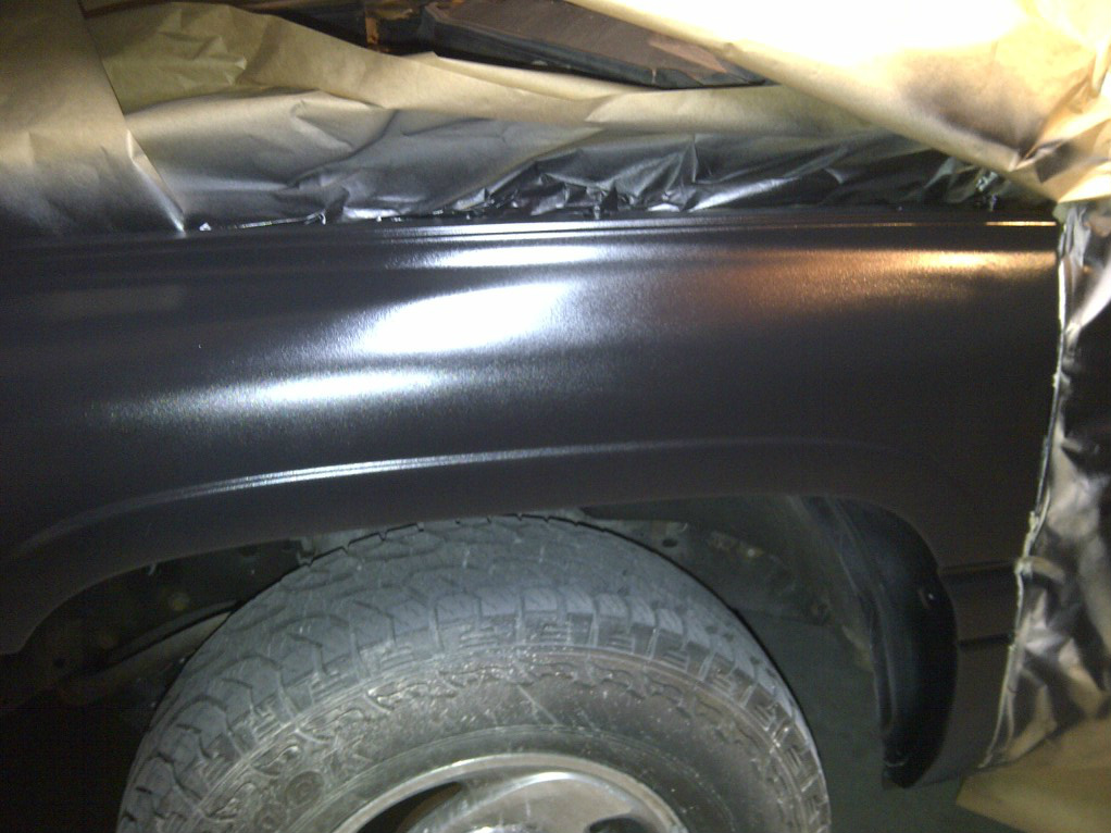

Finally got to start back to work on Ram today. I think I got the left fender like I want it so I primed it this afternoon. Will check again after primer dries.
Here are some photos beginning from the shot of the original dent to pulling and filling dent to primer today.
