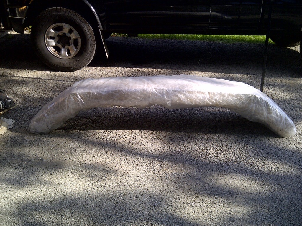

So while sitting in my office trying to get some work done...I get an e-mail that a 2 pound package was delivered to the house.......
More than 2 pounds, but no appearant signs of damage (unlike the last time....)

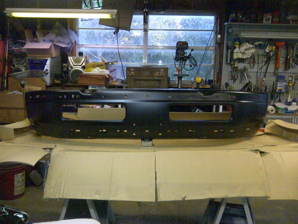

Opened it up and WHooHoo! No damage!
Sanded the primer on the outside part. Compressor is on its way out. Wouldn't keep up sanding. Time to start looking for another compressor.....
So I am sanding the primer on the outside. Do I need to sand the inside as well or would scuffing with green scotch brite work OK?
I plan to shoot with an self etch primer with adhesion promoter before base coat. I assume I do not need to use the 2K primer - or do I?
Old Jun 19, 2012 | 10:27 PM
  #508
Posts: 87,482
Its a bumper, anything you can do to it to promote paint sticking to it, and STAYING stuck to it, is a good idea.
Old Jun 19, 2012 | 10:32 PM
  #509
kejobe's Avatar
kejobe
Joined: Aug 2010
Posts: 2,241
Likes: 12
From: Ohio
Scuffing it will be fine.
Ive always just used a sealer. But it wouldnt hurt to hit a good coat of 2k though. Just dont need to go as heavy as on the truck. Just enough for good coverage.
P.S.- Try not to break through the e-coat.
Old Jun 19, 2012 | 11:18 PM
  #510
Wombat Ranger's Avatar
Wombat Ranger
Joined: Sep 2011
Posts: 5,672
From: Wild West
Bumper's looking nice... Hooray for damage free shipping!
