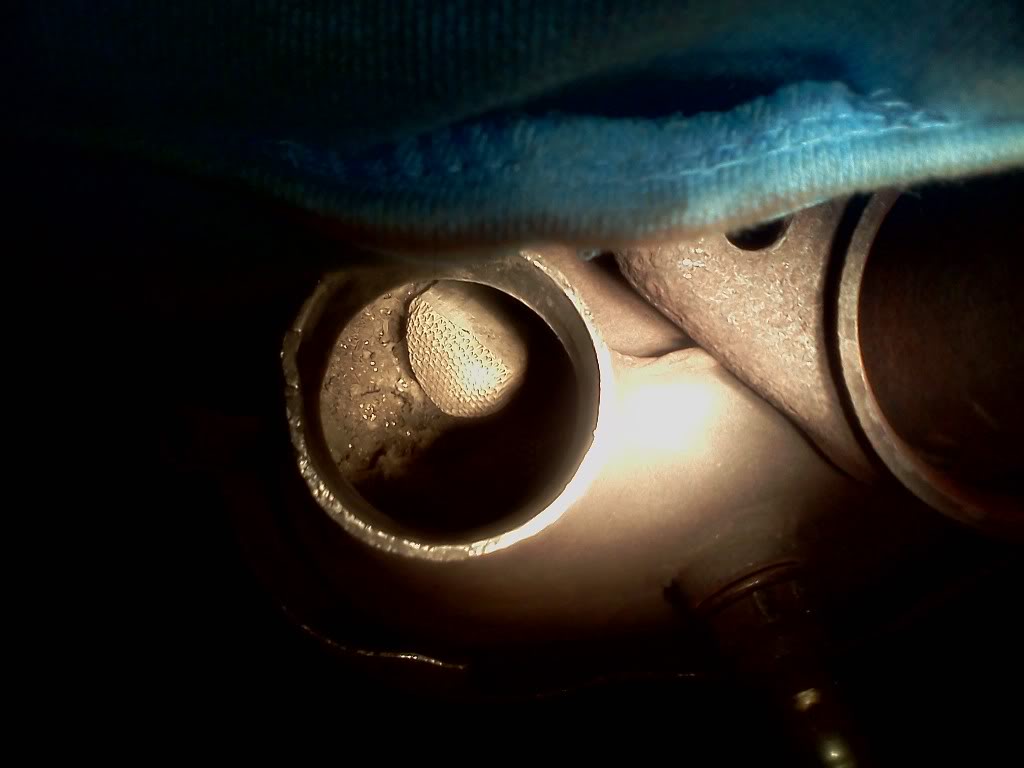

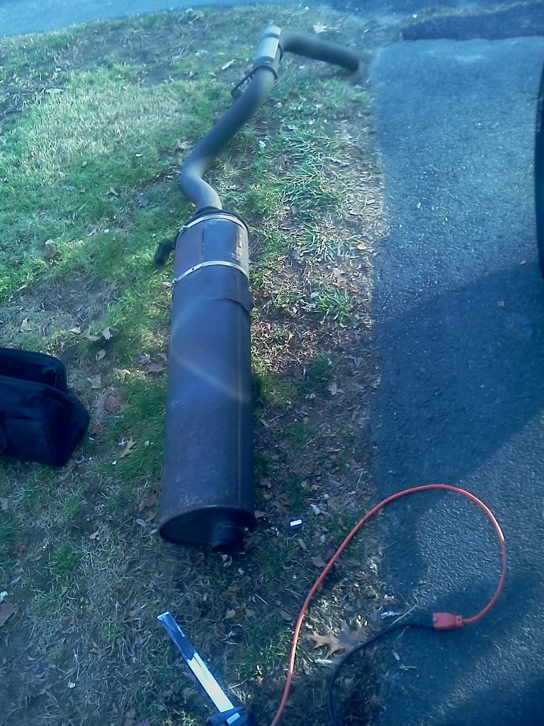

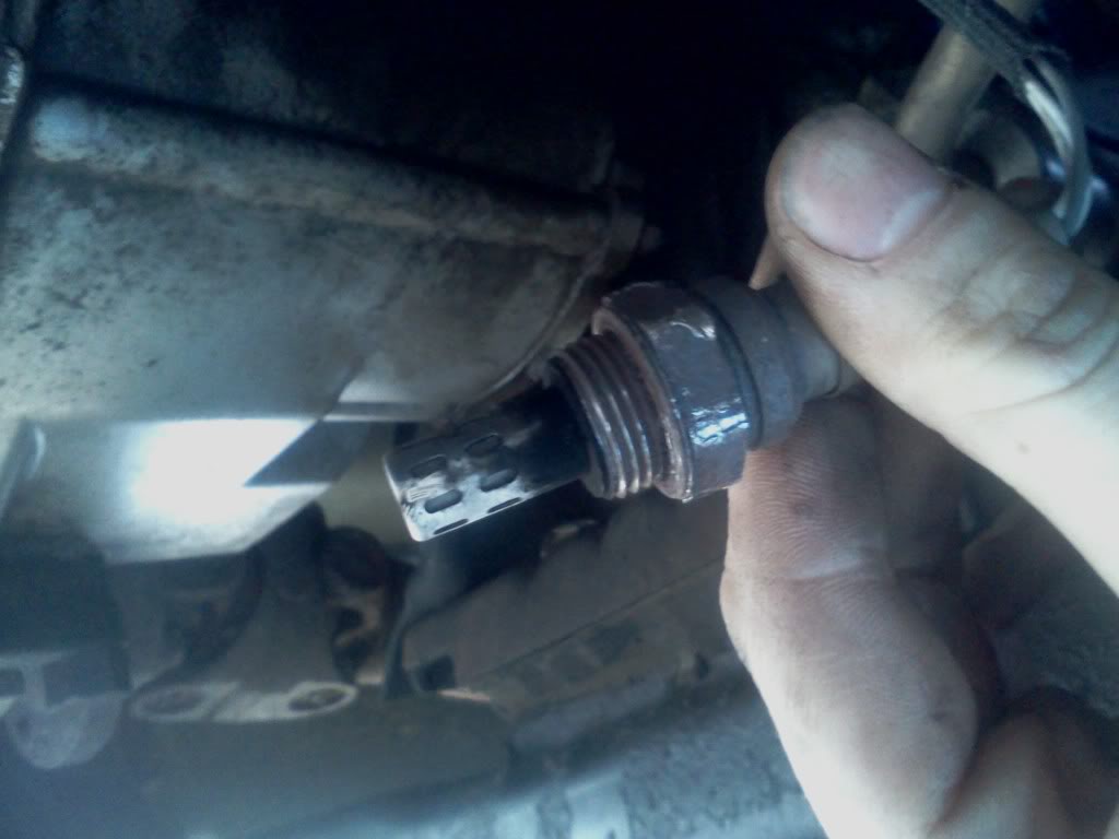

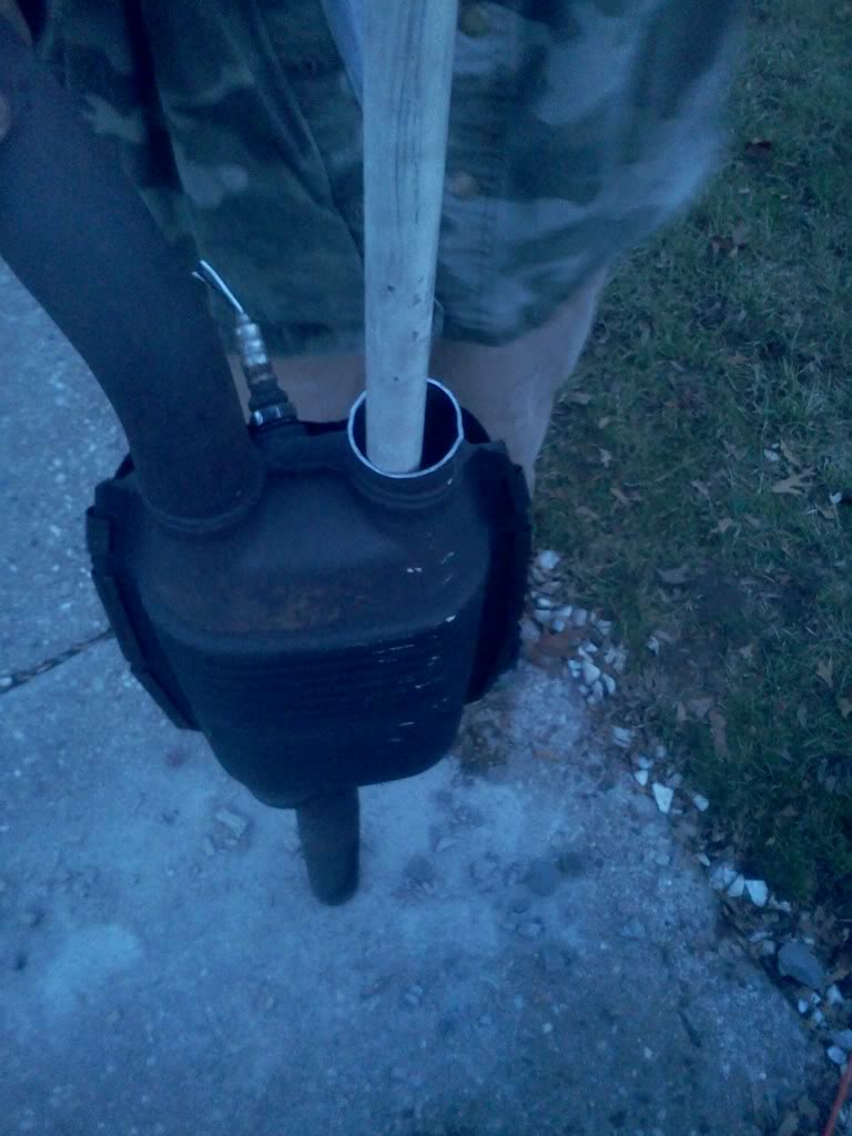

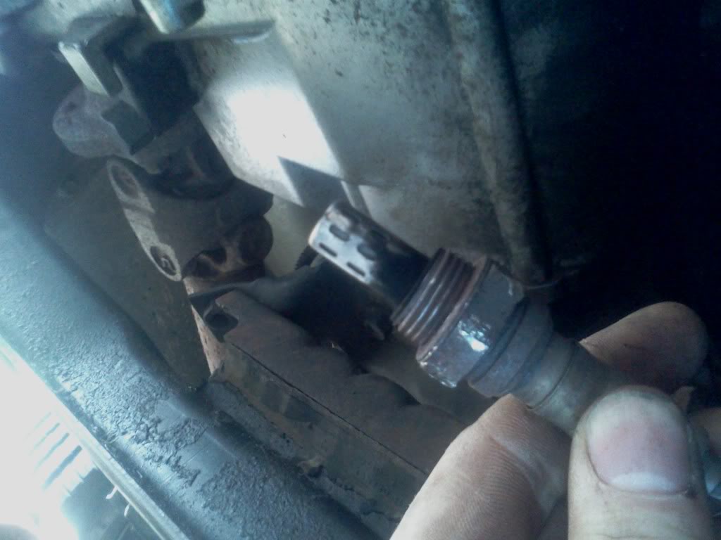

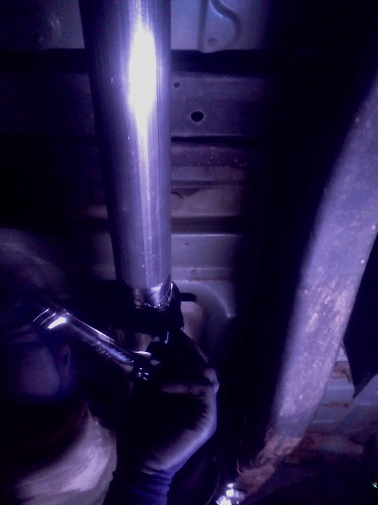

i bought my truck about three months ago im trying to get caught up on alot of past due maintenance. just did a leaking timing chain gasket now temp. fixing a clogged cat due to what probly a blown plenum that needs to get done next. so i unbolted the passenger side of the pipe that goes from cat to engine. coudnt get the driver side. (rusted on) so i Sawzawed it in front of the cat. than seperated the muffler from the cat and pulled the cat off. i took a pc of copper pipe and a hammer and whent to work. i also took the muffler off. (the muffler had a whole that i put a 8x15 in 22 gauge heat shield from home depot, linked up two plumber pipe clamps (with the screws) and wrapped it around the muffler and 22 gauge heat shield i did that rig up a couple months back cost me about 8 bucks) vs a new muffler. any way i dropped the muffler and tail pipe and straight piped the tail pipe to the gutted cat. and hung it back up.

here this last one is a vid... (im the first person speaking) the other guy is a buddy of mine who has all the cool tools i.e sawzaw and grinder we did the job with ( for whats its worth I dont like the sound of it)

I'm not eager to spend $200 on a cat and $150 in labor to have it installed but I don't want to make a bad situation worse by not having enough back pressure to allow the truck to run right. BTW, my 02 sensor was way dirtier than yours.
A new catc isn't 200 bucks, so do the labor yrself and the fact ur O2 sensor was dirty means what?
