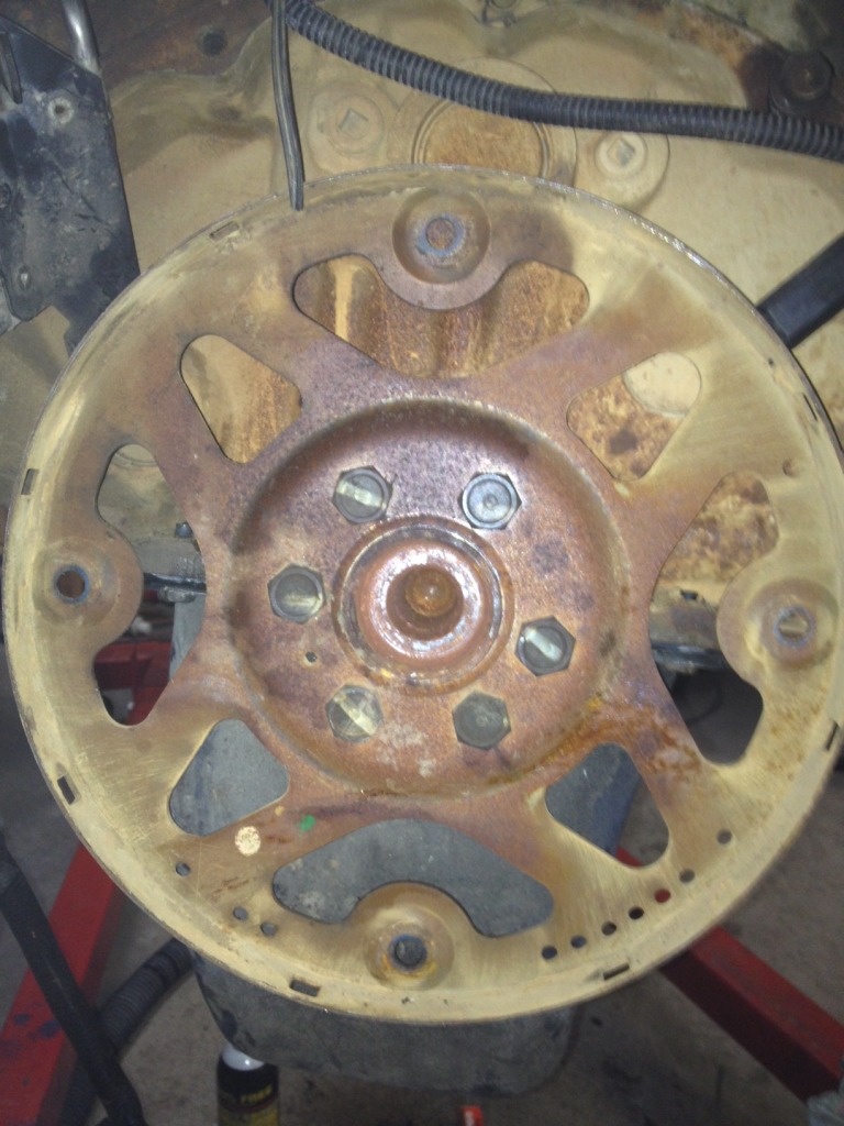

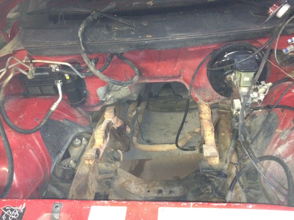

So i was sick on sunday and monday so i didnt get much done. Here are some pics and status update.

Just waiting on a motor!!!!!

ohhh wait there it is......

I went ahead and replaced all the intake manifold gaskets.
So I now have a couple of problems. One of the exhaust manifold bolts snapped on me. And I found that the previous owner of this motor snapped off 2 tranny bolts in the block. So once i get a easy out ill be pulling those out and bolting the tranny up.
Earlier someone said i had to use the '94 flexplate and torque converter, but i compared the two together and the look identical, except for some holes drilled in one that looks like it was for balancing.
2001 Flexplate
1994 Flexplate

Use the plate that came off your motor, if you are bolting it to the same trans.

well the motor is a 2001 and the tranny is a 1994. So ill just swap them to be sure. I didnt locate a plug there that fits the oil pressure sensor. I guess i will have to check my harness routing.
