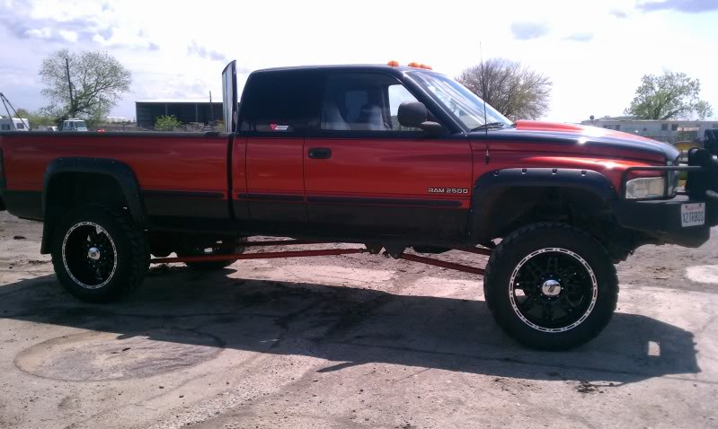

thoes wont work for the rams....if ya got acess to the tools, you can build some custom ones very easy, just need 4 himes or bushings and build ya a couple mounts... for the axle, i built a plate to bolt to the bottom of the axle u-bolts and made my bar mount there, and for the frame i just made some simple weld on brackets, but with a bit more time, some bolt on brackets could be made very easy, cost me about $50 in parts, and about 3hrs time for mine
