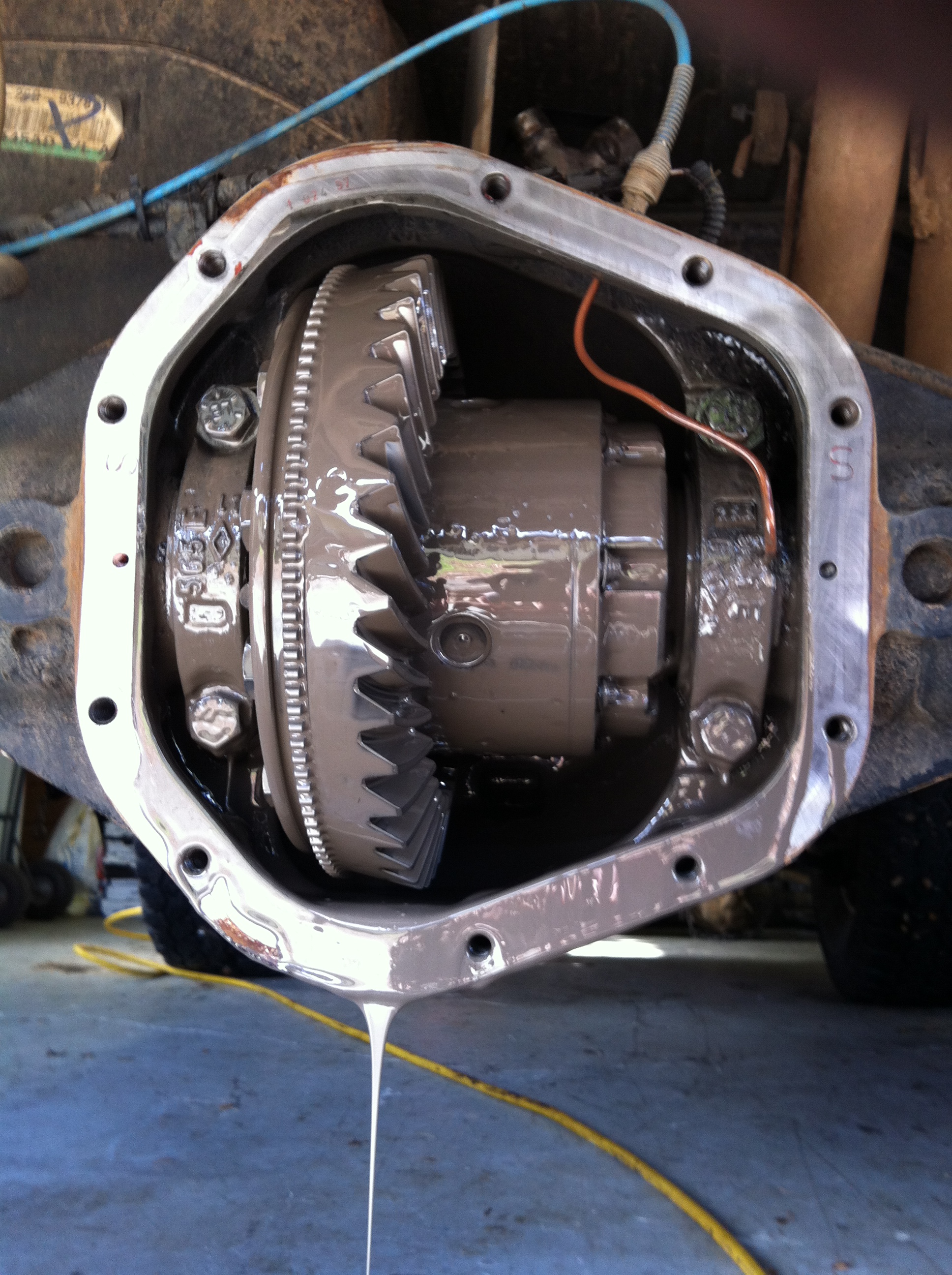

It's really not that bad of an issue. Couple things to deal with is try to ensure your vent lines are intact as possible. Like fit on the differential fitting and tight as can be. The diff cover seal, typically RTV, is in decent condition.
This still will not guarantee water from entering. It can still get past axle tube seals. If you run at high speed then you can get the diff temperature up hot enough that will actually suck water in through the diff cover seal.
So what to do? After a healthy submerging, get some gear oil (which is not that expensive), pull the diff covers to empty out and replace everything. Done.

my limited experience has been this:
with front axle seals that were leaking oil out, they allowed water to leak in, and i had some water inside my front diff.
with new front axle seals that don't leak oil out, they also held the water out, and i had no water in the diff.
in both examples, we're talking about a brief creek crossing with water up to about the bottom of the bumper. we're NOT talking about sitting there stuck for several hours, nor grinding the axles through abrasive sand or mud while stuck...
my advice is that if you drive through water deep enough to enter a seal or vent or dipstick or opening of any kind - then its your responsibility to check the fluids for water. this means check the oil on the dipstick, drain/refill the diffs since there is no dipstick to check, and most importantly and expensively - check the auto transmission dipstick. but here's the problem - if you find water on your transmission dipstick, it might already be too late to save the trans.
