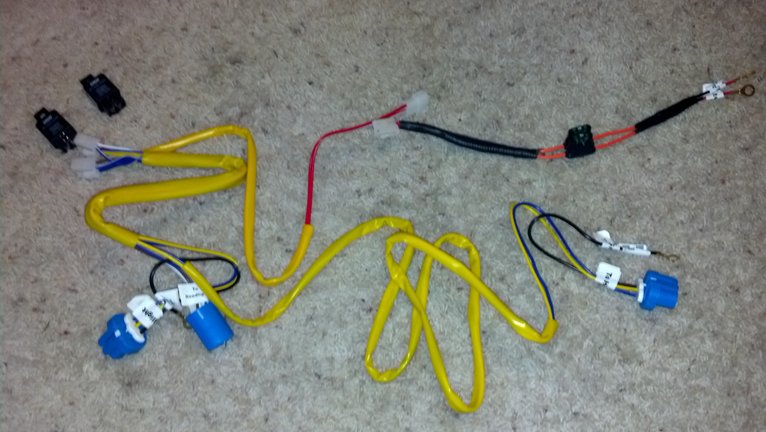

Originally Posted by UnregisteredUser
Other than the difficulty of reaching in to the driver's side headlight, it was a cinch. And no hacking of the factory harness at all -- the kit just plugs into it on the driver's side for relay control.
Oh yeah: The kit comes with some punkass lookin' yellow sleeving more or less but not fully protecting the conductors. I hacked that crap off and replaced it with split flex conduit for better protection.
Got this today and yeah...same yellow sleeving. I'll just keep it on and put the flex over.
Any chance to shoot a picture of where your relays ended up?
I hung 'em on the front of the battery box, and immediately regretted it when I went to put the plug on the driver's side lamp. I haven't messed with it since, but will be moving them one day when the mood takes me. And then I'll regret having empty holes showing where none were supposed to be, but that's another story.
That's where I mounted the relays for my fog lights. I don't regret it.
Mine are low on the tray so the relay bodies are against the battery tray but the connectors hang out in space, and it makes it painful to get at the headlamp plug.

That's how I have mine. I coated all the connectors with liquid electric tape so they are water-tight.
For $30 that appears to be a good ROI.
http://www.lmctruck.com/icatalog/de/full.aspx?Page=61
Thanks
Added the inline fuses to the harness. Added the split loom after this picture.
Before Picture
After Picture
They are brighter.
A real PITA on that driver side fosho
