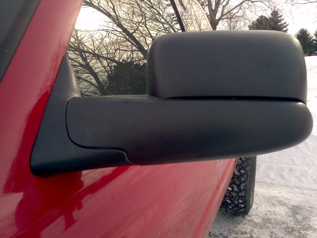

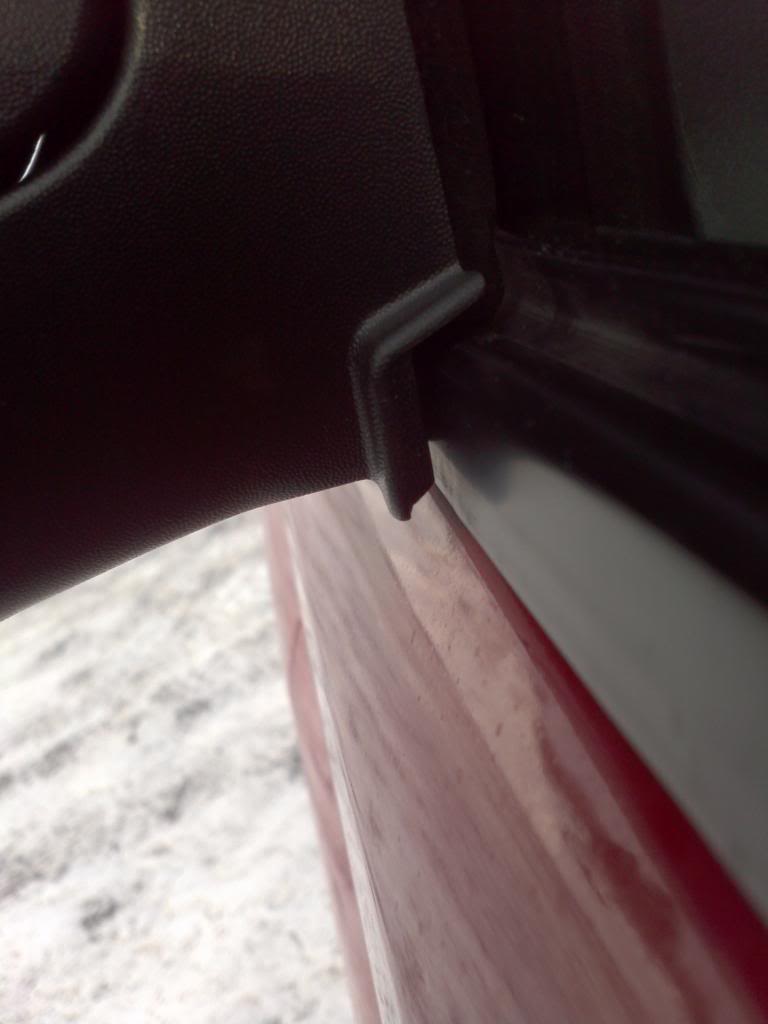

I just finished a tow mirror install on my '97...as far as I know there is only one company producing aftermarket repop tow mirrors, Kool-Vue. I picked up a set of their non-heated power ones. Was pretty disappointed at how they fit, was expecting a lot better. The mirror doesn't exactly flow with the body lines; doesn't look bad but if you are OCD it might bother you. It's not quite "long" enough at the forward-most point, and doesn't dip far enough down. The fit against the outer window trim is also less than satisfactory. Pictures will explain better:
Also had to whip out the grinder and buzz off a retainer and stud for the power wires... it completely interfered with the rubber grommet for the wire that goes into the truck and wouldn't let the mirror come even close to flush.
That being said, I am pleased with how they look at highway (and above....) speeds. Vibration is pretty much nil even when flipped out. Just make sure you are getting the support brackets when installing. If you can get OEM ones for a decent price I'd go with those. These were a dirt cheap alternative for me at $150 for the pair, so I couldn't resist.
